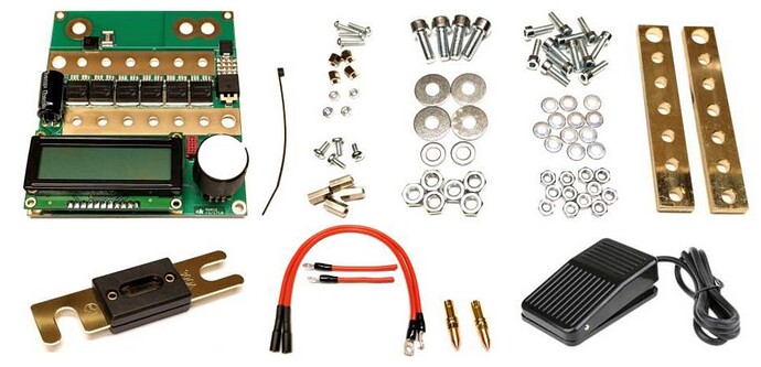

Get a decent spot welder like a kweld.
Or a malectrics
I just got a malectrics, any recommendations on a PSU or batteries for it? I’m thinking a car battery.
Link to aliexpress pleace thx
Ali doesn’t seel Kwelds. What country r u in?
Keenlab.de . Not AliExpress.
Switzerland …
I search cheap dys thing.
@Evwan beat me to it. That’s the link in the EU.
Malectrics promises 2-7 days shipping internationally, can anyone confirm the accuracy of this info?
The KWeld isn’t cheap, but the big difference between a KWeld and a regular spot welder, is that it adjusts the pulse duration each weld to achieve a specified energy output. Most welders just send power for a set amount of time.
The result is that you get much more consistent welds by ensuring each weld gets the same amount of energy delivered to it.
