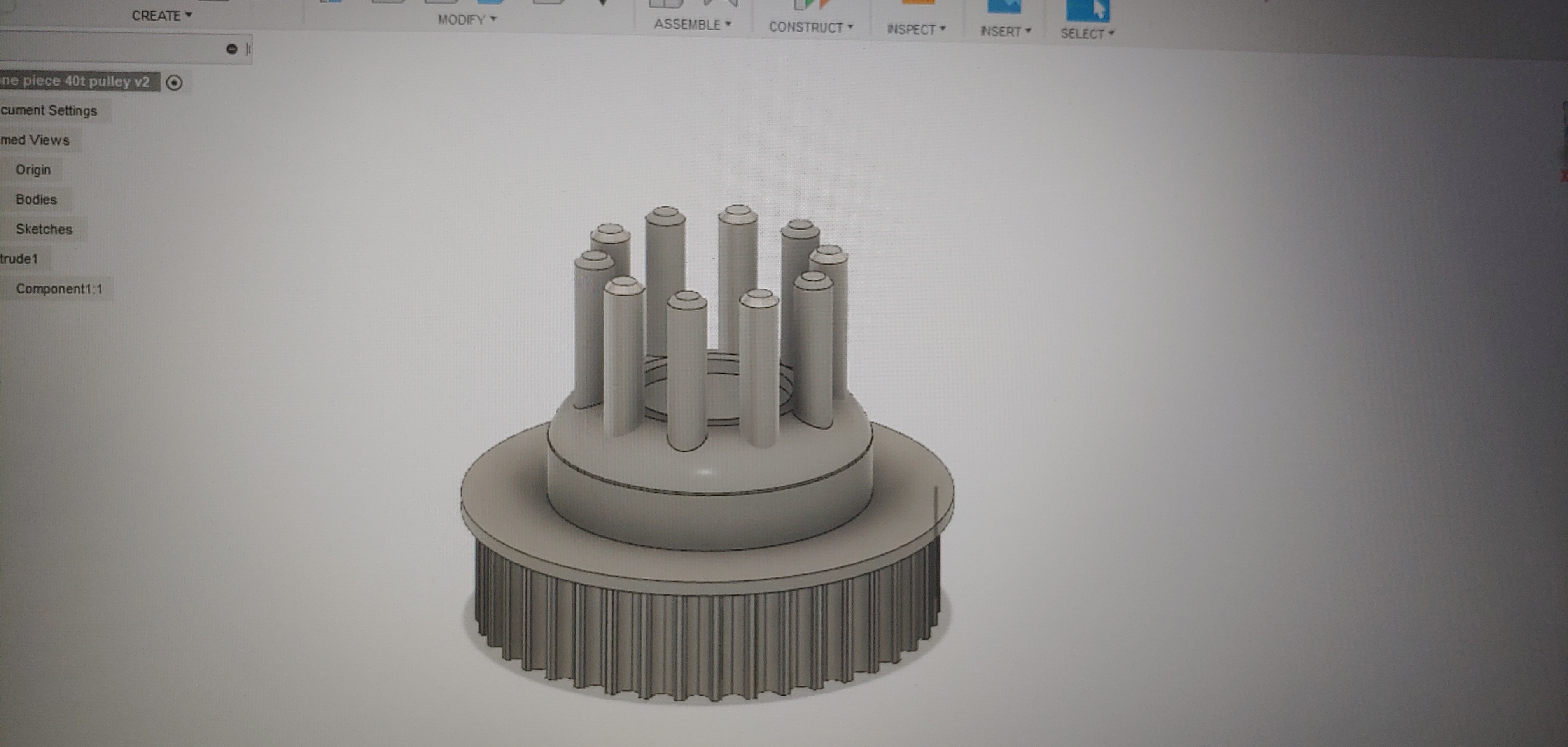

@mishrasubhransu do you have any tips for printing with abs? The biggest issue I’m having is the pins going into the wheel are snapping. You have any idea on how to prevent this?
Can you show me the part ? And the model that you are using?

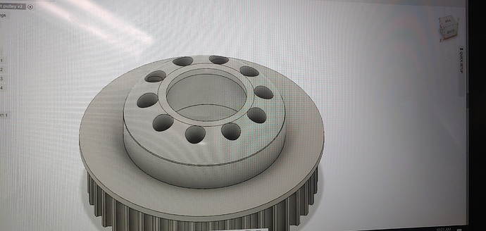

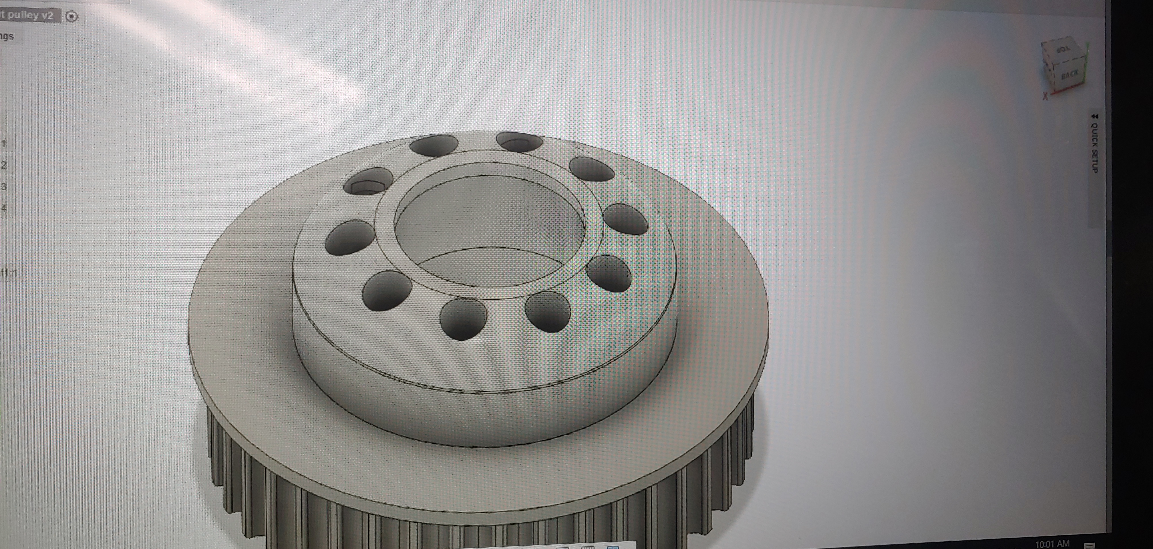

Edit: Found your pulley. Well it will break. Only nylon might be able to sustain those forces on those skinny pegs. What I suggest you do is find dowels from your local hardware store that goes into the kegel holes just right and then modify your design to have holes which tightly hold those dowels in place of 3D printed pins.
Such an awesome build BTW, I somehow had missed this.

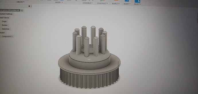

Do you think useing 10 pins instead of 5 will help?
Like this-
Of course. And if you let superglue soak in. That will add to the strength too. But I highly recommend the dowel idea.
@mishrasubhransu how would I secure the dowel to the part? Just press it it?
yes. Pressfit(+superglue maybe). There is no axial force so it’s not going to come out.

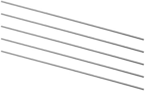

Would this work if cut to size?
I have used those rods in a higher stress application and they haven’t failed on me yet.
Yeah, absolutely.

The design was simple enough-
I’ll prob try this next week.
You can get away with fewer dowels, since it’s steel.
any screws of that diameter?
might be able to try that
M5 should work.
