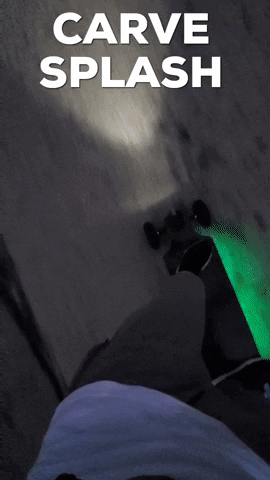

@Scepterr, I do have a few modes that produce a similar effect but the refresh rate of the addressable LED functions I currently have in place are too slow to produce the fluid motion that is shown in the videos you shared. I am working on speeding up the refresh rate now and will post some demo videos once that’s been accomplished. Hopefully I do not need to upgrade the MCU I am using to accomplish this, but we will see.

One of which is the leiftech that I haven’t broken too bad yet, really want to ride it at night. The gyroscope changing lighting is everything I want and more.
There is a perfect mode for that :heart_eyes:
Ooh putting the TTL system on a leiftech / summerboard would be super cool especially when taking advantage of the gyro based modes like you mentioned :smiley: Im just not sure how the control module would be mounted and how it would be powered since the enclosures look like they wouldnt have extra space inside. Any thoughts?
