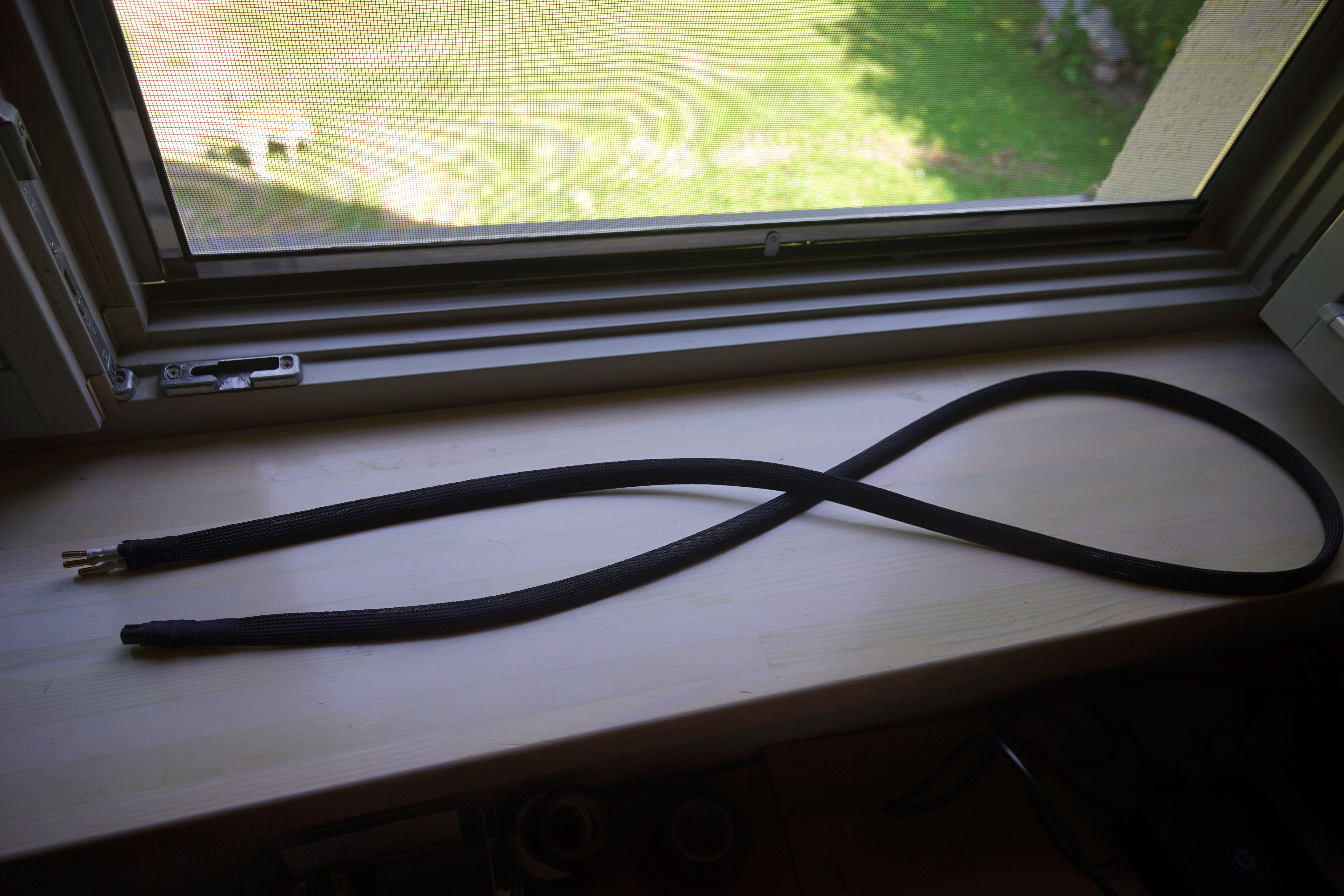

- The lunch box takes up too much space on the deck. Gonna make longer phase wires and hold the electronics in my back-pack instead. Had it fall off the board as I was speeding down the street, that was a bit awkward
(And I don’t want to unstrap this thing every time I jump into a bus or train. The MR-60 connector is perfect for quickly disconnecting imo)
