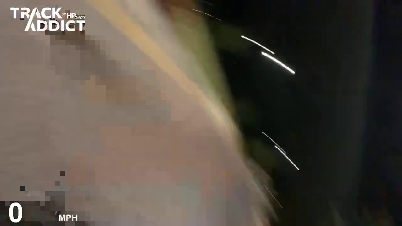

noy my fastest
but it’s stable, have hittttt 42? mph with em no problem
Looks like my friend has gone up to 27 now, and he linked me one of your vids going 43 :eyes: :eyes:
:sweat_smile::crazy_face:
im crazy

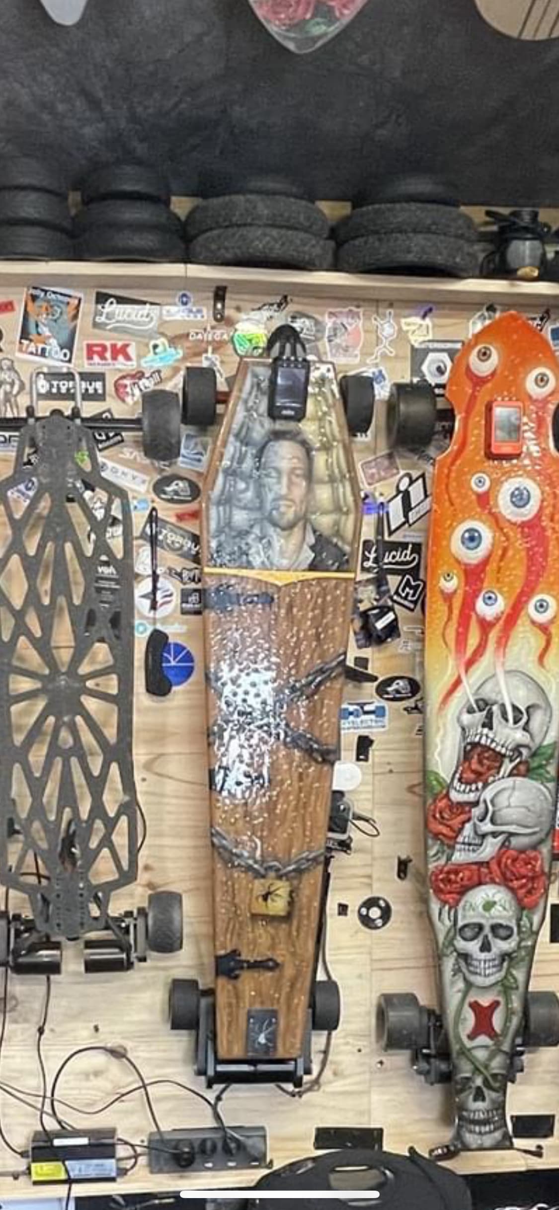

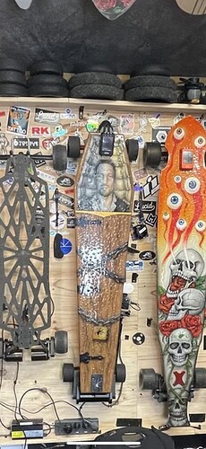

That dude makes some pretty unique boards.
Bro, his latest lacroix is nuts
I want his esk8 budget
