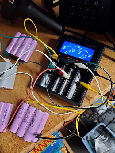

Took forever for the last few parallel packs to charge up, but I got them wrapped up and started soldering em together.
Laid them out next to each other to get a feel for what it would look like in the end
By now I realized that there wasn’t any way that the series wires would fit all together pressed into the Hummie cutout, so gotta flip it over so the smaller side is in the cutout. No big deal really, just not what the original plan was. Another realization that I had was that I’d definitely need fishpaper all the way around the sides of each group of cells to protect them from shorting on other things.
I shoved all the balance leads into the cells just to check all the voltages and make sure that I was gonna set up the balance leads in the correct order. Everything ended up checking out, so from here on, I started soldering them all up.

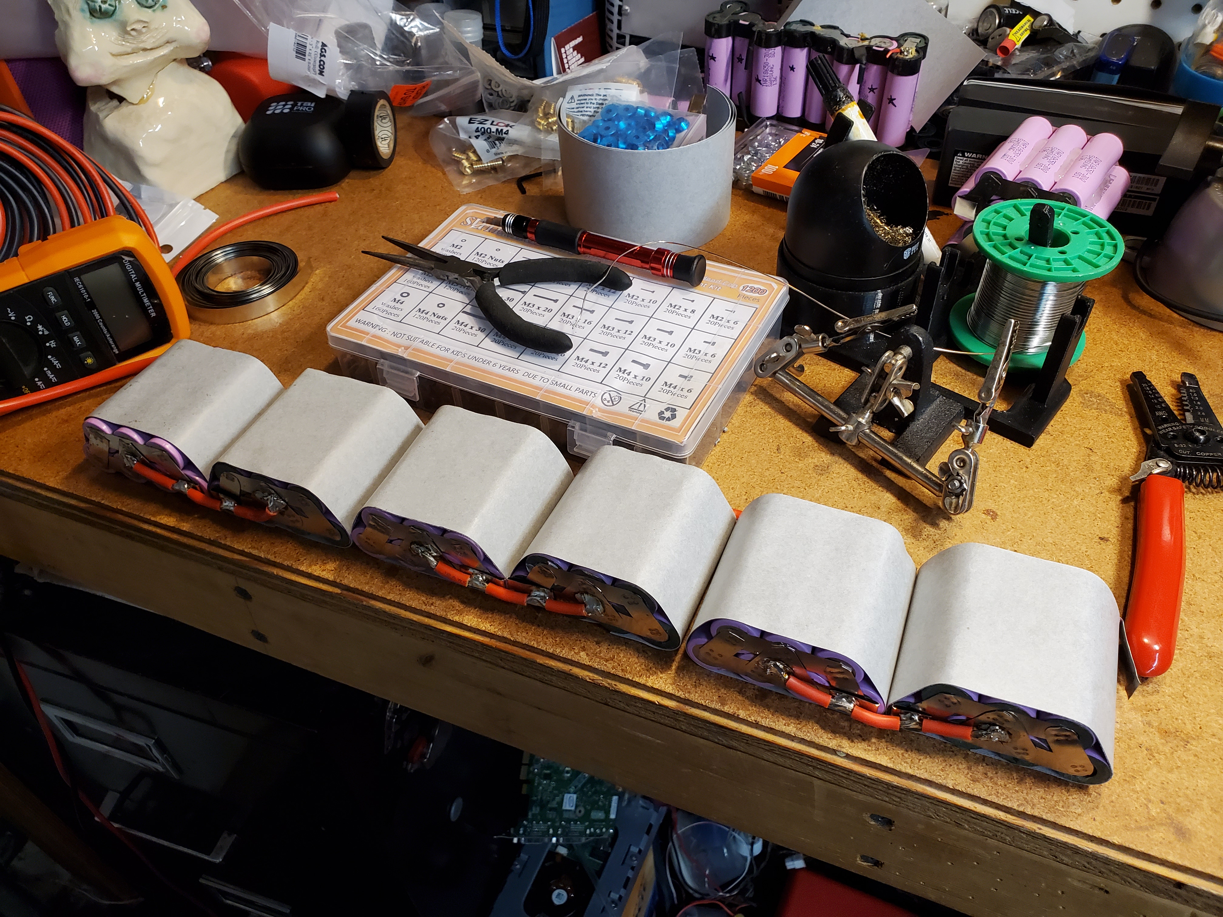

I ended up soldering all of the balance leads on the positive sides of the cells, and added some little fishpaper bits and hot glue to secure each of them.
About halfway through soldering on all the balance wires. I realized I’d have to extend four of them as I was going through but wanted to keep going anyway. Lots of time between the last photo and this one.
At some point between the last photo and the next one, I soldered the series connection between 6 and 7.
Lots more time organizing and extending the necessary wires between last photo and this. Honestly I think it looks pretty good and the balance wires in the middle have a perfect channel to run through.

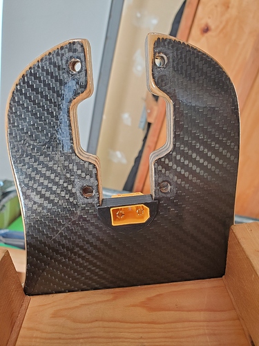

Went on a little CAD journey to make the drop through mount. I originally printed @mmaners’s design but it was gonna be too big, so V1 I printed to fit-check, almost nailed dimensions first try but not quite.
V2 and V3 are basically the same except V3 has the final dimensions (increased hole size like 0.5mm) to fit the connector and hole better.
V3 with a test fit into the hole on the board
I have to say, this does look pretty clean. Next, since it fit alright, it was time to glue it up. I noticed that the connector did get a little bit deformed from the kingpin bolt, but it only got deformed at the bottom so not really a big deal. I used CA glue to affix the connector into the 3D printed part, and then a combination of CA glue and “The Last Glue” to affix the combination into the hole on the board.

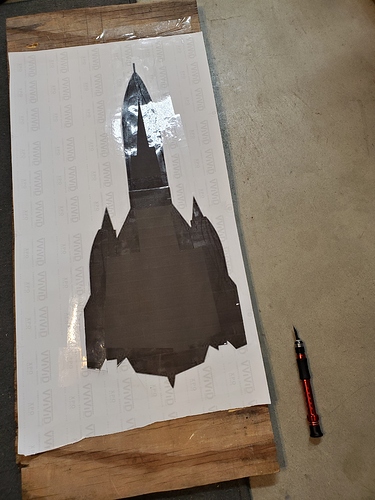

First thing I did tonight was the enclosure skin with the vinyl that I bought - it went pretty well but maybe not as well as I would have hoped. The result is a subtle touch of carbon fiber that you’ve gotta really look at to understand.
I searched for a little while to find an SR-71 graphic, and found a top down silhouette, then threw it into Photoshop on a canvas about the size of my enclosure, then printed it out on two sheets of paper and cut it out.
This photo is the printout taped onto the back of the vinyl, which is taped to a board so I could cut it out with my exacto.
After about 10 minutes of meticulous cutting, I got the design cut out.

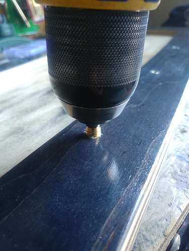

Next thing was installing the threaded inserts, again something I haven’t bothered doing up until this point. Screws through the deck aren’t really an eyesore to me so I’ve just always done that - they can’t fall out or anything either.
I read through most of the threaded inserts thread, and because I didn’t want to mess up my deck, I did a test one. It seems like they’re gonna be decently hard to install but not too bad. I understand now why people were saying the brass ones strip occasionally, I tried installing this one with a big flathead and it kinda skipped off and broke.
In order to prepare for the inserts anyway, I drilled all of the holes through the enclosure and tapped them into the deck so I could then open them up to the 17/64 size required for the inserts. I used a 5/32 bit to do this since I’m using M4 bolts and it’s about the right size for their through-hole installation.
As I was sitting on the ground reading the threaded inserts thread, I found @longhairedboy’s video on installing a threaded insert on instagram with a washer and a regular screw, which is a much better way than using a big flathead. I’ll be using that method to install them tomorrow, however, I also read in that thread that it’s a good idea to use epoxy on the threads to make sure they don’t come loose.
@b264 recommended JBWeld 8265-s original formula so I’m gonna pick up some of that from Home Depot tomorrow along with some M4 setscrews for my motor pulleys if I can find them. If anyone has any other recommendations on threaded insert installation, throw them my way, I’m all ears.
One final shot of the board as it is right now, all of the threaded insert holes are drilled out to 17/64 and ready for installation.
:ok_hand: the LHB method in that video is the way.
The slot in the insert should be downwards into the deck, because it helps cut threads into the timber. With a flathead in the slot like your test would be difficult.
I thought on these that it was a slot for the tool lol
So I was putting it in upside down? I guess that could have been why it was so hard
I think the slot Is supposed to help it cut threads when it is being installed. Shouldn’t be that hard. If you do it with a power drill it’s super easy.
This is how I did mine on my Hummie.
Thx for that, the two nuts is a good idea
Yes it locks it in place and I can see when I get it flush.
Edit : I used no epoxy or glue they are in good.
