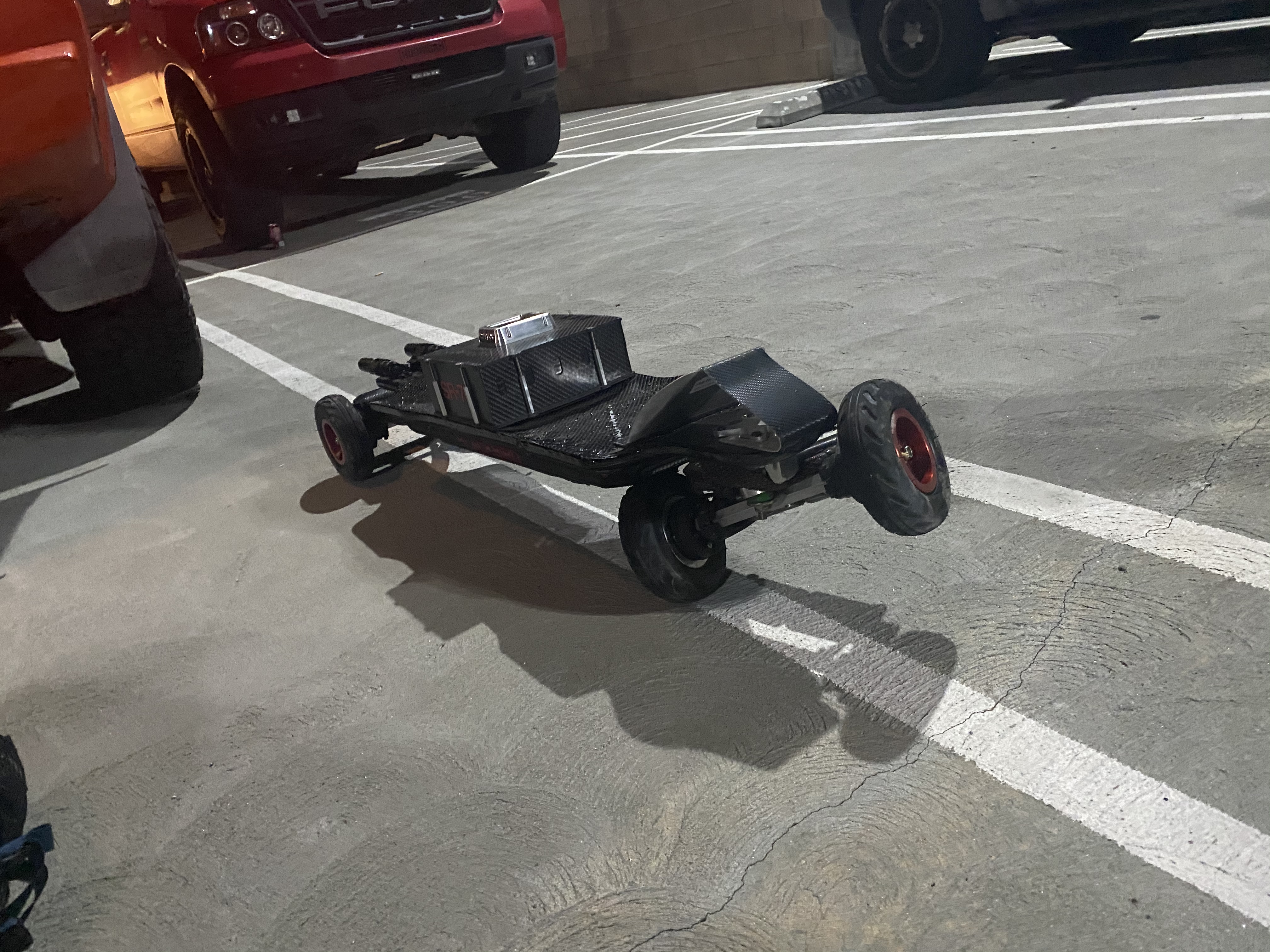

ALLLLlriiiiiight guys this is the penultimate post that yall have been waiting for. Have you? Who knows - anyway this is the final “build phase” post. I’ll hide the last few pics in a drop down so as to not spoil the final product, as the next post below this will have the final build pictures in it.
So we left off in the last post with the skinning of the enclosure, and I will have to say that I probably could do a better job on the front part. It’s not bad bad but some of the wrinkles on the edges are coming up a little more than I’d like. People that have been wrapping for a while probably could do it without that happening, but it’s alright, looks fine to me.
Interestingly enough, a package arrived that I wasn’t expecting (wow that never happens lel). The MakerX heatsink arrived just in time for me to be closing up the enclosure! Thanks @YUTW123 for helping me out and letting me buy the heatsink separately from the ESC.
I was thoroughly impressed with this heatsink. The machining and anodizing look great, and it’s a solid hunk of metal. Since the MakerX retro has 6 fets on each side, it’s got a solid metal upper half and solid metal lower half.
Since the metr pro that I got as part of the group buy won’t arrive until Monday, (and for other reasons) I stuck one of the temperature probes from the BMS on the back of the MakerX so I could monitor the true temperature of it. The other temperature probe is about in the center of the pack, pressed on a battery terminal to monitor nickel strip temperature.
Included with the MakerX heatsink were two long thermal pads which I cut up and installed onto the parts that contact the fets. After installing it and MESSING WITH VESC FIRMWARE FOR 2HRS (rant later don’t worry) I could tell that the heatsink was doing its job.
Anyway, I installed the heatsink on the ESC and tossed it back into the enclosure. Now it was time to install all of the neoprene padding into the whole enclosure, around the battery, and as a gasket.
I did actually add a little bit more closer to the ESC since there was a little bit more gap.
I finished screwing in all the enclosure bolts (16mm or 20mm depending on where on the enclosure), I was able to finally close up the board. This literally took so long and I had to widen all the holes in the actual enclosure to make them fit as expected. No one ever tells you how finicky this part is, but I will say it is much easier to do through-deck bolts than these inserts.
Took one last picture before cutting the griptape and installing it. Looks pretty epic as is but the griptape gives it that special touch. I kind of like how the black wheels look but the blue wheels are going on anyway.
I got some pretty awesome looking grey camo griptape to stick on here, and I wanted the carbon fiber to show through, so I made a large diagonal cut through the center. I needed to make sure all the lines were straight so I used a big carpenter’s square and cut it all out.

Here’s the exciting part. The build is unofficially out of the “building phase” and has moved on to the testing and upgrading phase. The outstanding tasks that still exist are: install Maytech remote when it arrives, install metr pro when it arrives, order and install Riptide bushings. I’m still waiting for the charger for this so I had to make an adapter to use my old one for now.
Here’s a few pics of the griptape installation that kind of spoil it before looking at the real final pics:
Spoilers
CLICK TO SEE FINAL BUILD PICS
This is definitely my best build to-date and I’m extremely proud of it. Can’t wait to take it on its first test ride tomorrow.
This topic is long from dead though, all further updates will go here as well.
