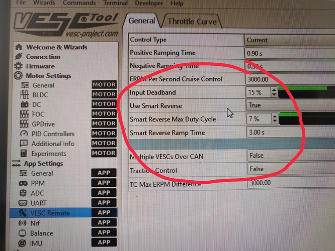

No no no. Let me rephrase it. There is an option to disable and add a delay to it.
Oh there is? I didn’t even see it! Would you be willing to share a screenshot? I thought I looked everywhere
Here you go.
The “vesc remote” settings didn’t carry over for me? You can set current brake no reverse there but it doesn’t seem to make any difference
First off, what vesc tool are you using? The pic above is 1.25, which yields to 3.62fw.
Edit:
Setting control type to “Current No Reverse” does NOT disable smart reverse. You have to set it to false.
Karam sent me a link to Google drive, where I acquired the Vesc tool 1.25
Screenshot of APP >> General will help.

Yes, current no reverse on all. Smart reverse is good when setup correctly.
Alright well good to know it can be done. Oddly enough smart reverse on 3.62 is working how it’s supposed to, and is actually useful. It is possible the loss of traction issues I had were just because the wheels are still a little shiny
I believe you’re locking up your wheels. Try to lower your motor and/or batt min.
Got it, that is possible, I’m at -60 and -20
Wow. You need that much brakes on your TB110s? That’s a lot to me.
Try to play w neg ramp too. It’ll smooth things out a bit
Honestly I’m not sure, I am running 15 40 so not a bad ratio.
Last board was 14 40 and was -80 -12
Maybe I’ll try -12 each side on this one too
Low speed braking is motor min. If you loose traction from low speed to a full stop, I’d play w that. High speed is batt min/Regen as far as I remember.
