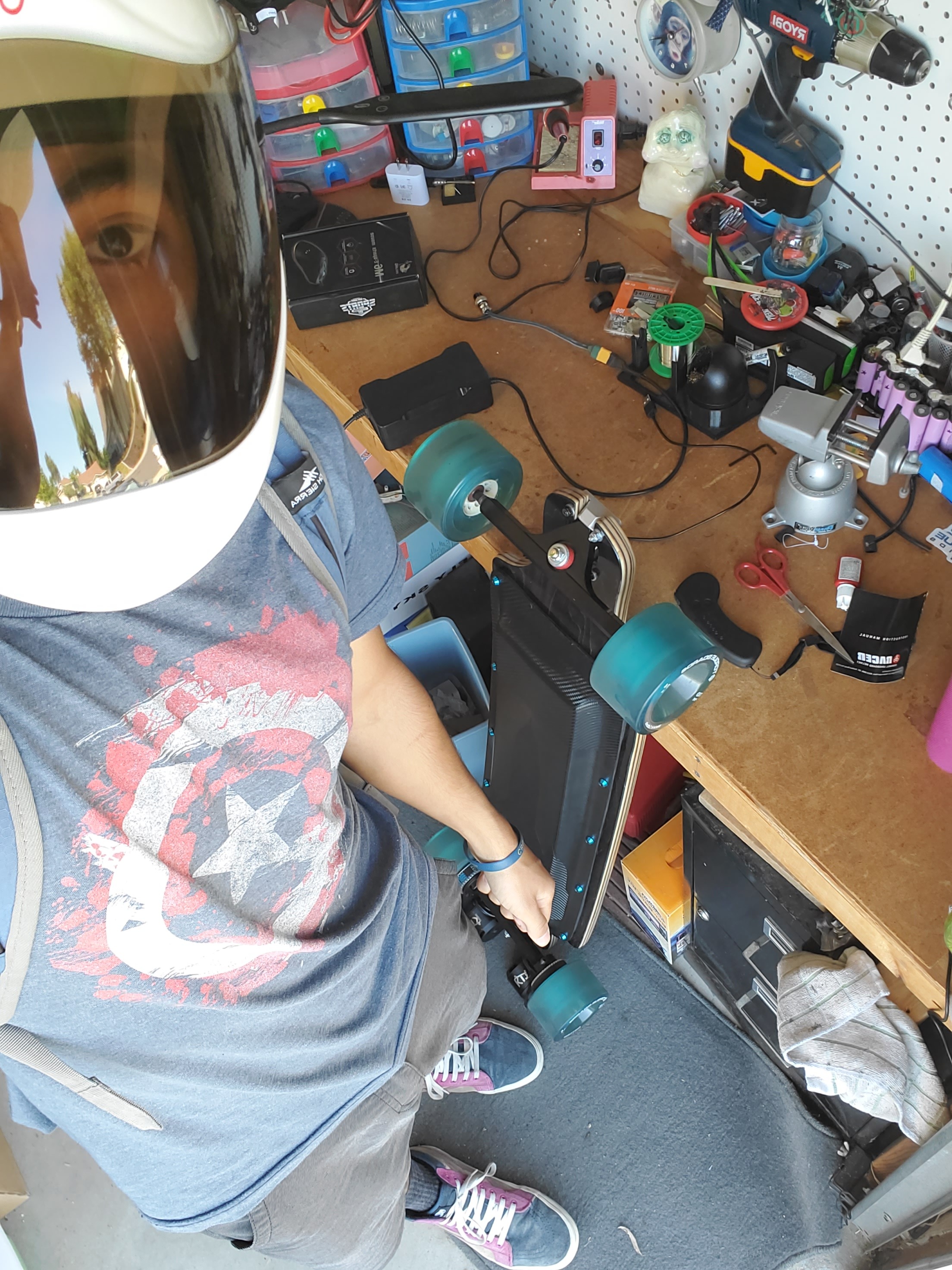

This is how I left my garage on Saturday, ready to take the board for its first spin. Lets give a little backstory here.
A few things happened to initiate this fall. First, this was my first real ride with a full-face helmet, second, this was my first ride on a powerful sensored board with the Vx1, and finally, this was my first ride with these trucks, with unknown durometer bushings.
Some observations leading up to the fall - one, the amount of sound that gets through a full-face helmet compared to a half shell is significantly less. (Who would have thought right) Another thing, I hadn’t ridden any board in FOC mode, been riding exclusively BLDC for a while, and more than I realized, I depended on the sound of BLDC to know how fast I was going. With these 6355 motors on FOC mode, the amount of auditory response is way less than I was used to.
I was planning to make this ride pretty long - at least 20 miles. However, I made it 0.7 miles. The first 0.5 miles went pretty well, went down a pretty big hill, hit around 20 mph no problem. Was still feeling out the board, getting used to it. This is where I went wrong. I haven’t ridden a drop-through electric board before, so I guess I gave it more credit for how stable it would be - maybe it was the bushings, maybe not. I do know that these are pretty soft, and I didn’t actually have the trucks that tight.
