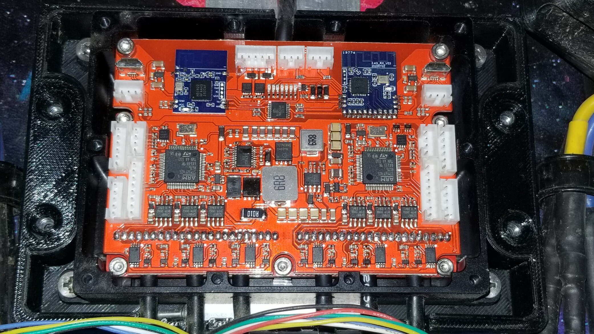

Well I may have killed my UBOX. :cry:
Only the “Vesc A” side lights up when powered on and it’s just throwing a red LED error.
No response to throttle input. I’ve tried everything that I can think of. . any suggestions?
13S battery.
Pop it open and inspect for visual burn marks
:man_shrugging:t6:
Edit: No damage or burns as far as I can tell. :thinking:
Now it’s like both sides are working but side b keeps throwing an error light and temporarily stops functioning.
What happens if you try to re-do setup?
Just what I described above. I actually tried that first.
The first time I ran detection it gave a crazy reading for one motor. It rated one for 40 amps and the other for 68.
Ran detection again and readings seemed normal but now I get the “fault code” light and one side is working intermittently.
