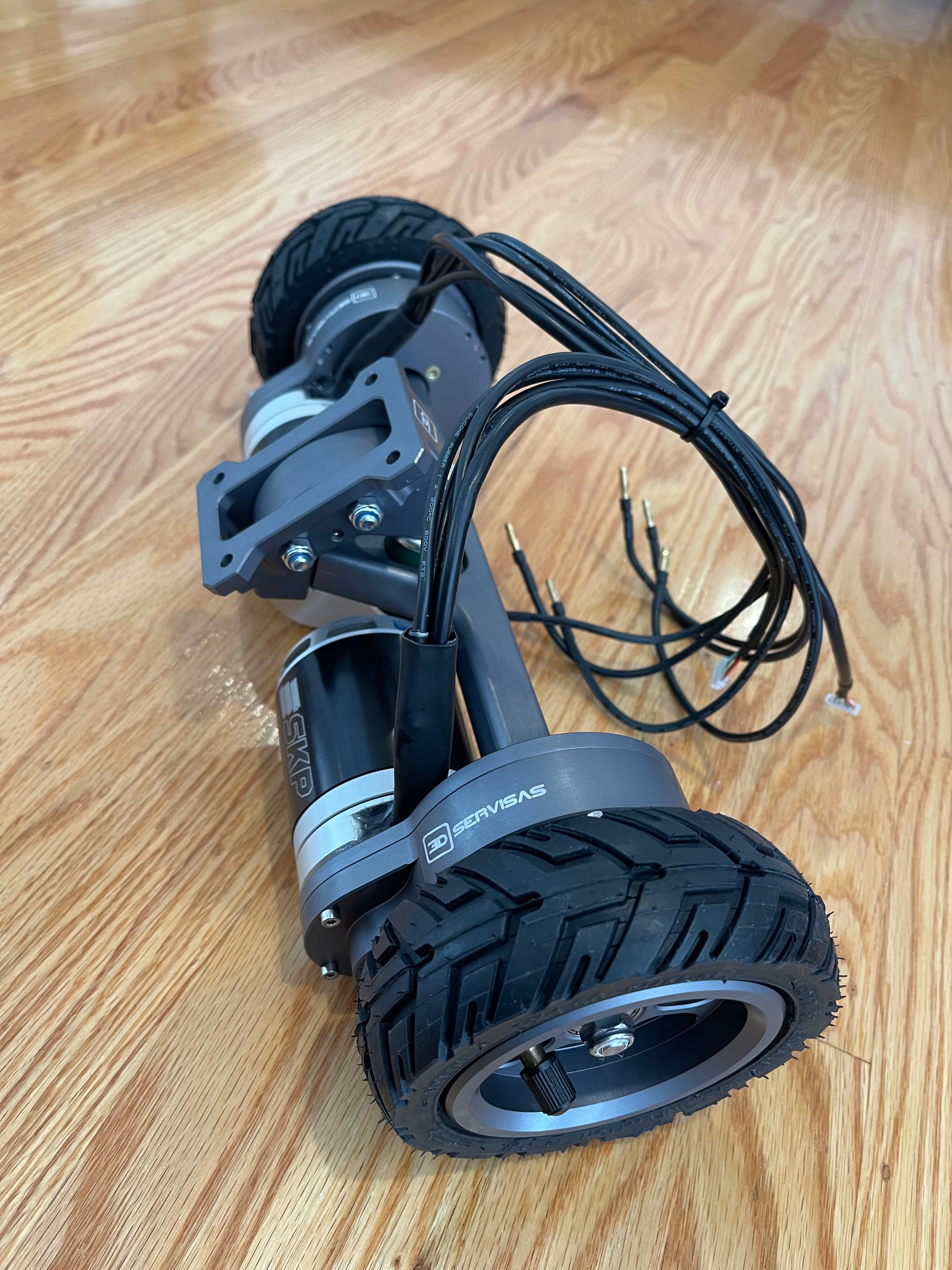

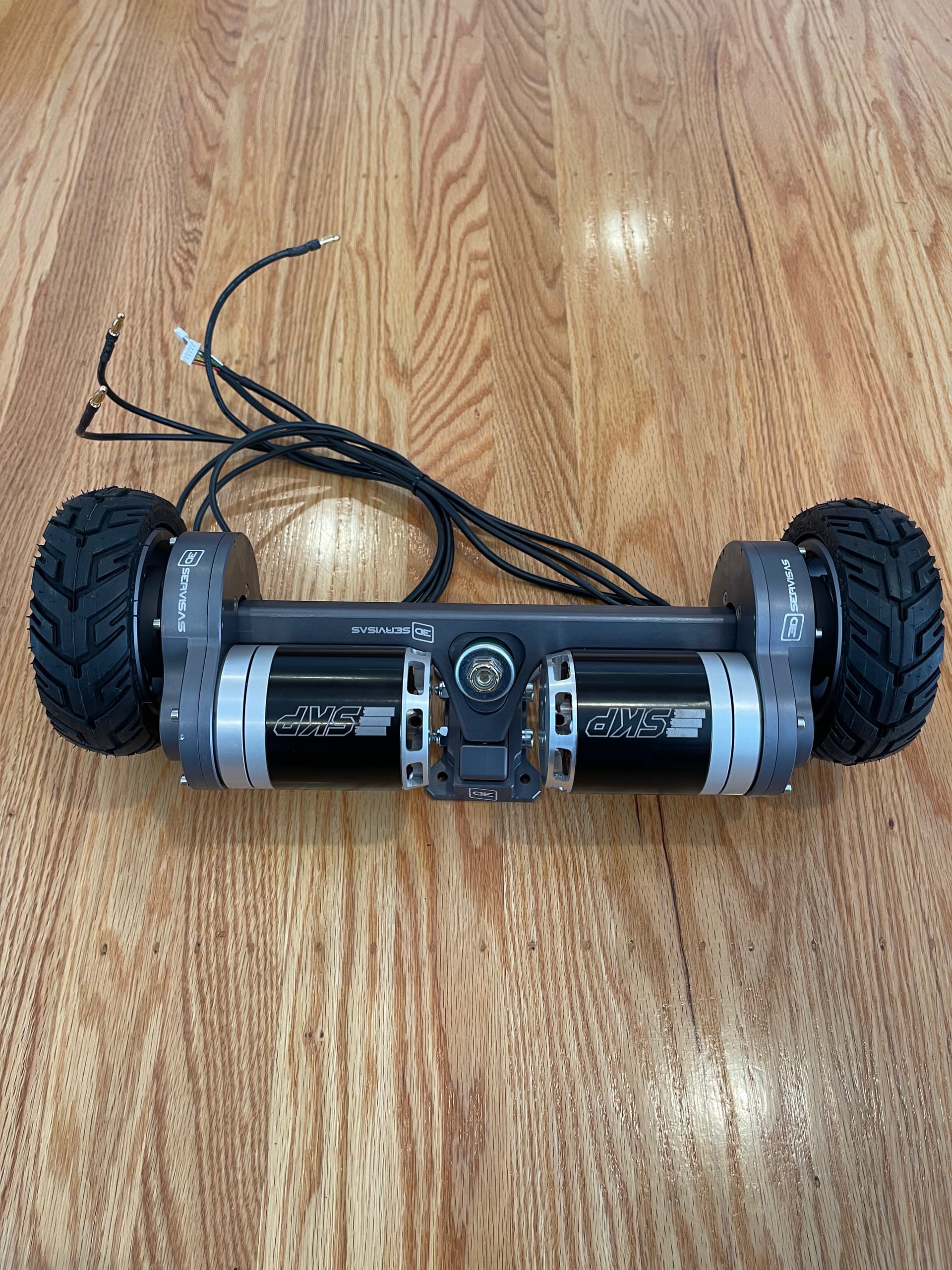

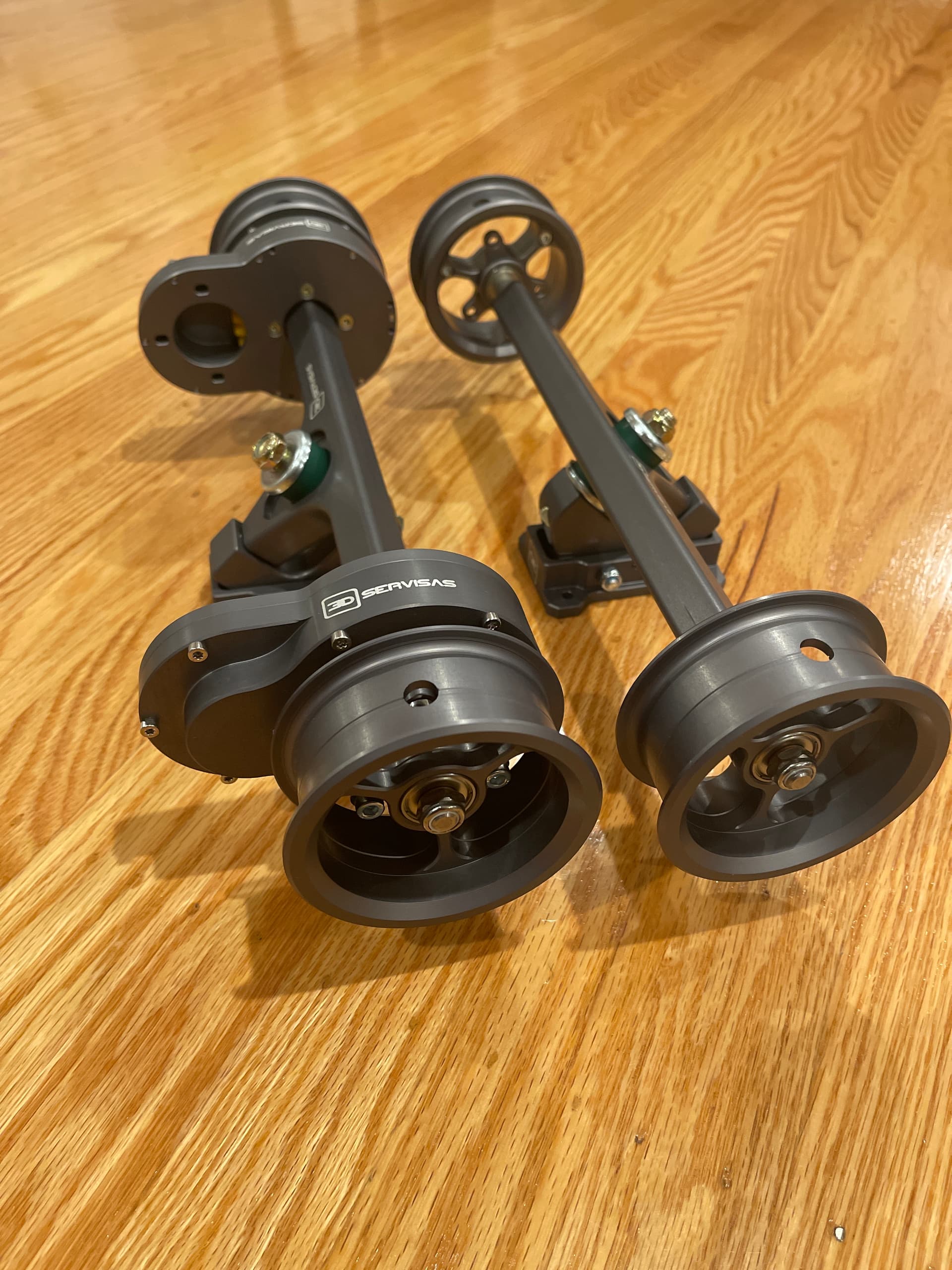

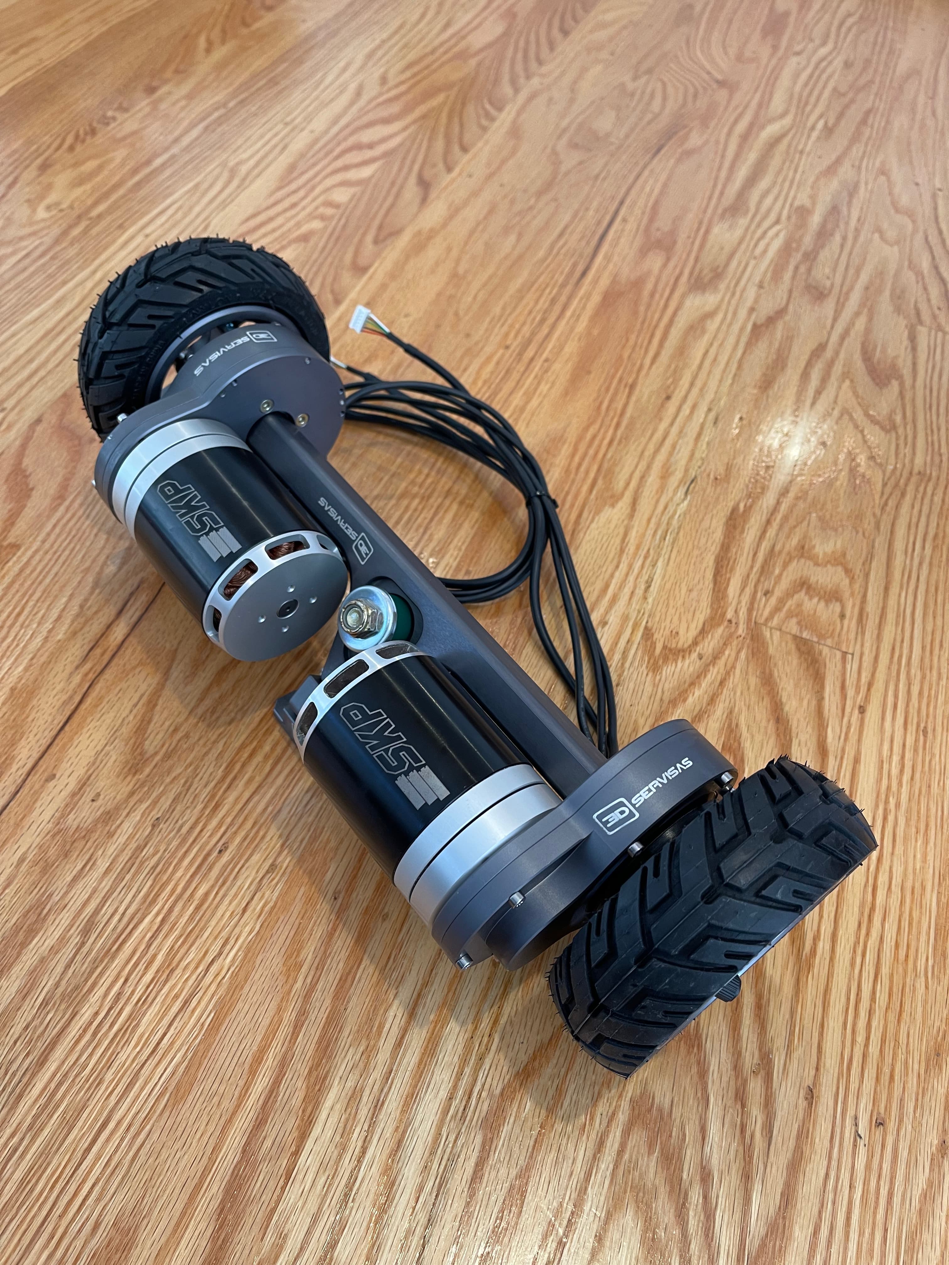

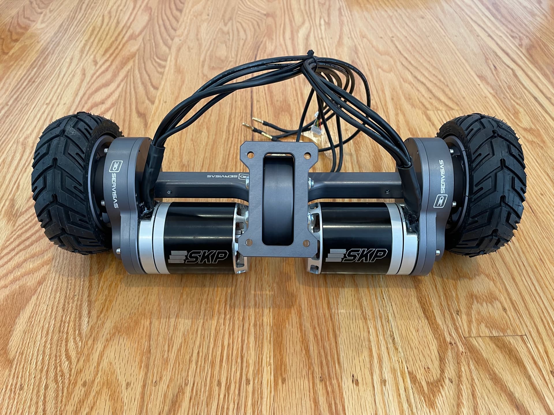

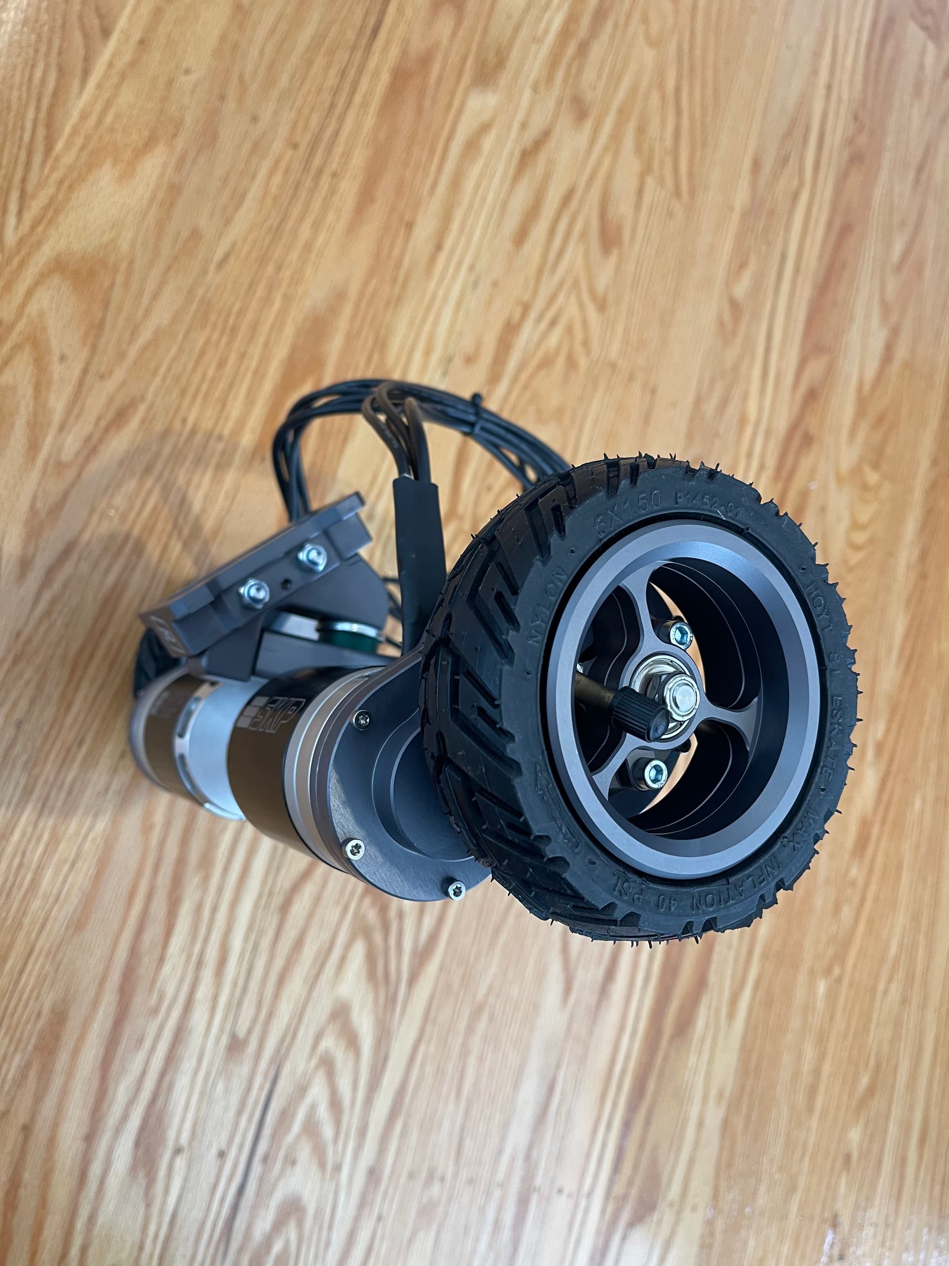

3 drive trains 3 complete High performance esk8s coming up! I am in love with this gun metal anodize :heart_eyes::heart_eyes::heart_eyes::heart_eyes: @3DServisas :rocket::rocket::rocket::rocket:
Broooo gun metal looks so good. That might be the move when I order my finality. Still debating between that and black, but now I’m leaning toward this!
It’s super clean, I think for sure the way to go. Like it very much!

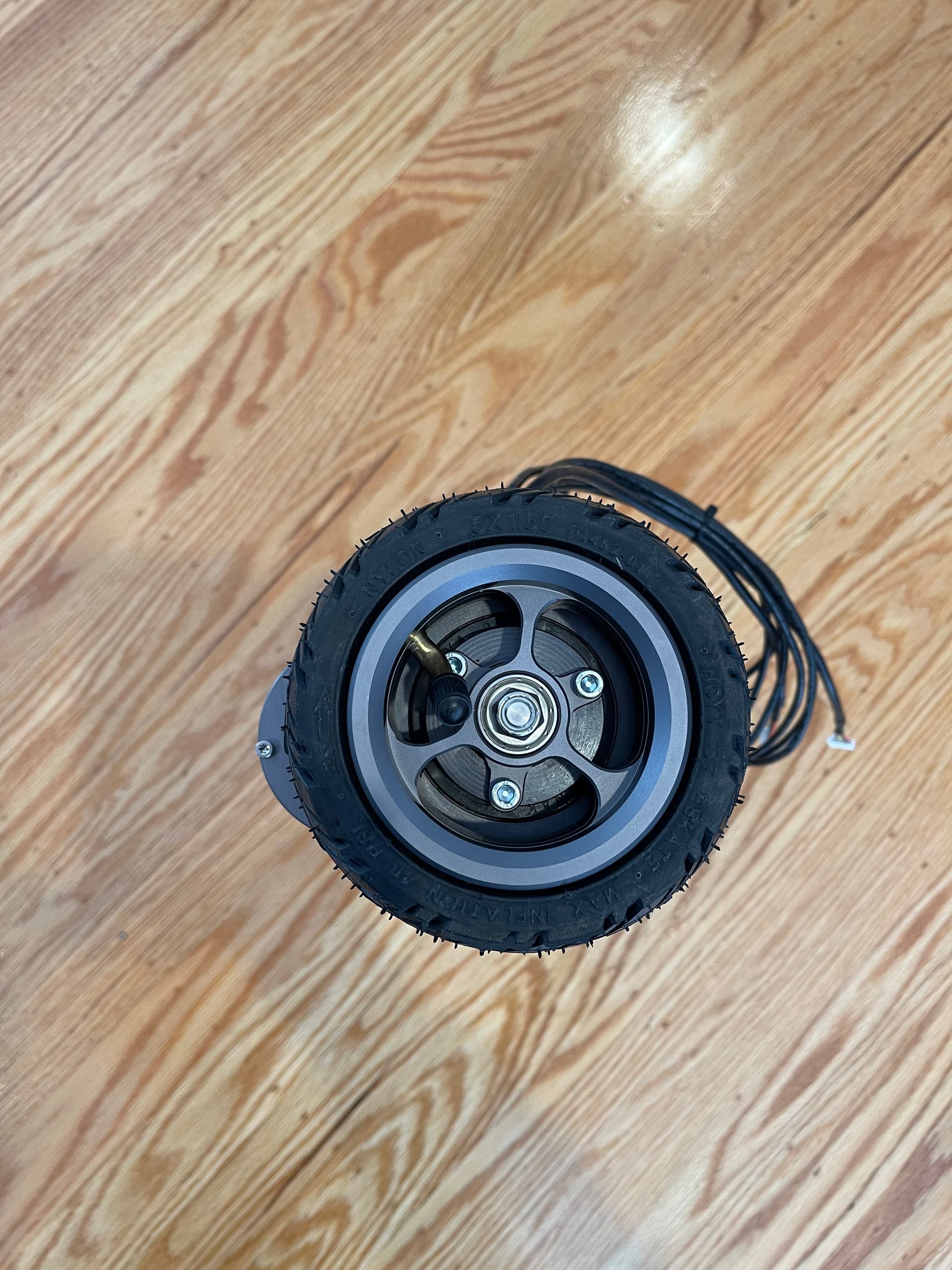

I love the big stuff but this small one…aaaai so excited for this one
What gear ratio is the 5" drivetrain?
2.6
:heart_eyes::heart_eyes::heart_eyes::heart_eyes::heart_eyes::heart_eyes::rocket::rocket::rocket::rocket::rocket: not a lot has me this excited about esk8 like these tires do, and the amazing gear drive to match :sunglasses::sunglasses::zap::zap:
Boy how you get all these high paying clients that want Hoyt tires and 3DS stuff lmao
Why do you say this? What is the benchmark for value here? Also, these particular new Nano gear drives are actually very cheap :zap::zap: They will be coming very soon, the set I have here is for testing.
The reason I prefer to use @3DServisas gear drives is very simple … they work very well and they work for a long time…they also sound really really good. I find other drive trains I’ve used to sound a little bit like a toy, and that puts me off like a lot. When you are spending 2-4K on a PEV I don’t want it to sound like a toy or break down. So if I take on a custom build I prefer to only use parts that I have personally tested at length and parts I can say with confidence will last. Also…3Ds parts are very competitively prices - not sure what all the misconception about them being expensive is.

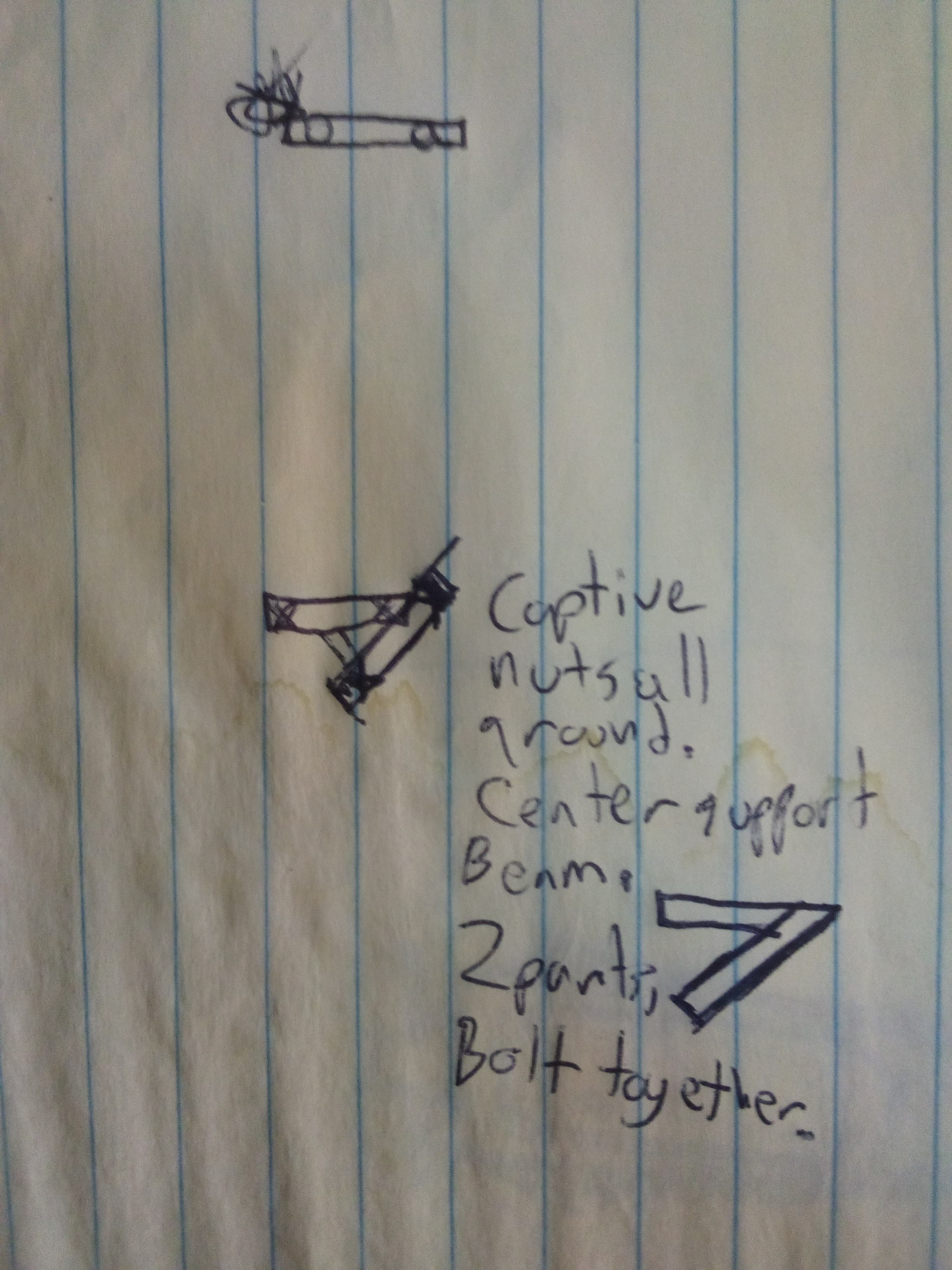

Vat+international shipping makes the price appear higher, I think. The only thing of theirs I consider overpriced is the 35 degree risers. There is no way you can’t make a cheaper version of that and I don’t care what anyone says. Redesign it smaller.
Boom napkin engineered.
