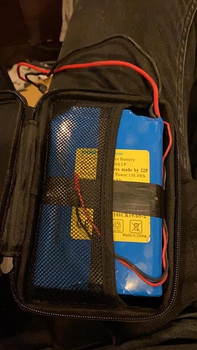

self built 12s6p with 30q’s and 100A smart bluetooth bms, 100A main fuse and 8A chargeport fuse
battery barely fits in the box. I put some foam and a thin sheet of teflon under the battery
