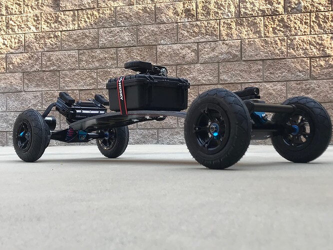

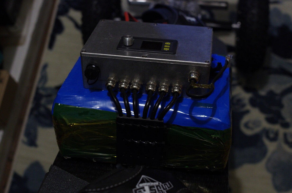

Barely fits my 22,000mah 7s lipos but 6s should fit easily
You fellows using the tie down straps instead of inserts… Link me a strap you like!
I’m guesstimating 26" is about what I’m after. Ratchet or velcro? Planning on using a non skid sheet under it.

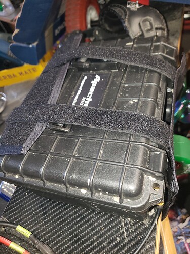

These are pretty burly and useful. I’ve got one of the Onetigris straps holding up a 10s3p battery/enclosure under a board, along with the TFY elastic strap to provide some tension, so should also work well for a top mount.
Ooh that looks interesting but I’ve got a bigger top mount box so it would need to be a good bit longer.
Just link two or three straps together. I think with those straps I linked, you would have enough length to work with.
Here’s how far one of the Onetigris straps will get you, so two should fit just about any size box. This Apache box is a little over 4" tall, for reference.
Perfect example, thank you

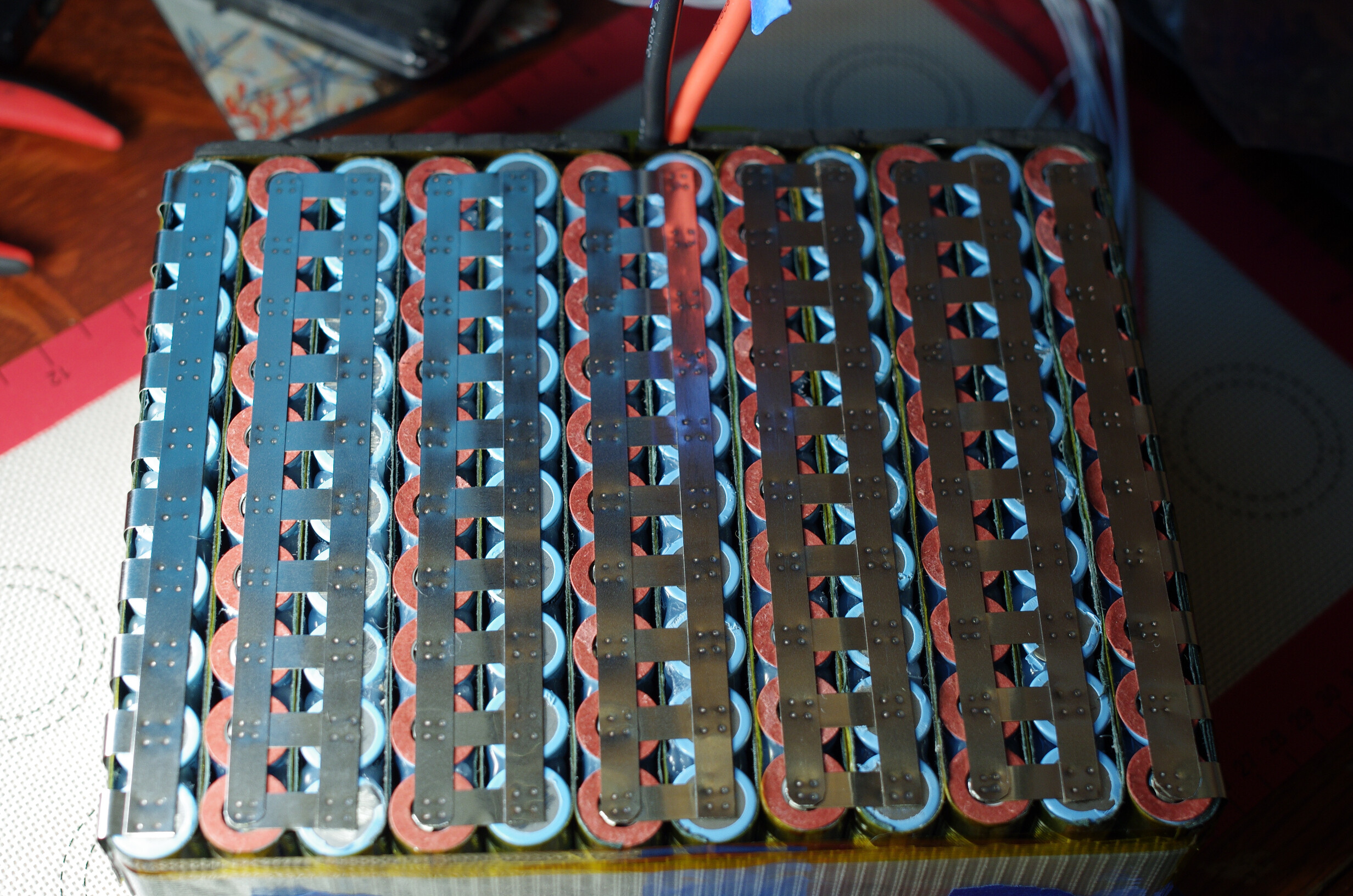

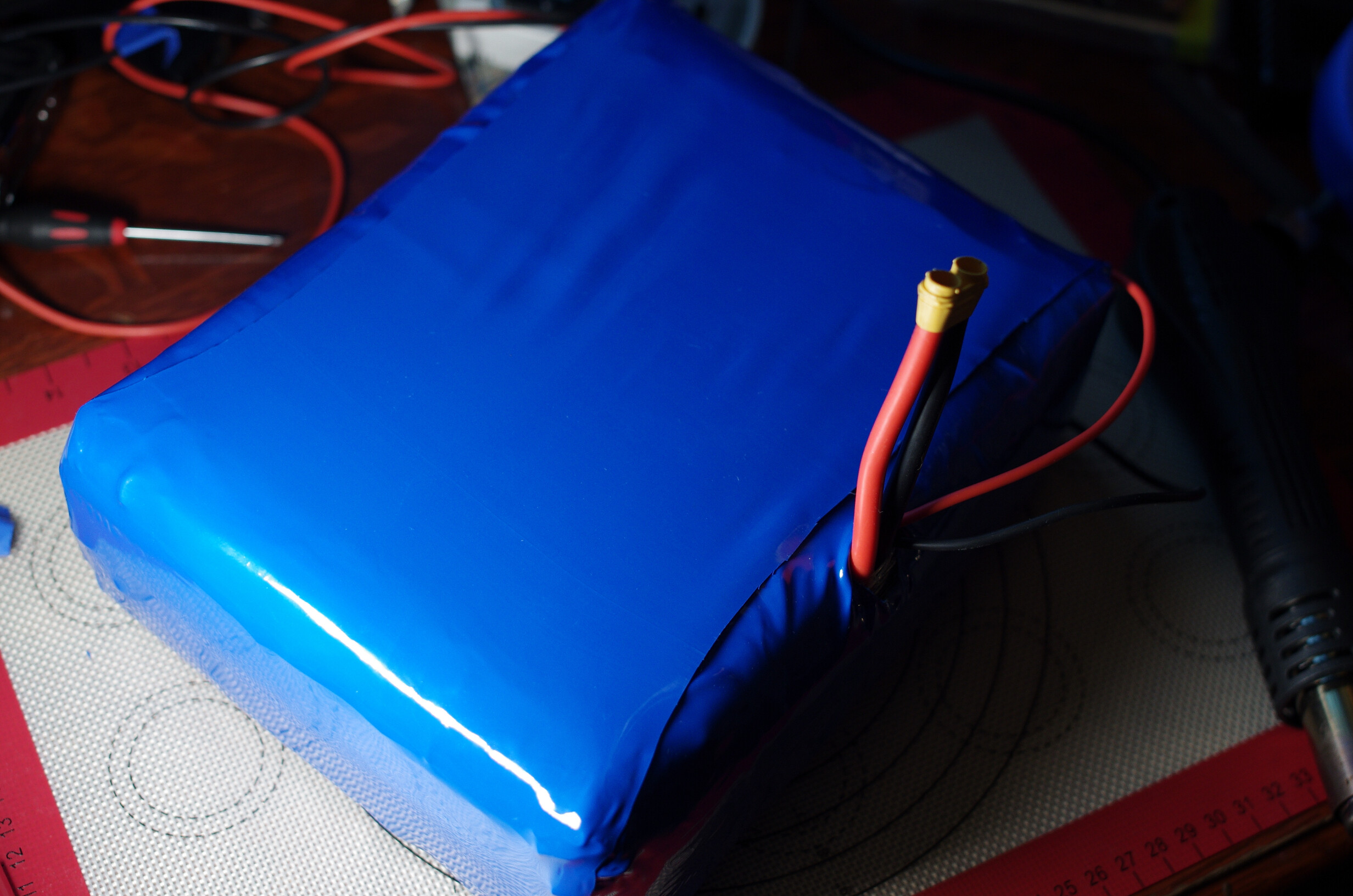

Here’s my first single drive build using Harbor Freight’s Apache enclosure housing @TheRef’s 10S3P P42A pack and a Pelican 1040 case for the VESC6:

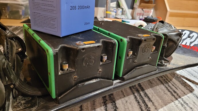

Modular multi-BMS 12S6P 21700 (2x 12S3P Molicel P42A). Lighter 12S2P 18650 (samsung 20S) packs in progress for even better jumping next season.
