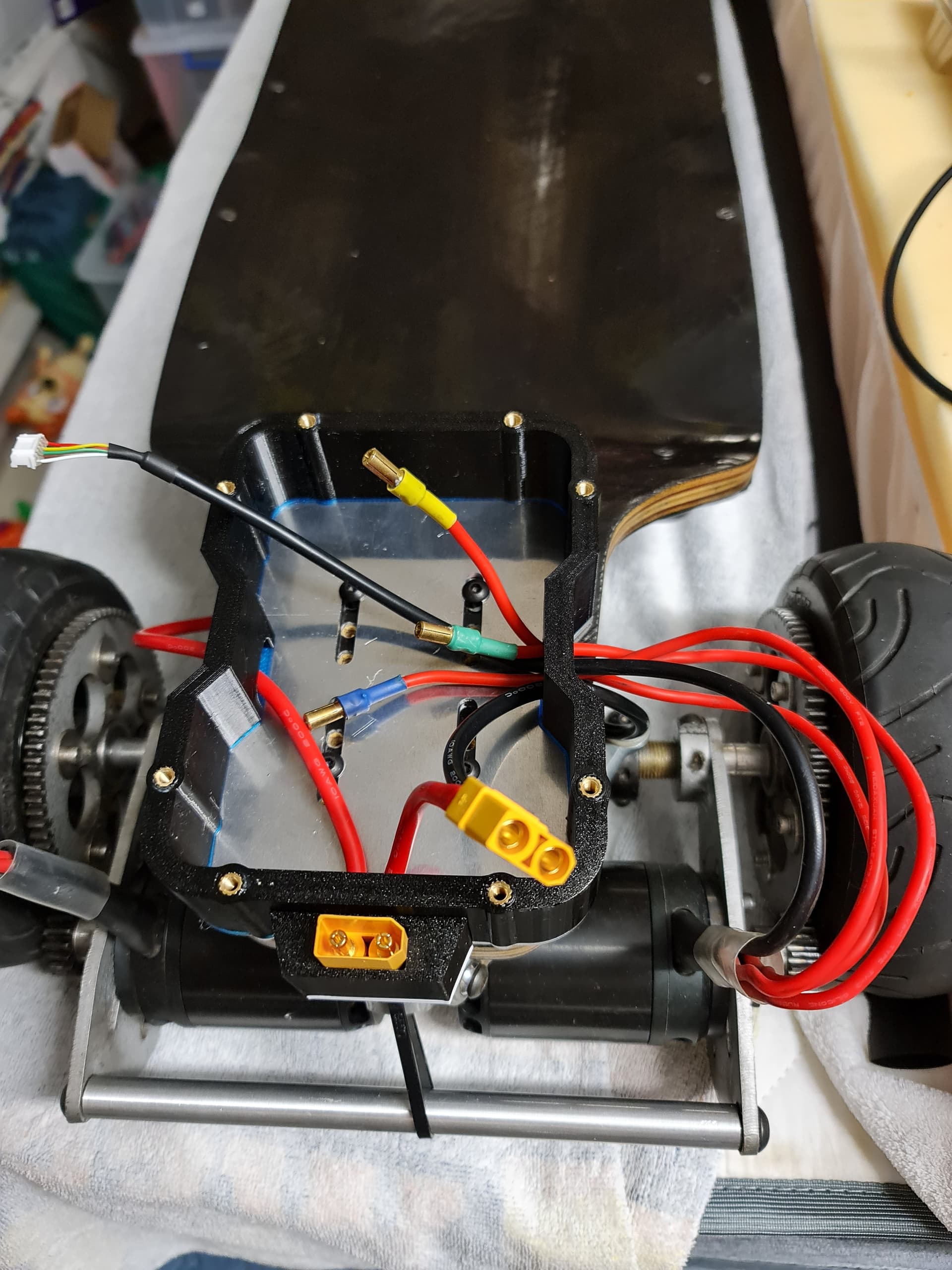

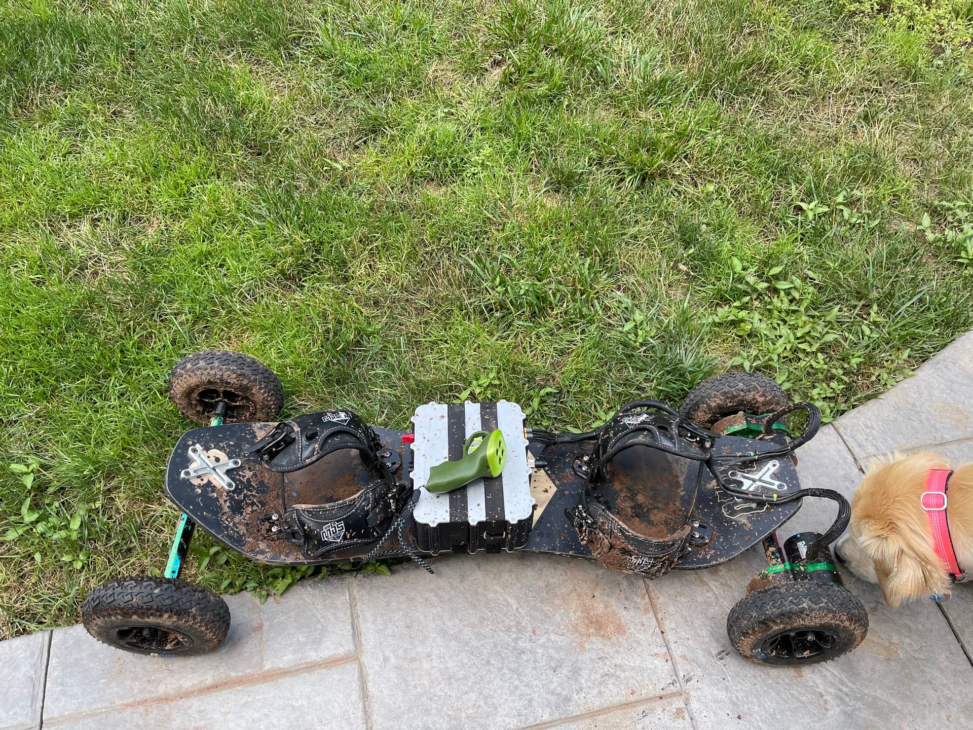

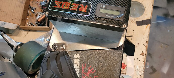

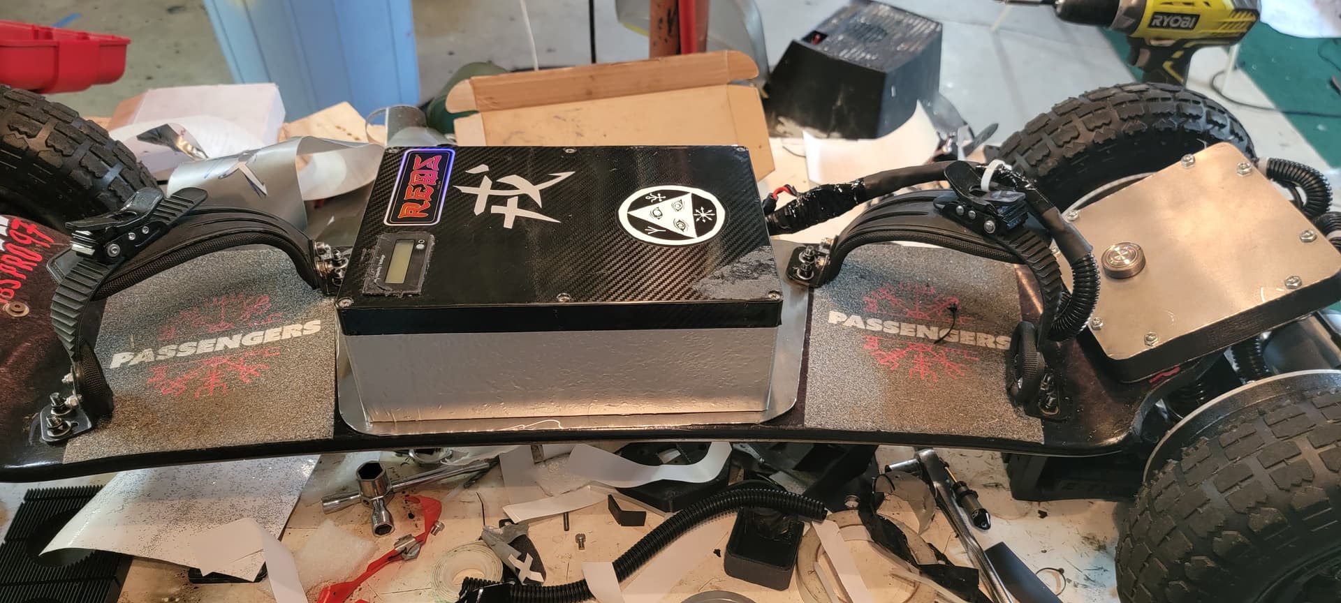

Your standard trampa massive monster box with a 15mm printed riser.
13s9p 21700 stuffed inside

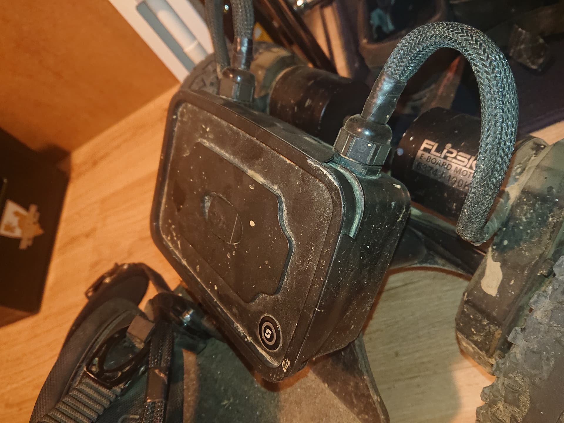

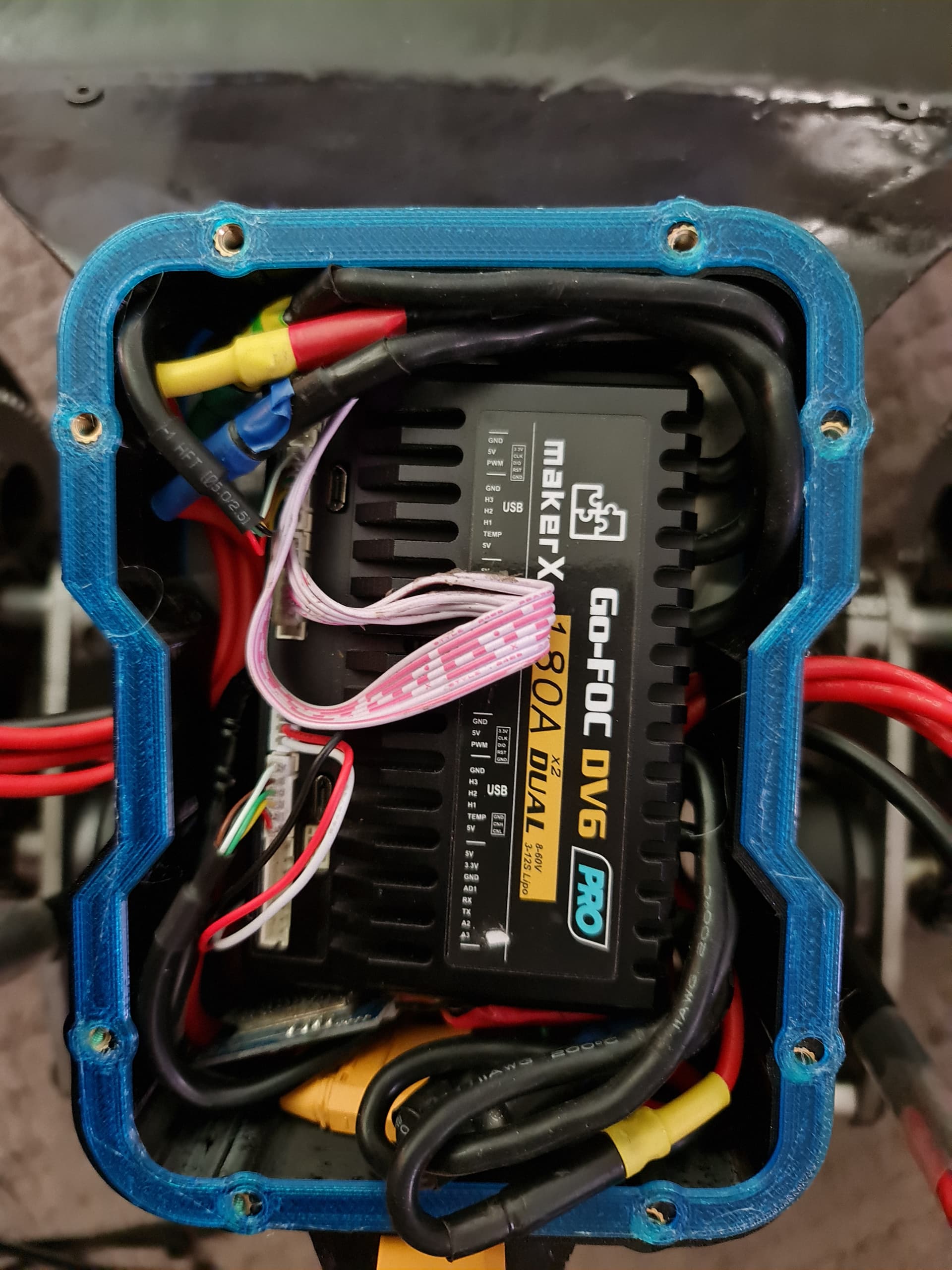

They’re muted with dark film.

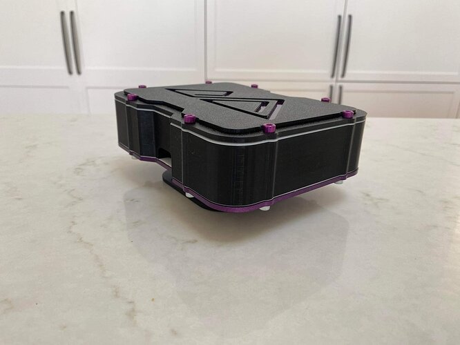

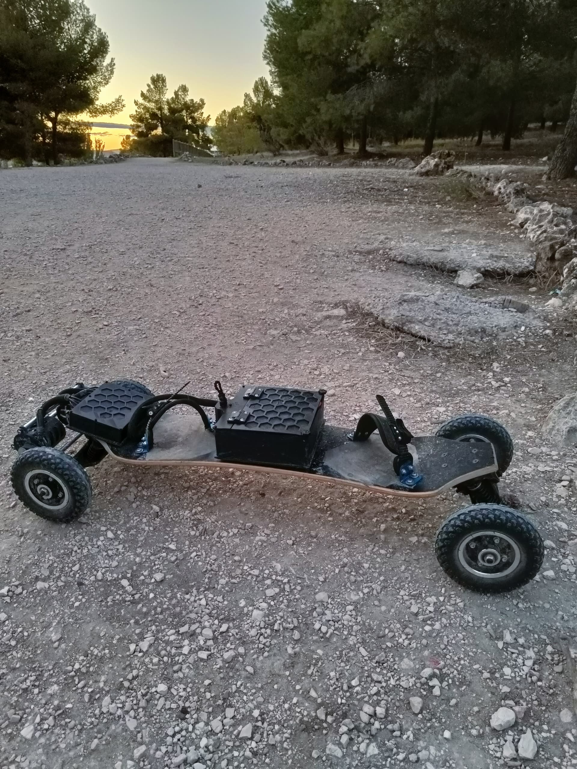

3d printed walls with slide in 6mm hex standoffs. Send cut send aluminum plates. ESC and 8Ah of lipos all inside. External balanced charged.
Old photo, but it’s held up pretty well all summer to abuse.

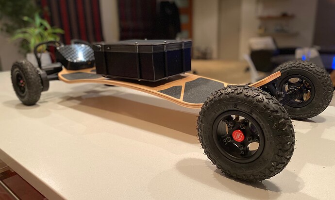

3D printed boxes with wooden bottom. The lids and hinges are also 3D printed. The battery box contains 8x5000mAh LiPos (4S2P) that are externally balance charged, so a set of 3D printed thumbscrews are used to quick swap them. On top of the PETG walls there’s a TPU gasket so the thumbscrews have something to press on, reduce rattling noises and prevent moisture from getting in.
That looks really nice! I would love to see the hinges and thumb screws in action!
Here you go! This video is not from the final version, but you get the idea:

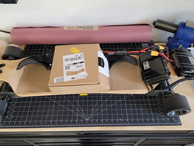

im looking to stick a ubox and a 16s4p 21700 pack in an apache/similar box. Anyone have a recommendation?
B&W Type 2000
Fits a 12s7p stacked vertically. 12s8p (or more) if you do 2 horizontal rows. Room in the lid for mounting ESCs.
Nicely fits horizontally on Trampa decks. Example:

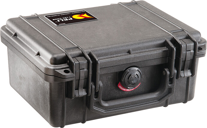

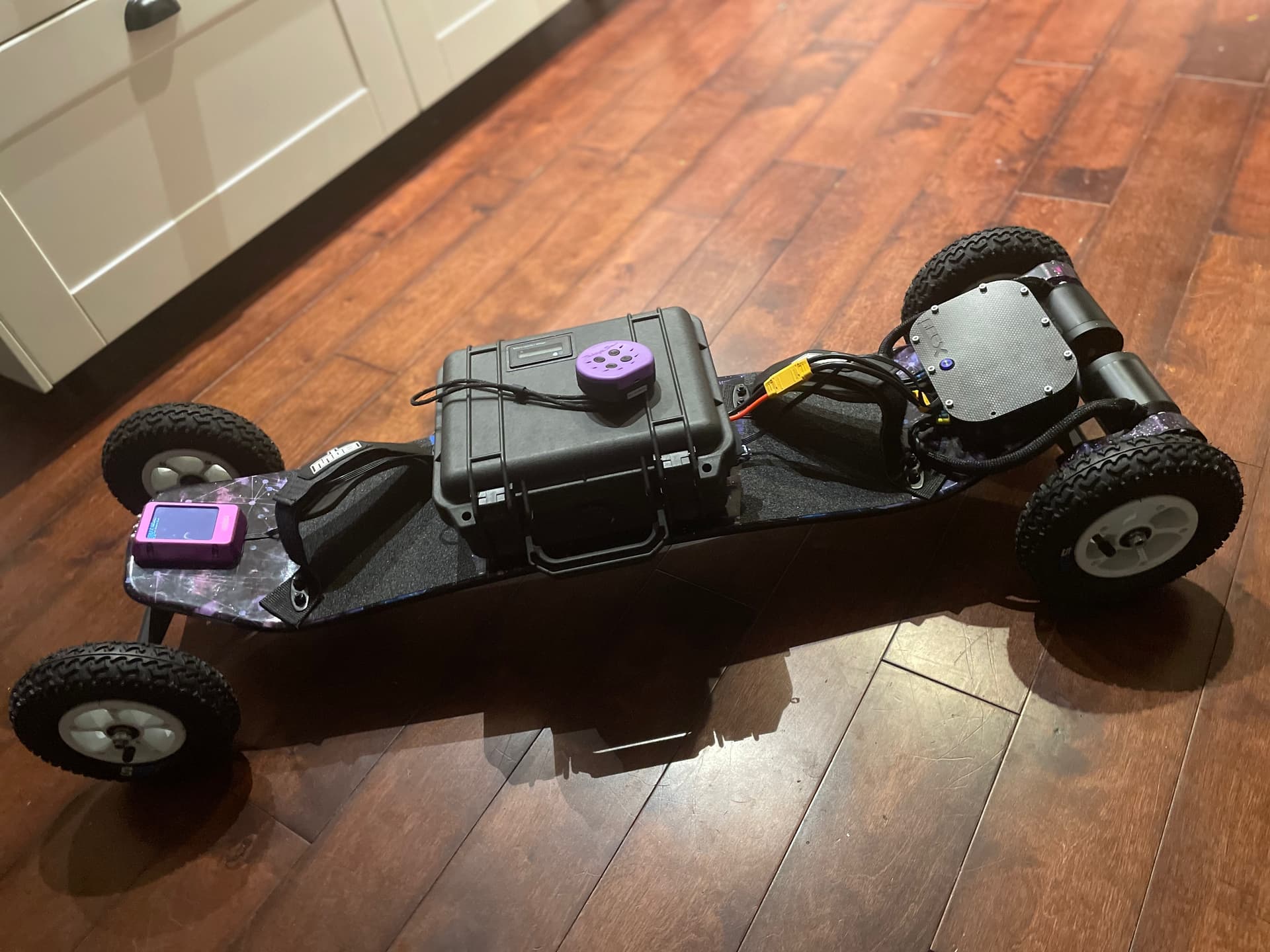

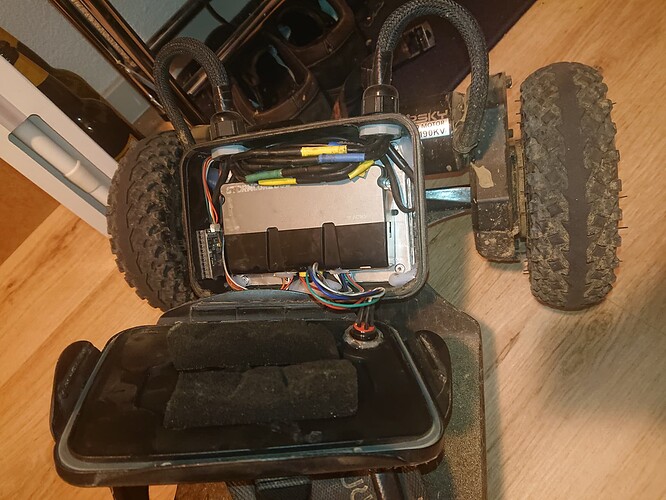

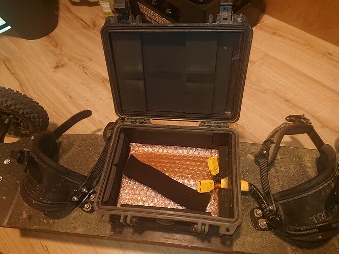

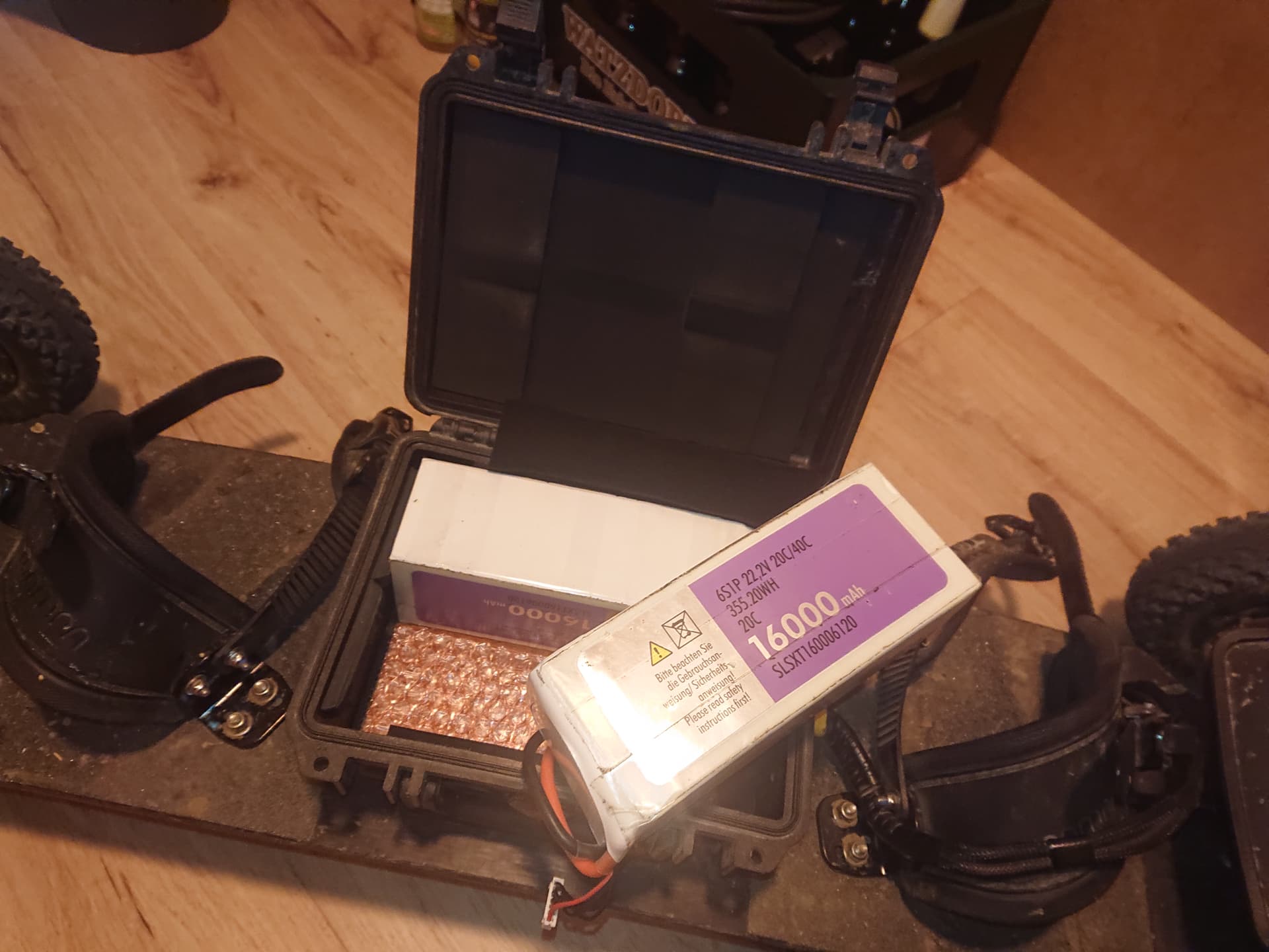

12s6p Pelican 1200 case
Peli 1150 for the battery, including a panel mount and integrated series adapter.
Fits 2x SLS 16000mAh for a 12s setup.
The ESC enclosure is a spray painted click and lock type container with some tape added on the inside for durability.

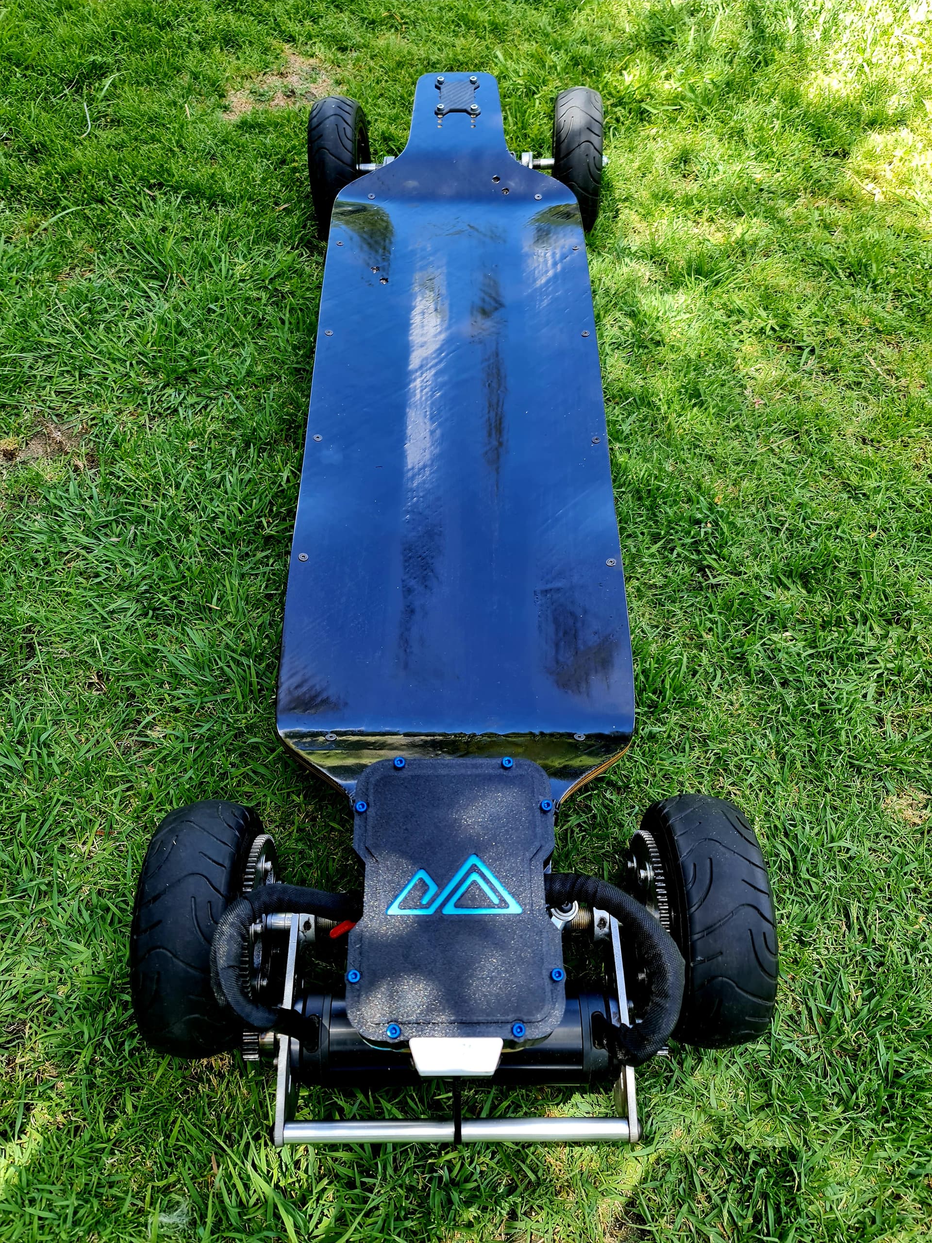

Hi, I think this is nifty. I have a 12s 4p molicel p26a flex pack built by eboardsperu. Here is the enclosure used…
I bolted the enclosure the the thin sheet metal and the sheet metal is mounted to through the binding holes. This way the deck is spared with holes and the result doesnt need a strap.

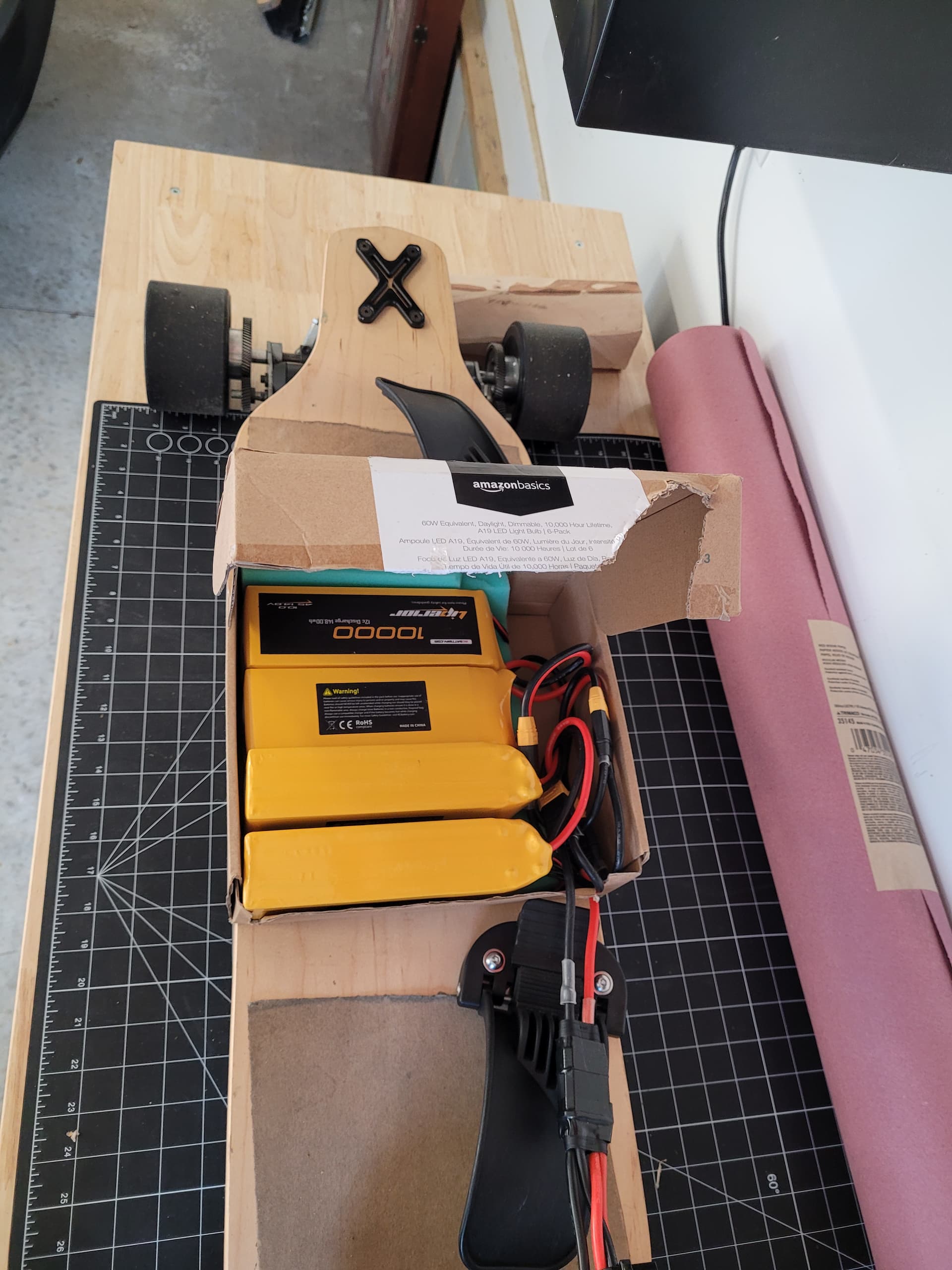

Amazon basics
