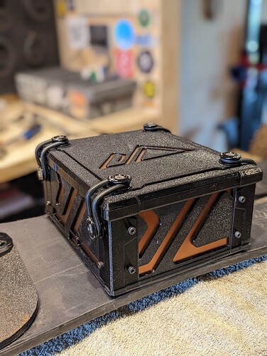

Downsized battery box to fit 2x Turnigy Graphene 6s LiPo Packs
Really like the way that lid is secured, how waterproof/resistant is that setup?
Yeah the JDM clips offer a “quick release” option which is great for a lipo set-up. I made this box for personal use and haven’t done any thorough water testing/submersion, however it’s survived a few rainy rides just fine, so the seals, clips and TPU gaskets seem to be doing their job.
The standard boxes I’m producing have their lids secured by m4 bolts and have held up to an IP65 standard.
They look really nice Tas. Probably the best looking top boxes i have seen. I really like the idea of the modular corners/panels.
Thank you man! I’m pretty happy with how they’ve developed over the past few months. And yeah, having everything modular allows for upgrades and small alterations in design without having to sacrifice the whole box.

and you epoxy bolts or nut into the box?
You can see some of the inside of the enclosure here.
I drill holes and use flat head bolts that go through it.
The bolts go into inserts on the deck.
I used two aluminum strips(popsicle stick size) and gorilla tape for support so the bolts have some surface area to push against.

M4 Heatset nuts into plastic
