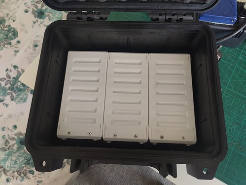

Also test-fitted 8P 18650 new thinner version with shallow screws in Peli 1200 case.
This way it’s possible to have 10S8P with space for BMS and even VESC
Or it would be even possible to fit 12S8P in it with some small thin BMS.
