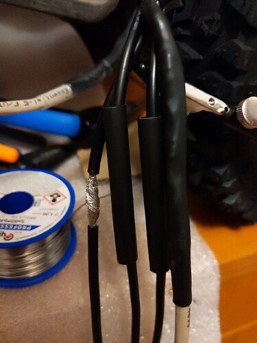

A few hours of soldering only to find out the sensors don’t work. OOF.
Tried the other motor and its sensors also don’t work. Double OOF.
But then I tried with my 60D and it detected the hall sensors :thinking:
Although the temperature reading on the motor I already extended sensors for is showing a negative value. Hopefully my crimps just suck, I guess I’ll reinforce them with solder.
Not sure if there’s an option in vesc tool to change the sensor voltage in case that’s the issue, or if I should just replace the Trampa ESCs for a stormcore 60D+. Worst case use HFI.
Well, time to extend the 2nd motor… God these sensor wires are hard to get the insulation off.

Finished the motor wire extensions:
Figured out the sensor problem; vescs weren’t set to use 5V. There’s a switch on the inside:

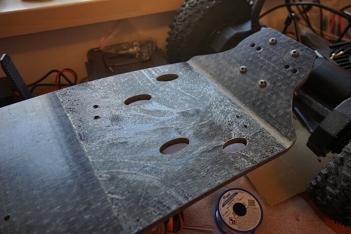

Tore the griptape off the board:
Cleaned up the leftover glue with WD40 and paper towels. Nice!
Then I dremelled the Trampa logo off the wings:
Drilled a lot of holes for the wings:
My board really looking like Swiss Cheese now:
