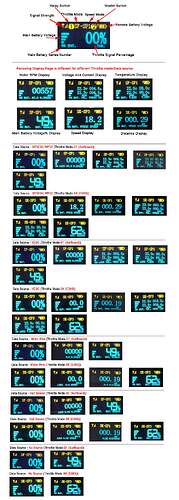

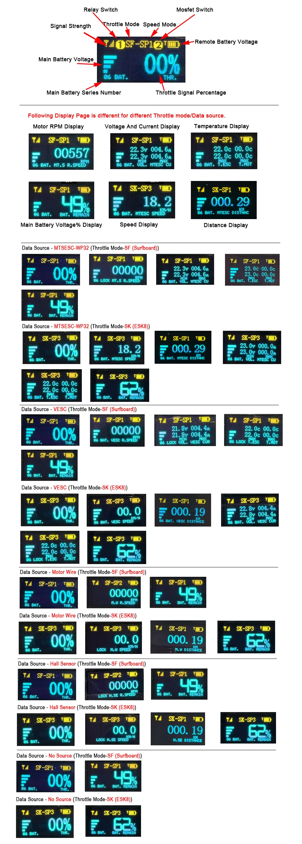

The Maytech dual trigger is looking pretty good.
  • Waterproof w/ wireless charger
  • Dual trigger w/ larger triggers than VX3
  • Has high/low power output levels
  • Outputs on the receiver for up to 30v 3a or mosfet control.
    The receiver pins can plug straight into an expansion board to split pwm to up to 4 outputs.
Telemetry options. Can use a phase or hall sensor wire for rpm measurement and battery wire for voltage rather than needing a VESC
That’s the one I currently use - it’s def better than the VX3 in pretty much all respects yeah.
Never tried the relay switch but that is cool if you have a use for it.
Feels very good in the hand, really nice trigger tension, no connection cutouts using the high power mode though no testing in high interference yet.
Downsides: The wireless charging only is a downside to me, since it really restricts the situations you can charge in. It also annoys me that the voltage settings in the OS only go up to 18s so I can’t get accurate stats on 20S.

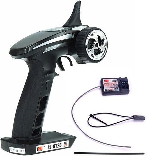

So what is up with the GT2B?
Is the signal good?
I am trying to modify the Dumbo remote.
But this has been done for the GT2B already.
Is the signal perfect? Or are there know issues
It’s essentially the same as the puck. Fly sky made the puck
ALLEGEDLY
The GT2B mods almost look like more work than what I had to do on the Dumbo remote…
