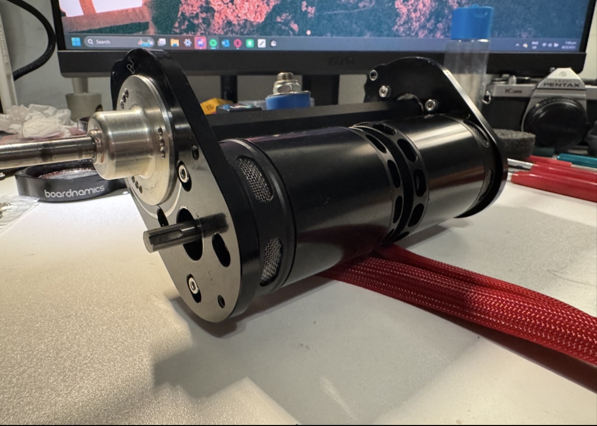

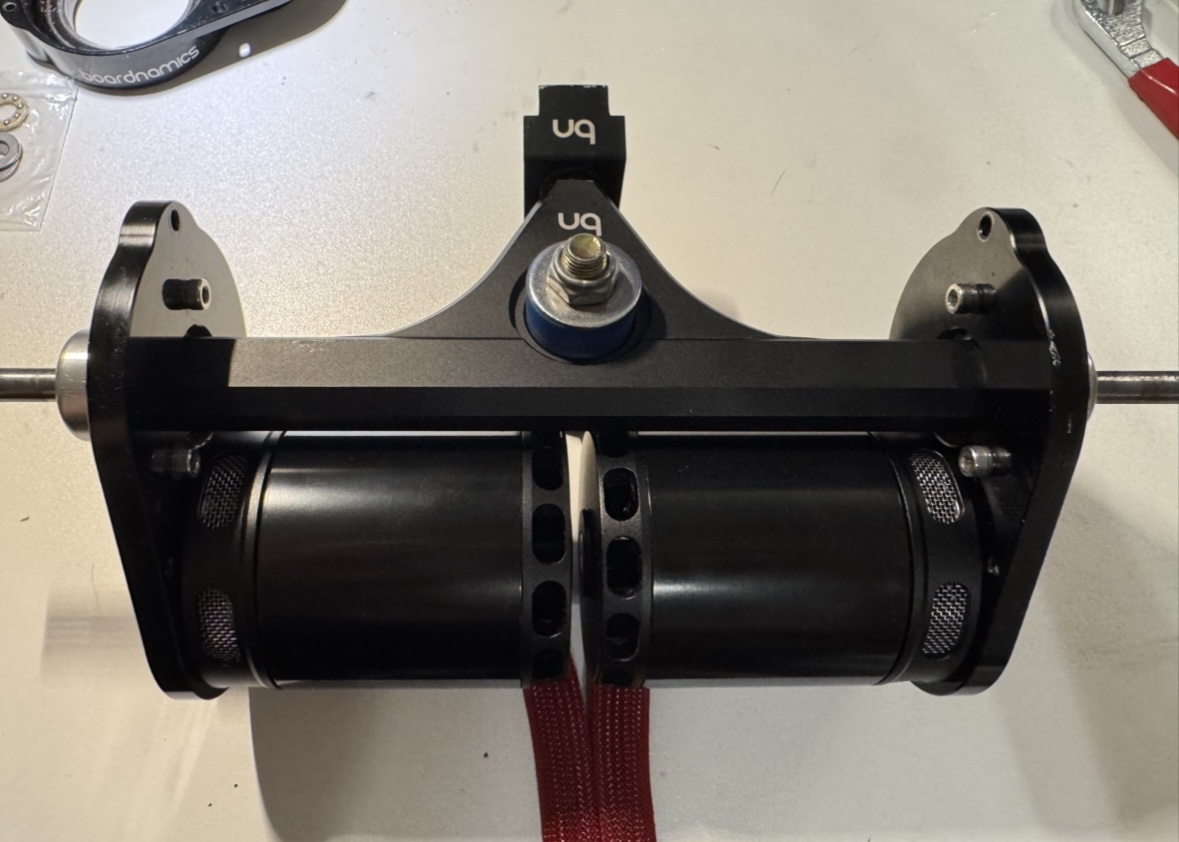

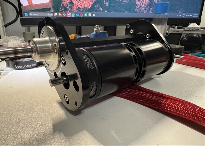

My motors shat themselves. Seems like the CAN magnet retaining ring came loose and has been moving outward toward the stator. Not sure how or why this happened, but it caused one of my motors to scrape the edge of the stator side. As i was revving it, this happened:
I guess it caused some weird freak out fault, but it went FULL brake on both sides at about what looks like 60-70 percent speed. I was able to recreate the issue hence this video exists.
Just to make sure it wasnt the esc side’s fault, i checked for faults (none) and actually used a small pry tool to push the ring back in. I ran detection again and the issue stopped.
Ive already had an issue with this same motor a few months back where one phase wire had snapped. I soldered it back, but Ive had the intention of replacing them eventually. Didn’t think id have to do it so soon.
Absolutely terrifying shit. I was so lucky that I had happened to be fucking with it prior to riding. I got these motors for free, but my life aint worth a pair of OEM motors man damn. If snapping a phase wire for no apparent reason ( no wire snagging, as well as generous wire length) wasn’t enough to obliterate my trust in it, this does. I’m assuming this particular motor has some quality issues, so no more chances!
Well, into the trash they go. I’m gonna got with a pair of Reacher 6384s 205Kvs. But, i cant afford it at the moment so, no riding for me for awhile. ( I really need to put my shortboard back together)

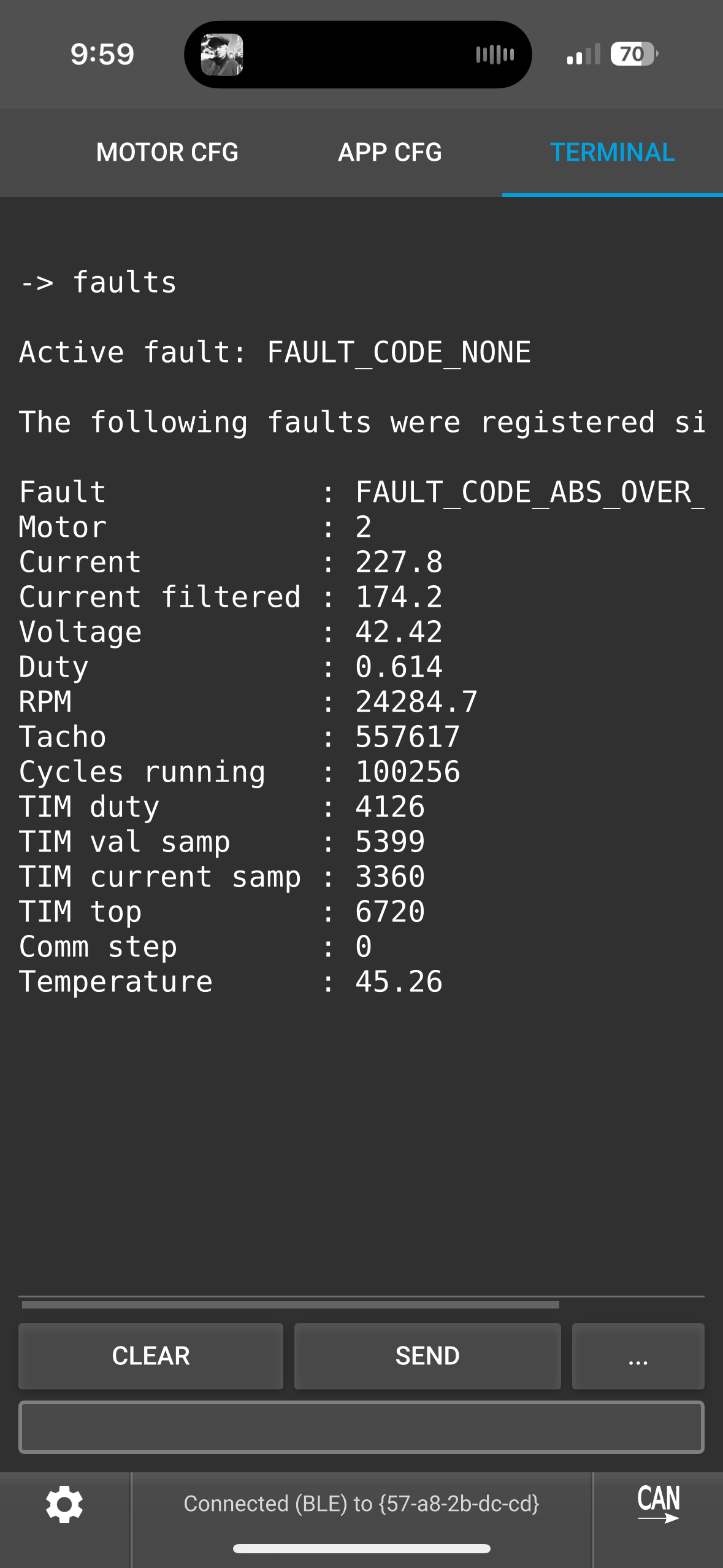

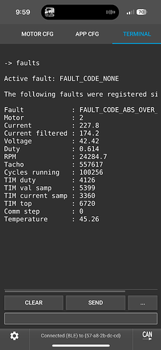

Essentially my issue is how close i am to constantly throwing an ABS overcurrent fault. It has already happened once, and i cant seem to raise my absolute current past its default of 200a.
I tried to make my board as punchy as i possibly could, previously i was running the same settings on my Unity, of which it had a default of 400a (for some reason) with no issues besides heat.
If the stormcore is supposedly more powerful, why would its default be lower than that of the focbox.
I understand that the motor max might be too high, and the ramp time definitely wont help my case when it comes to throwing an overcurrent fault. But, i was hoping for some answers and suggestions to help me maintain this level of punchiness without this over current issue trying to kill me.

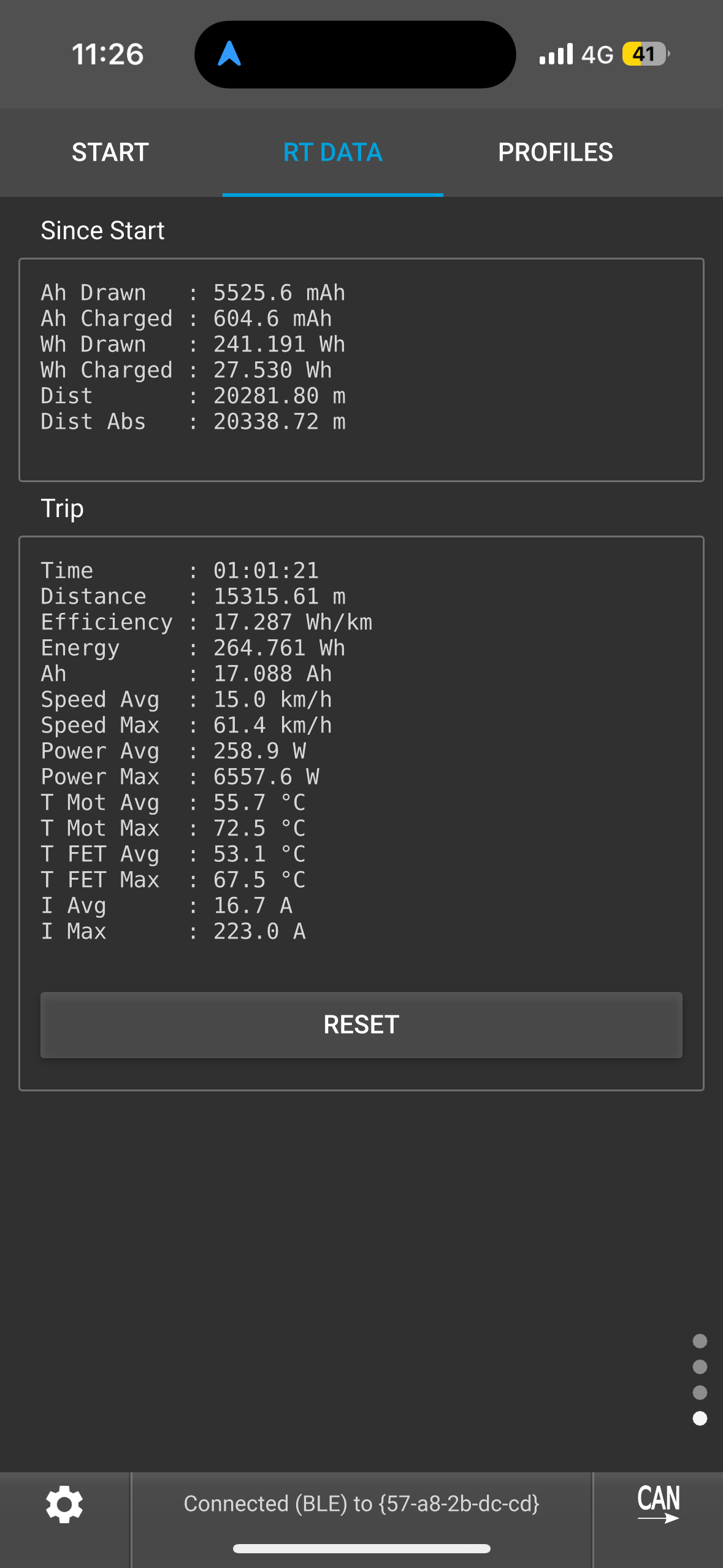

Above is the telemetry for todays ride. I pushed the board quite hard for context. Not sure if that last reading of “I Max 223.0 A” is my highest draw of the ride, if it is, its definitely on the verge of throwing a fault.
Pls help me im cry

Your 223A max i think it is from two motors, like 110A per motor
If you want higher abs max, go to vesc tool, firmware, tick the show non default firmwares, select the no_hw_limits.bin and update
