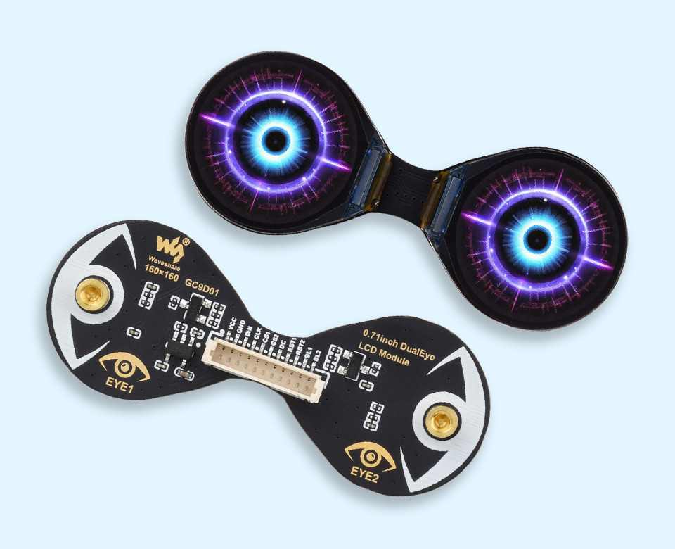

Not sure why or how but I’m just positive someone needs to make a remote that includes this module:
If I can make time this winter maybe I’ll look at re-mixing this into @georgebenett’s remote.
Just changed the license to allow derivatives
question is, why?
Art!
For Art’s sake :slight_smile:

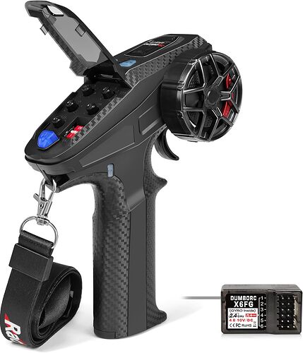

I’m also going to try this RC remote.
Dumbo RC X6PM
Any one using them?
Bro here is?
@Linny do you endorse this?
Yea that remote’s pretty good. Josh might make a forum post talking about this remote soon. It’s a very solid trigger remote, and the overall guts of the remote is quite small. If anyone is well versed with modelling, one could easily 3d model a smaller remote case, GT2B mastercho style and make a good remote with it.
Hey man yea, the remote is fantastic. Ill make a more in depth post soon, but you could get it in the mean time (i can vouch for it).
In terms of connection stability and response time, its absolutely fantastic, we have quite a lot of underground cabling here in Singapore which would usually affect mini remotes, but this one hasn’t lost signal on me once. Trigger is almost instant, just the spring’s feel might be a little weak for some folks but with use you can used to it. If you want a harder trigger pull you can double stack the spring which can be sourced from the steering of the remote.
Includes throttle+ steering trim and dual rate respectively, and a pretty nice form factor i must say. It takes 4AA batts or a 2s(I think) if you solder one in. Theres also a small battery indicator up top.
Overall its really nice, just it looks like a weapon unfortunately
I did order one from Amazon to try.
Nice man let me know what you think when it comes
Oh youll probably want to do a few things(mods ish):
There are two ports on the side, one USB C as a power source input, and a headphone jack looking port( For rc sims). I disconnected the jack ribbon cable inside just in case(less points of failure i guess?) Theres also a button for channel 5 near the grip, disconnect this as if youre a right hander, your palm will press it and itll beep which might be annoying.
But even if you dont touch anything itll work jusr fine

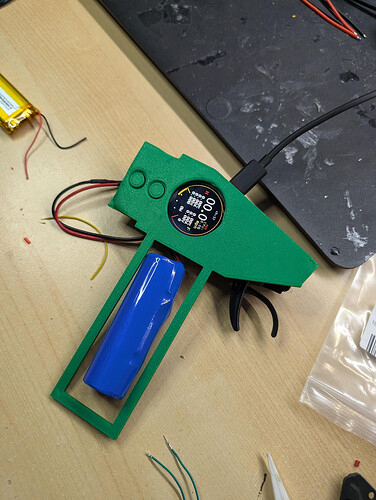

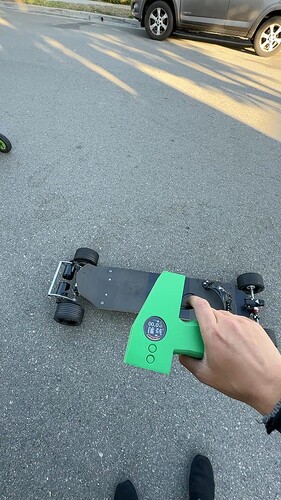

Where can this be bought?
DIY remote. Not sold anywhere. Parts include a standard VX4, a Molicel P45B, a GT3 trigger, and a 3d printed case.
Also would not recommend, it’s quite fragile and the trigger will act up on you sometimes
100 extra points for honesty.
