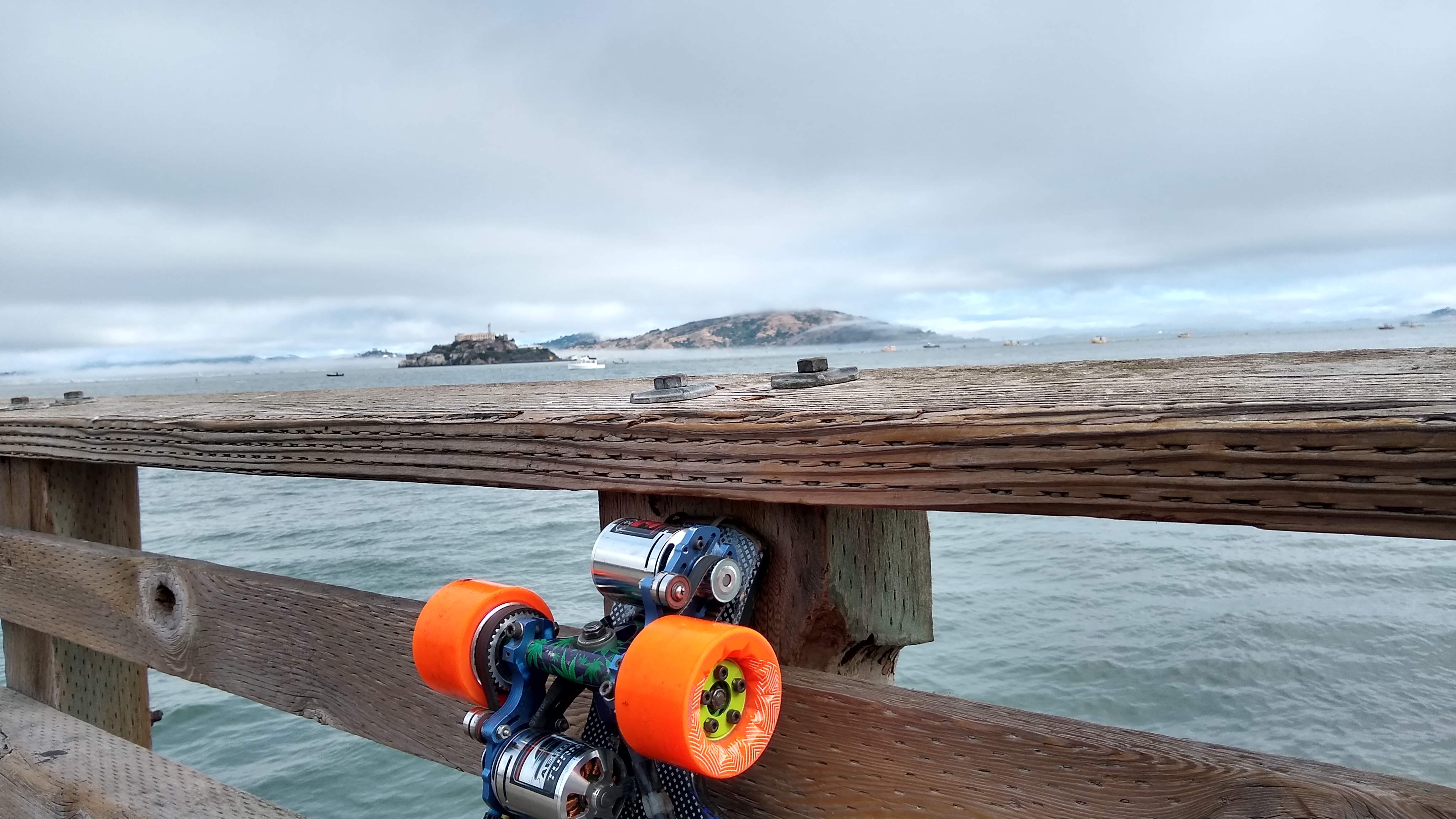

@BuildKitBoards the total length of the bearing is 7mm and 3.5mm is used on the lip and flange so 3.5 mm is in the wheel. So an extra 3.5 mm is used on the axle. Also now looking at it is bearing a bit of weight but not that the thickness of it matters as its essentially an extention of the wheels bearing seat.
Well, finished conversion. Tapped, drilled and done. Best part is being able to use Zealous Bearings and Paris v2 trucks.
Nicely done!
What’s the length of the bolts that you got?
Thanks, I just reuse the bolts from the Dickyho ABEC flywheels set I have. They are 2" or 50mm in length, not including the head.
I see I see :slight_smile:
I used 50mm bolt too but don’t seems to be able to use any retainer ring, seems like I need a longer bolt…
