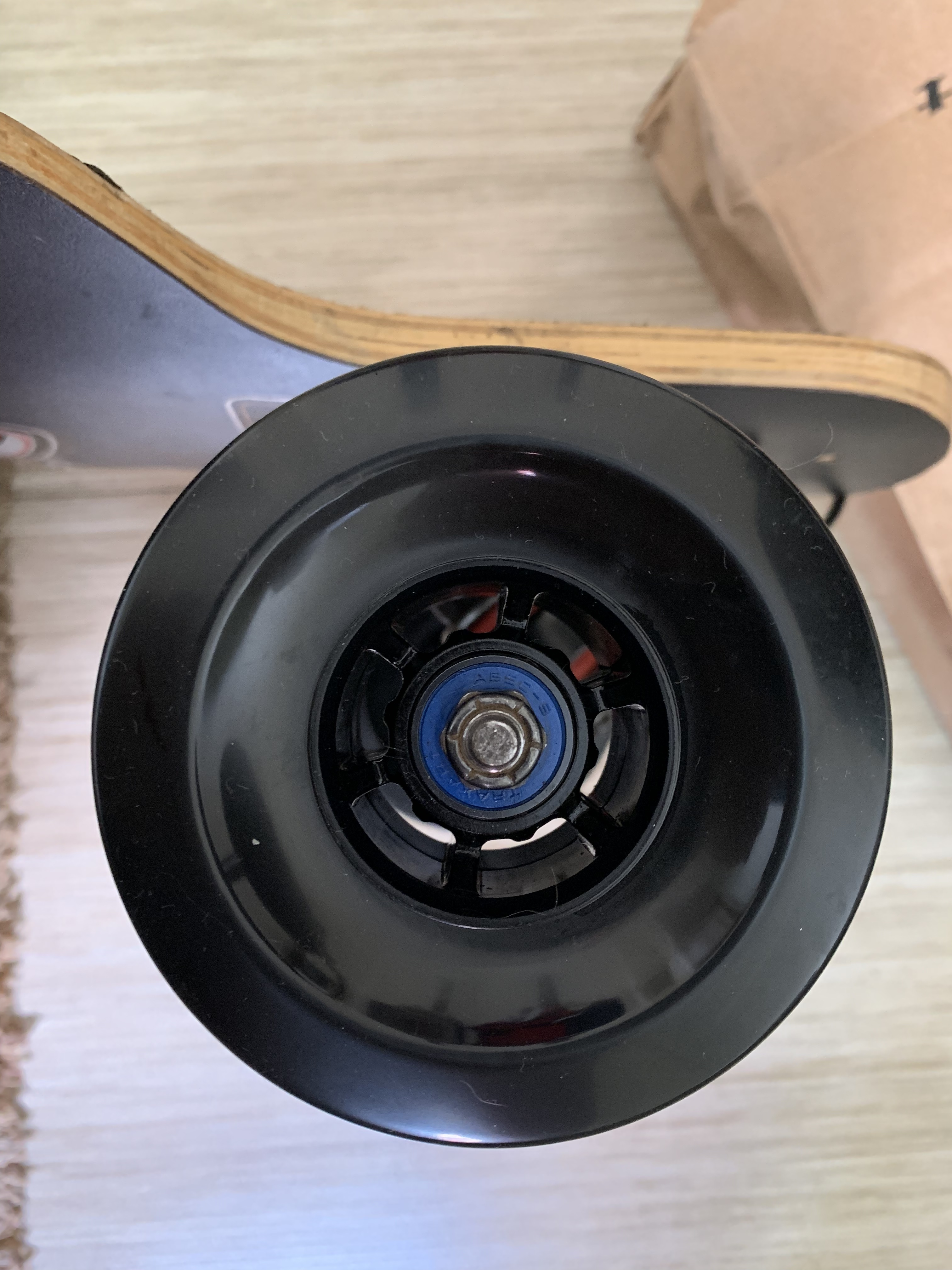

Is there a plate in there before the bolts or are they bolted straight into the core? I’d suggest a spacer.
I haven’t manage to get spacers for now, Dicky suggested the same thing when I showed him the photo :+1:
Is it recommended due to the vibrations causing the bolt to loosen up?
You just need to spread the load so that the core doesn’t get damaged.

Get a socket that matches the size or the outer race of your bearing. Pop the bearing in the freezer for 10 mins and then tap it in. Tap tap tap it in.
Share as in not overtightening any one of the nut over the rest is it?
I tighten them up until i feel a resistance and then go around tightening all 5 bolt a little bit more so I guess that’s even?

Tested out on a 20 km ride yesterday and none of the bolt/nut came loose so I believe it’s all good :+1:

Just to confirm the only thing keeping the pulley on the wheel is friction, right? Friction inside the hub and friction between the pulley and the bearing.
There isn’t an inner lip inside the pulley that the bearing can grab onto?
