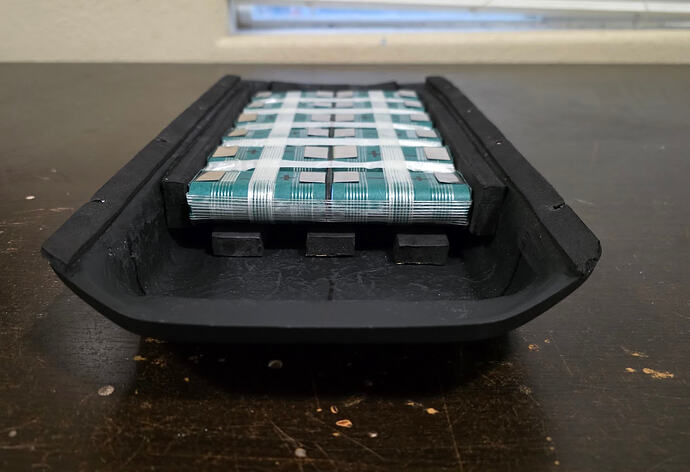

Welp… I’m starting to understand why this deck and enclosure combo didn’t work out for Ramm.

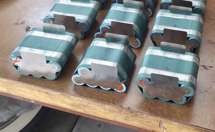

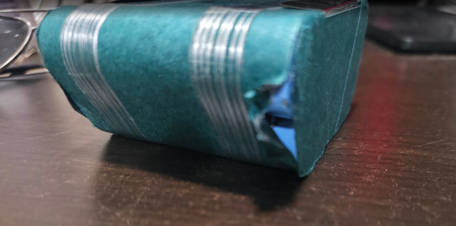

I welded the groups this afternoon and tried fitting them back into the enclosure. Still super tight. I pushed a little too hard and ended up ripping the fish paper and the blue battery wrap. I haven’t even had a chance to clear wrap the groups yet and I’m already damaging things.
I hate to admit it, but I think an 18s6p — or maybe even 18s5p — is going to be the better direction for this build. The other option would be taking a grinder to the enclosure, but I can almost guarantee I’d ruin it. I’m just not that skilled with that kind of work.
Has anyone successfully recovered cells after the tabs were already welded? I can’t imagine trying to cut a cell out would be a good idea with all the sharp nickel edges left behind. Can you safely grind down the leftover nickel, or am I basically stuck buying more cells?
I’d clearance the enclosure with a wet sponge wrapped in 220 grit sand paper and expend some elbow wrist and finger grease.
Dont pull apart those Pgroups.

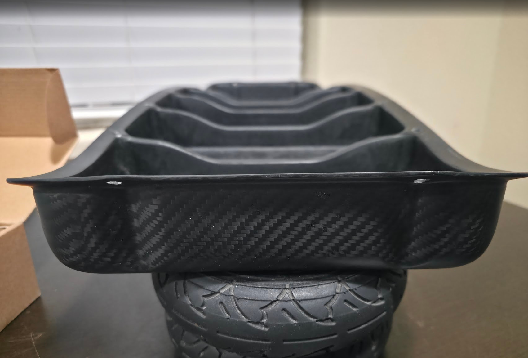

It would make sense to sand the enclosure down by hand, but it’s already pretty thin — basically the same thickness as that outer lip all the way around.
I am afraid if I sand it down, I’ll end up removing the fiberglass interior layer on the walls and would need to insulate it again with something anyway.
That is pretty thin.
Disassembling and cleaning cells of old welds and rebuilding is far more work than just building a new pack.
If sanding interior to fit makes it too thin, reinforcing the adjacent exterior is a possibility.

But I just can’t bring myself to touch this enclosure or cut back on insulation.
If this was something I could easily replace, I’d be way more open to experimenting. But I’ll probably never see another one of these enclosures again. I can buy more cells anytime — I can’t buy another enclosure.

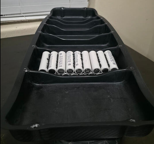

I made a cute little 10s1p of EVE 40PL. 0.2mm copper, dual 14 awg series connections ,XT90s on 10 AWG

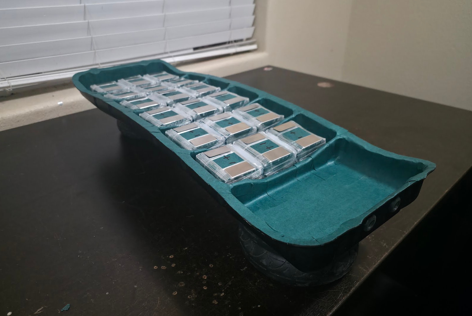

Got the new groups ready and taped the inside. I’m hoping I can keep the tape down by hitting it with heat whenever it starts to lift. But will look into epoxy/other options if needed.
This was really such a pain in the ass. At least I have something to work on while waiting for motors and BMS from China.
Worth noting that fishpaper is quite absorbent, i think wrapping it over the flange like that could introduce problems with water/damp ingress
Man, I honestly never would have thought of that. Makes perfect sense though.
That lip has been a pain in the ass anyway, I’ll scrape the tape off of at the edges, for sure.
Really appreciate you pointing that out!
Fitment of the groups is looking very good. I think you made the right choice :+1:
