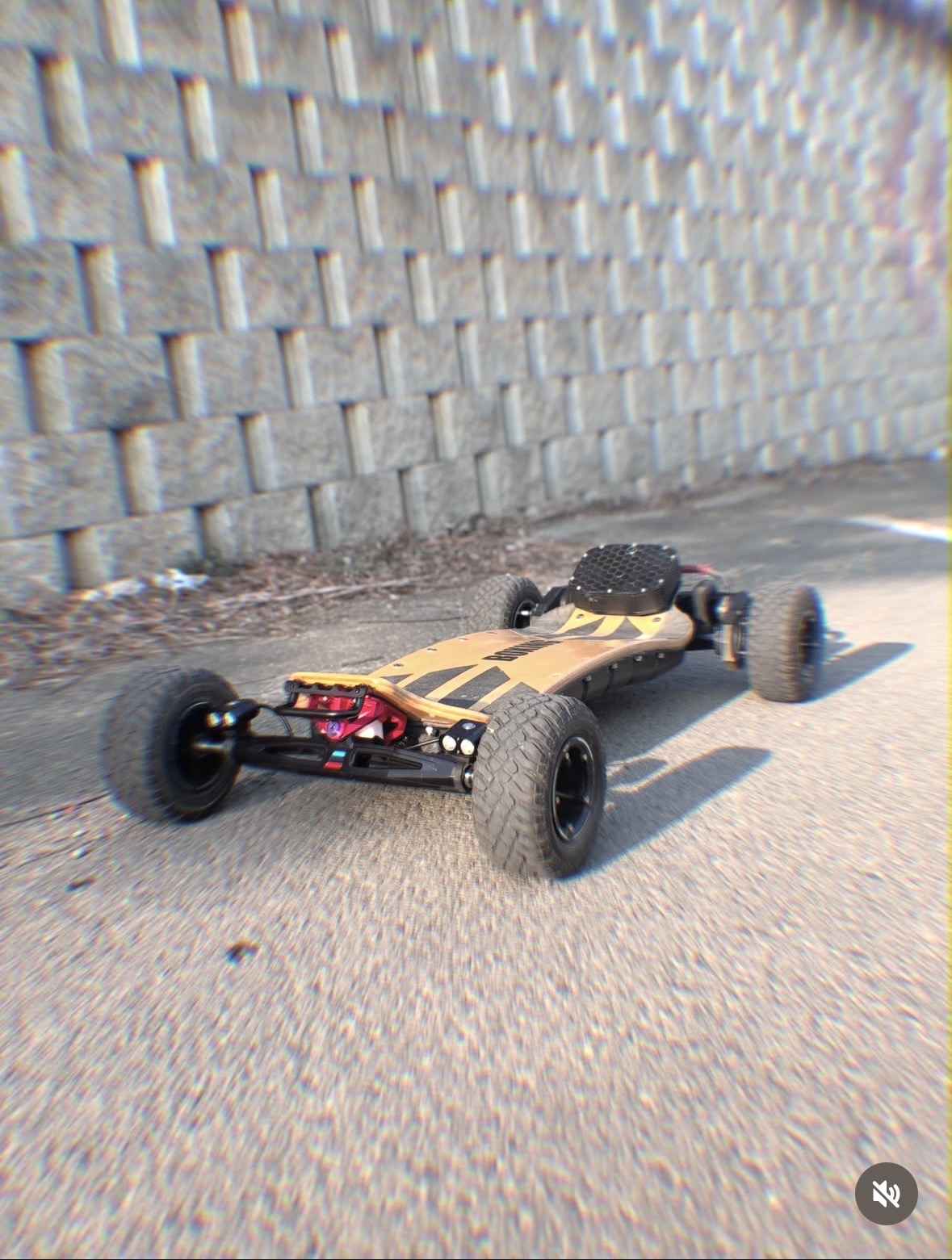

Project Redline - A Ramm Paragon build
Well… I’m pretty damn excited.
Finally starting a build thread for my Ramm Paragon — Project Redline.
Nothing crazy to show just yet, but parts are finally on the way and I’m pumped. Been sitting on the deck for a while waiting for finances to clear up, it feels good to finally get this one moving.
Should have some real progress pics soon.

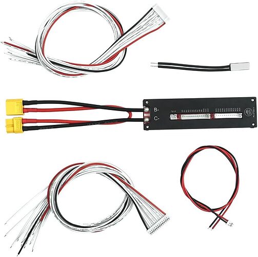

I have not personally used A ZBMS but I have one and plan to use it, I’ve seen others use it in their builds.
A bit limited on charge current but the BMS is pretty low profile.
Might be worth looking into
I haven’t heard of those yet, I’ll definitely take a look and keep an eye out for one.
Appreciate the suggestion, thank you!
The ZBMS is widely used in the onewheel world.
I have a Flipsky one in my pint
The ones from Joey Z are almost always sold out it seems
They are not a smart BMSs.. not monitoring. (I like monitoring)
That’s good info. I think I’ll have to stick with a SmartBMS. I’m not quite brave enough to run my packs without monitoring.

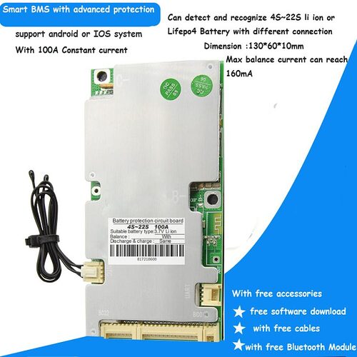

I’ve run a couple JBD/LLT smart BMS’ without any issues. I got one from JBD through Aliexpress and one from LLT from their website. Same product. This is the one I’m running in my newest 20S build…
Heck yes, that’s exactly what I was looking for. The only downside is the lack of built-in Bluetooth, but I can live with running an external.
Thank you!!! Getting one ordered now.
They will come with the Bluetooth dongle.

It has Bluetooth embedded, no extra dongle needed :+1:t2:

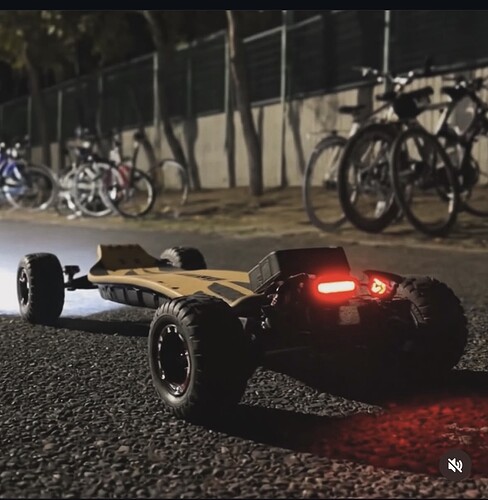

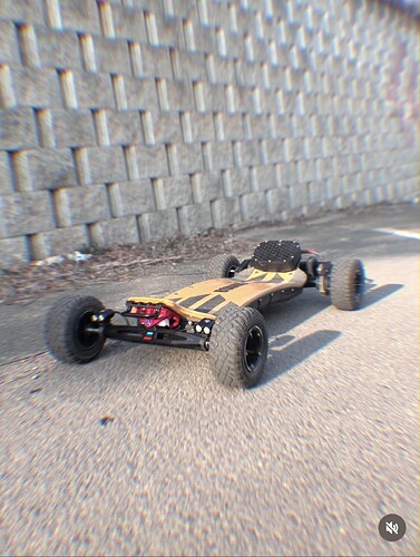

Always wanted to buy this deck and enclosure. Great to see this build coming along.
Yeah, I was insanely lucky to get my hands on this one.
Sounds like a few members had been searching for YEARS. It really sucks that they weren’t more widely available.

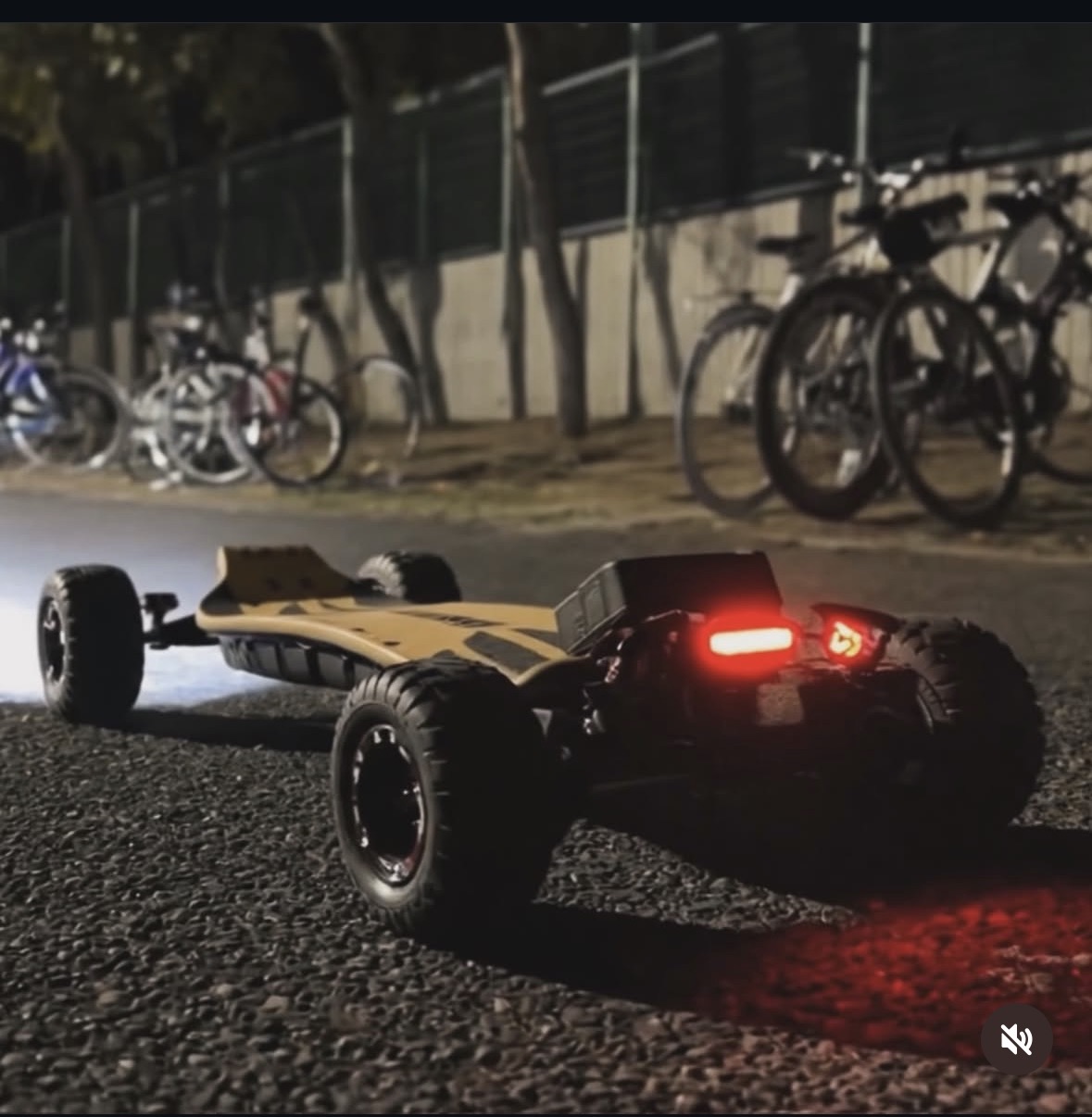

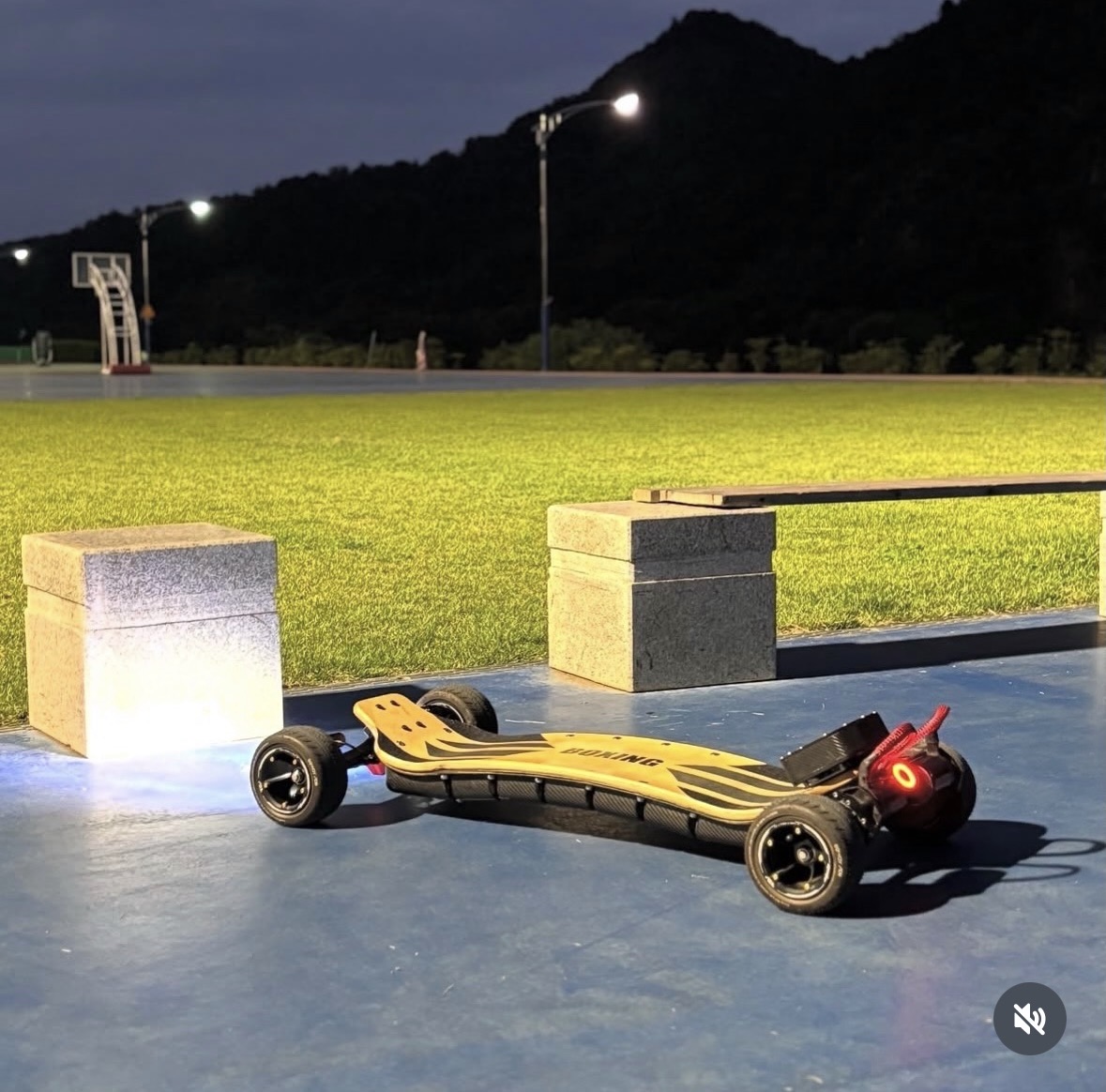

Good to see ur build. This is my own. The spec is the same with lacroix board.
Hell ya, I love it!
What size Novas were you running? How did you like them on the build?
