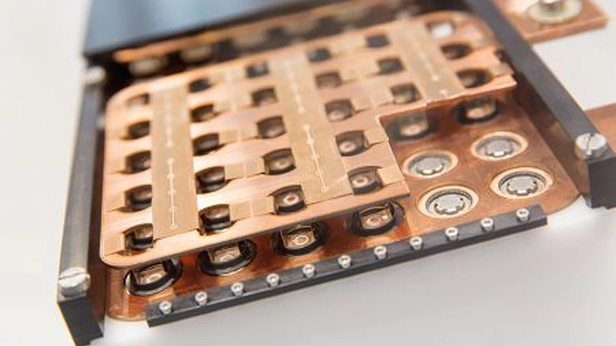

This is an interesting pack that uses large copper conductors to carry current, and uses small nickel strips to connect each cell to the conductor.

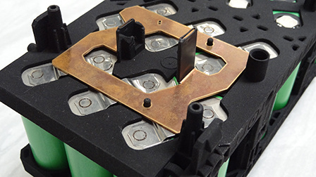

it also allows new pack construction methods where both positive and negative terminals are connected to the same end of the cell

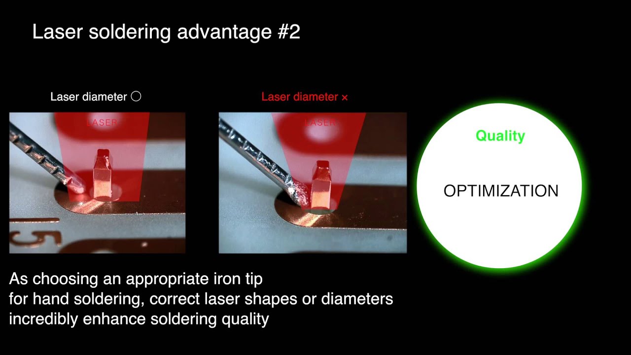

laser soldering is pretty sweet too
yeah. i think the process of laser tab welding is a little different but equally as awesome.
