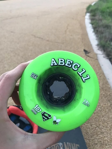

Here is another one for ABEC 11 wheel :
From the title said the bad bearing caused the melt core of wheel,it is more terrible but compare with Cloudwheel core,i believe the material Cloudwheel using was already top level,what do you guys think ?
I think :fish: Who are you?
I am just a Cloudwheel user and i love them a lot !! Just saw what you guys discussed here, i was worried about if the cracks happen to mine…luckily mine are fine ,however i did search a lot about similar cases exist before,interested in this topic and that’s why i am here,so what about you,mate ?
I think the extra material will still help against catastrophic wheel separation. Even if the 5 spokes crack, a solid filled core will have to completely separate, otherwise the problem can be caught instead of catching by surprise
