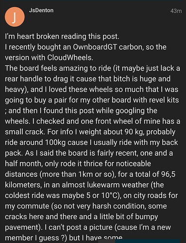

Problem with Slick Revolution/iWonder Cloud Wheels (SERIOUS)
Is it a standard value on a skate wheel?
On my mtb wheels, it’s around 25mm
When the diameter of wheel increases, “leverage” on bearings increases also, so it’s better to have more distance between bearings to compensate.
Also larger wheels means faster ride and better grip so horizontal loads also increase…
The distance between bearing seats is Standard 10mm on all the Longboard wheels I’ve had
I just remember than when powerkiting began (with more horizontal loads and milage compared to gravity mtb), mtb brands had to use stronger wheels/bearings…
It’s a bit similar to what might happen with larger diameter wheels on Esk8.
Bearing seats and spacer also needed improvement.
I’m sure there’s a physical limit on the diameter of a normal skate wheel before everything goes south, your suggestion is seems to be about right. at 120mm dia, the threshold is probably at its limit.
sadly, when you increase this distance, you also increase the leverage on the axle sticking out of the hanger…
For mtb, we switched from 10 mm to 12 mm axle.
I want to cast wheels in the design of those Iwonder does anybody want to sell their 2-3 leftovers? Just for the front wheels and the mold…
One of my Zealous bearings I had taken out of the cloud wheels was totally seized up.
I can’t say for sure it was from the front wheel that broke.
This… and those short sprockets we constantly use, may cause (by overpressuring) the bearing seat inside rings to break.
