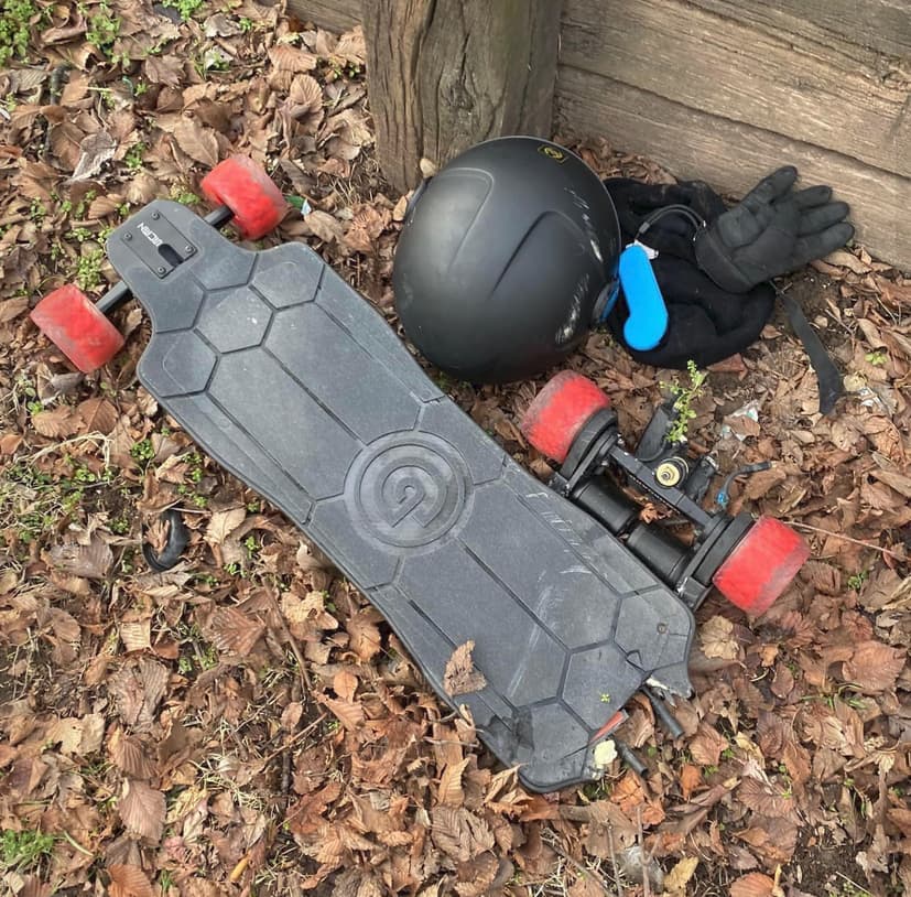

caused by a crash/car running it over.

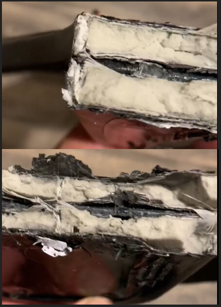

Interesting to see the insides.
Source Facebook
nice foam
Makes sense, foamfill carbon fiber layup is very common.
Cool look
Glad to see they have a thicker layer of carbon fiber compared to the BS Backfire had on theirs.
What are you planning to do in terms of repair with that beside the bent connector and broken deck, is everything else salvageable?
Looks like the Deck and connectors are the only thing damaged. Truck probably as well. Haven’t gotten any more infos about it.

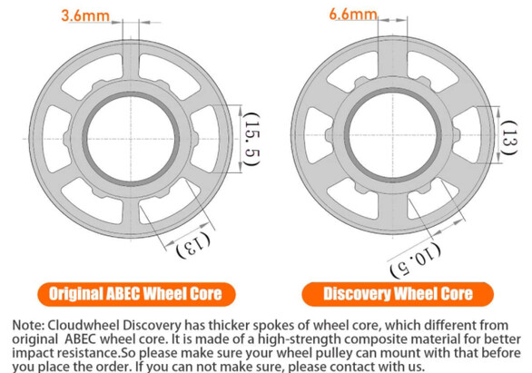

Here’s the measurement s for the “Discovery” cloned core
for the other specs, go all the way down on the link, that should help right?
