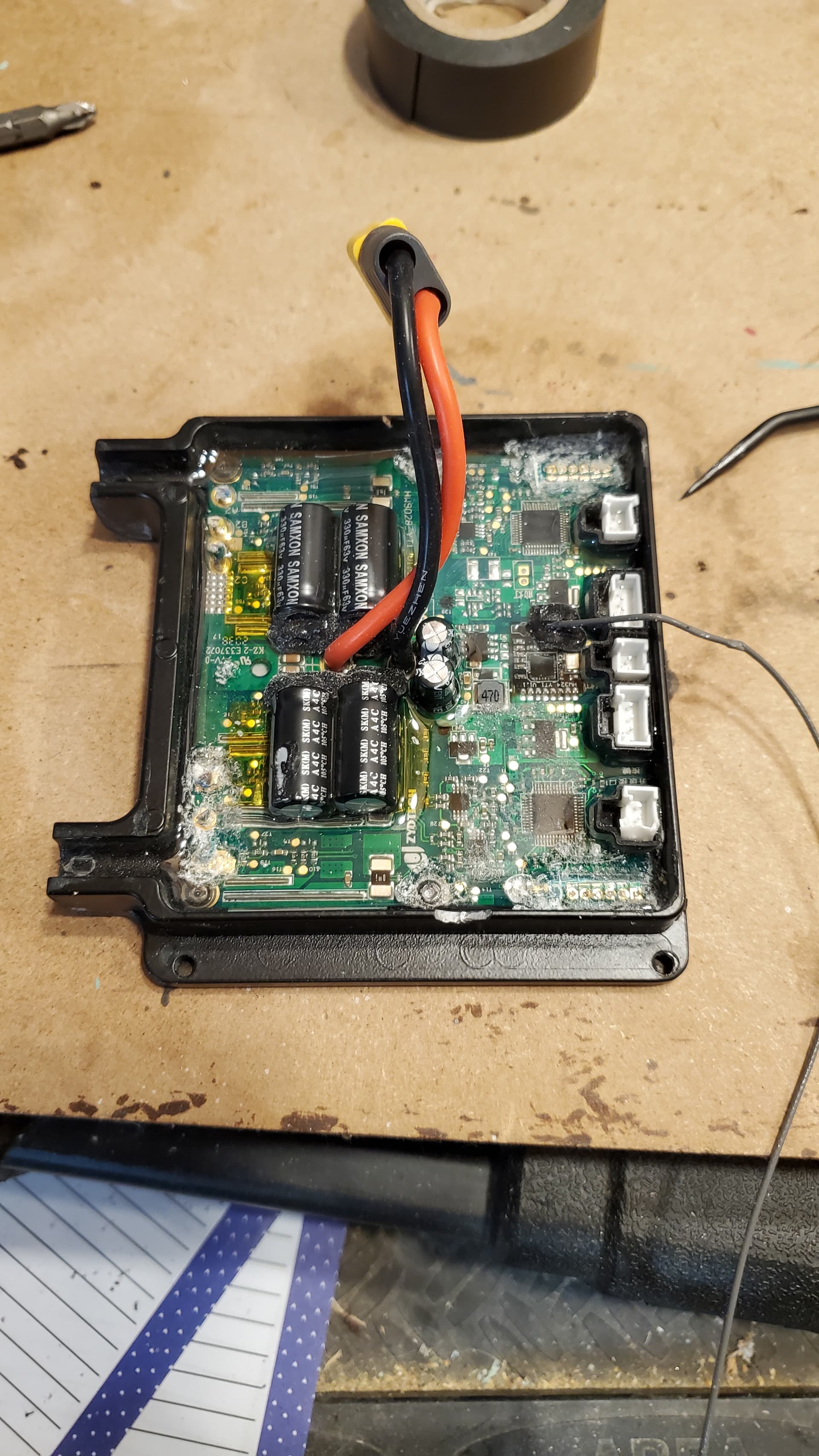

Getting that esc un-conformal coated was a real B word.

How’s the performance with the esc upgrade?
Fantastic but the bms is NOT bypassed on discharge so it blew about 10 minutes in and now needs replacing :expressionless:
I’m guessing they have it limited to 60A and he told me 70A.

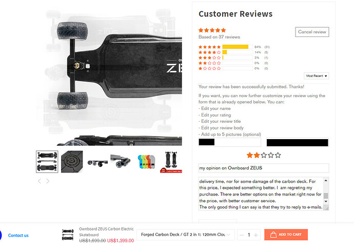

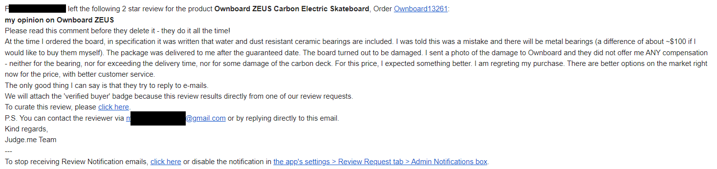

Something I’d like to share with you. This is a comment I left on ownboard website (it was never there. It was deleted probably in a few minutes by a ownboard team) This is the email I received after posting the review. I give them only 2 stars.

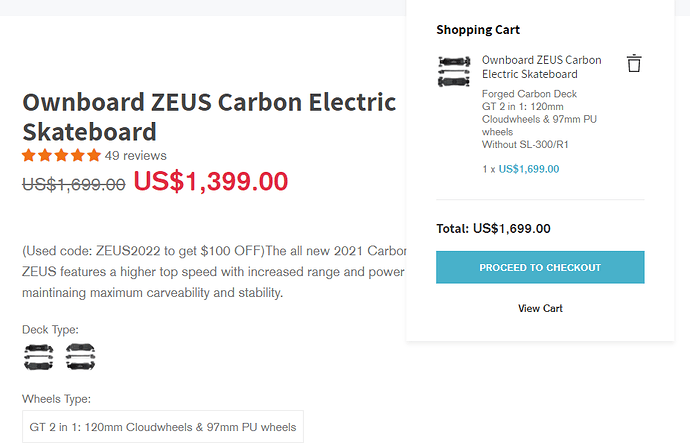

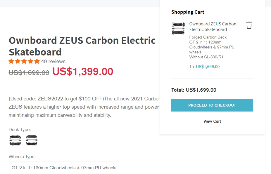

I was seriously thinking about getting it, I’m a sucker for CF and now the forge CF. But I don’t think the $1,399 price is correct anymore. It shows $1,699 in the cart
