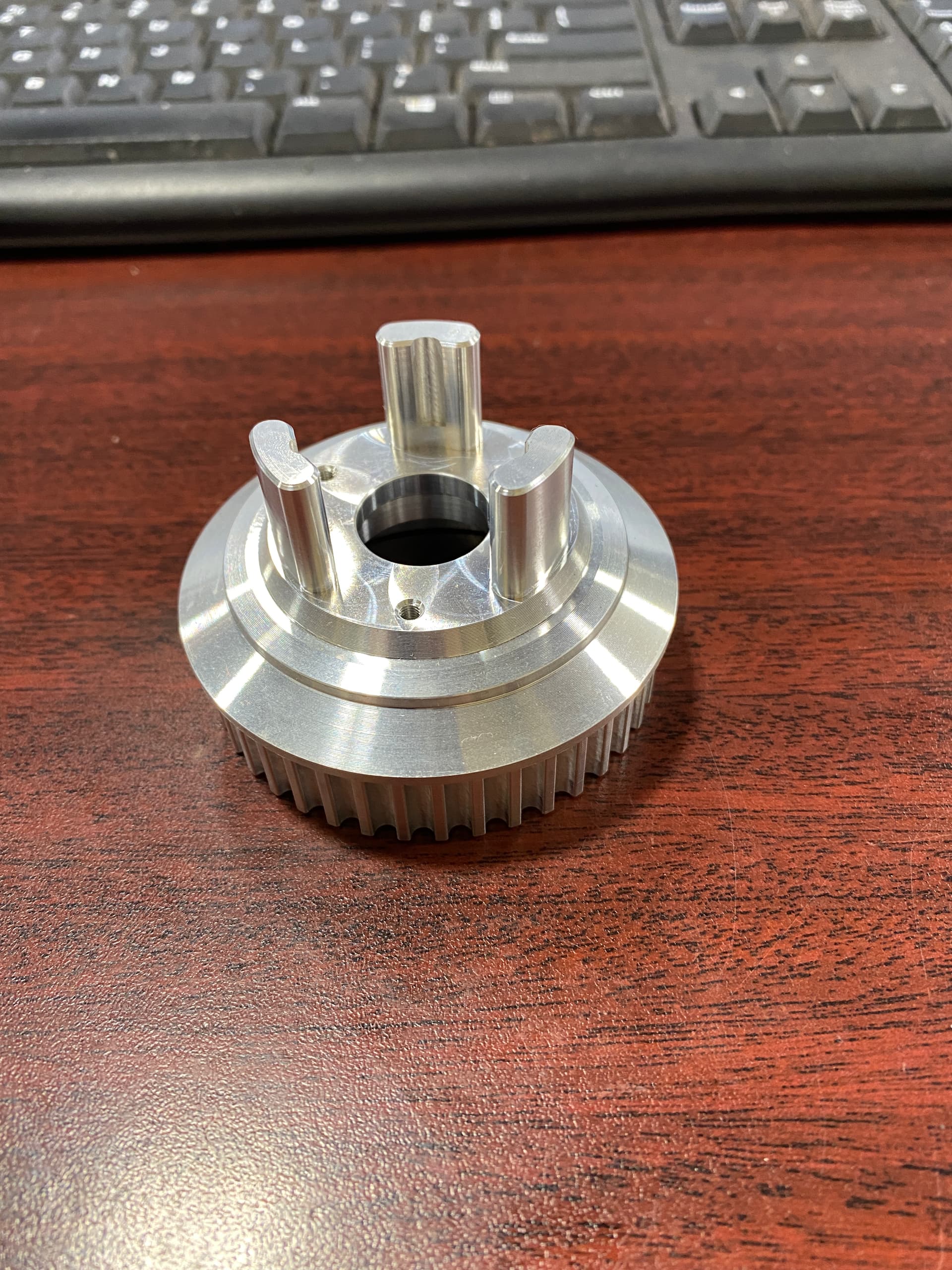

Well that’s nice! That would’ve saved me a bunch of time when I made these…
should be an easy adjustment right? just take off 1.5mm on each prong?
ya, very easy. Would for sure want to test fit though. (press fit with a bearing)
48T for the 120 cloudwheel is the perfect sweet spot for the zeus.

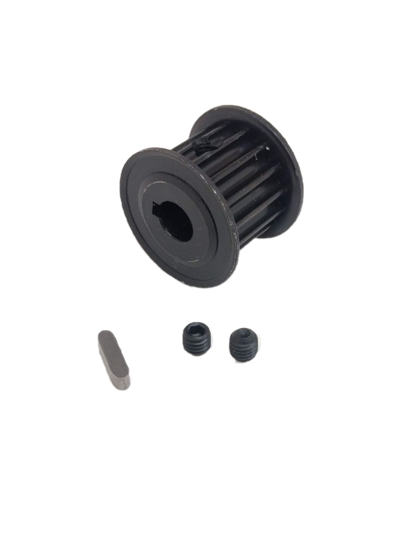

guys ! i ordered those: Motor Drive Gear – Vestarboard
13T instead of 15T (oryginal). I will have them soon and tell you if belt is slepping on it or not. Hope it will fit. It will decrese max speed to ~53 km/h and increase torque a bot. Will see the resoults :slight_smile:

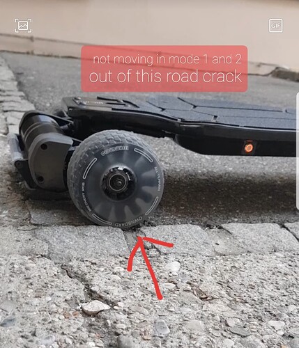

Hey, I feel exactly the same about the Zeus brakes. But also have another issue with it. Mine has almost zero initial torque in mode 1 and 2…I can’t get it rolling on a carpet out of a small road crack…etc…
It’s really strange.
20220128_212936|429x500
Have my ears on standby about that :v:I have a feeling the angle on the 13T in combination with the 44T is a bit much, was looking to find a 14T but no luck…
I think a great combo would be a 13T / 40T / Meepo Cyclone 110mm Wheels.
