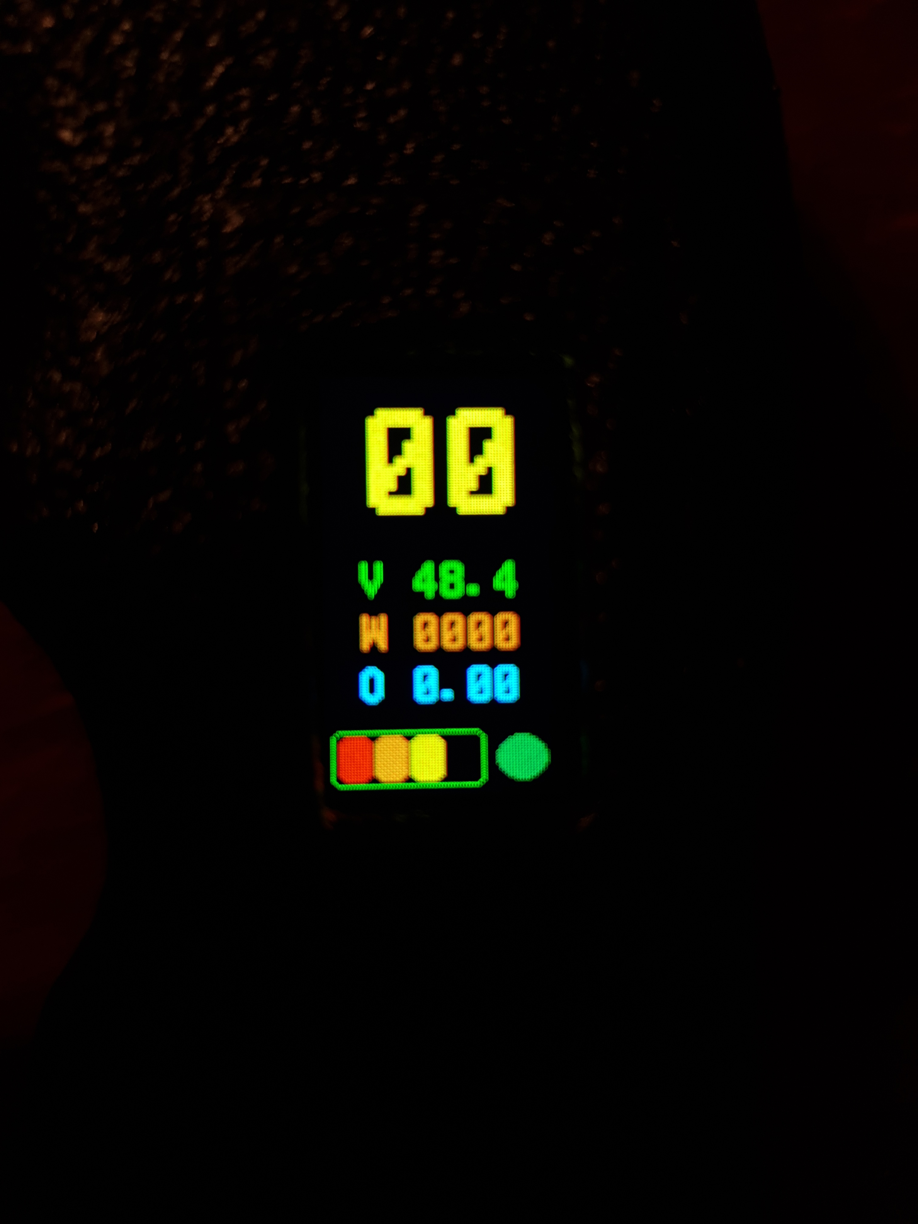

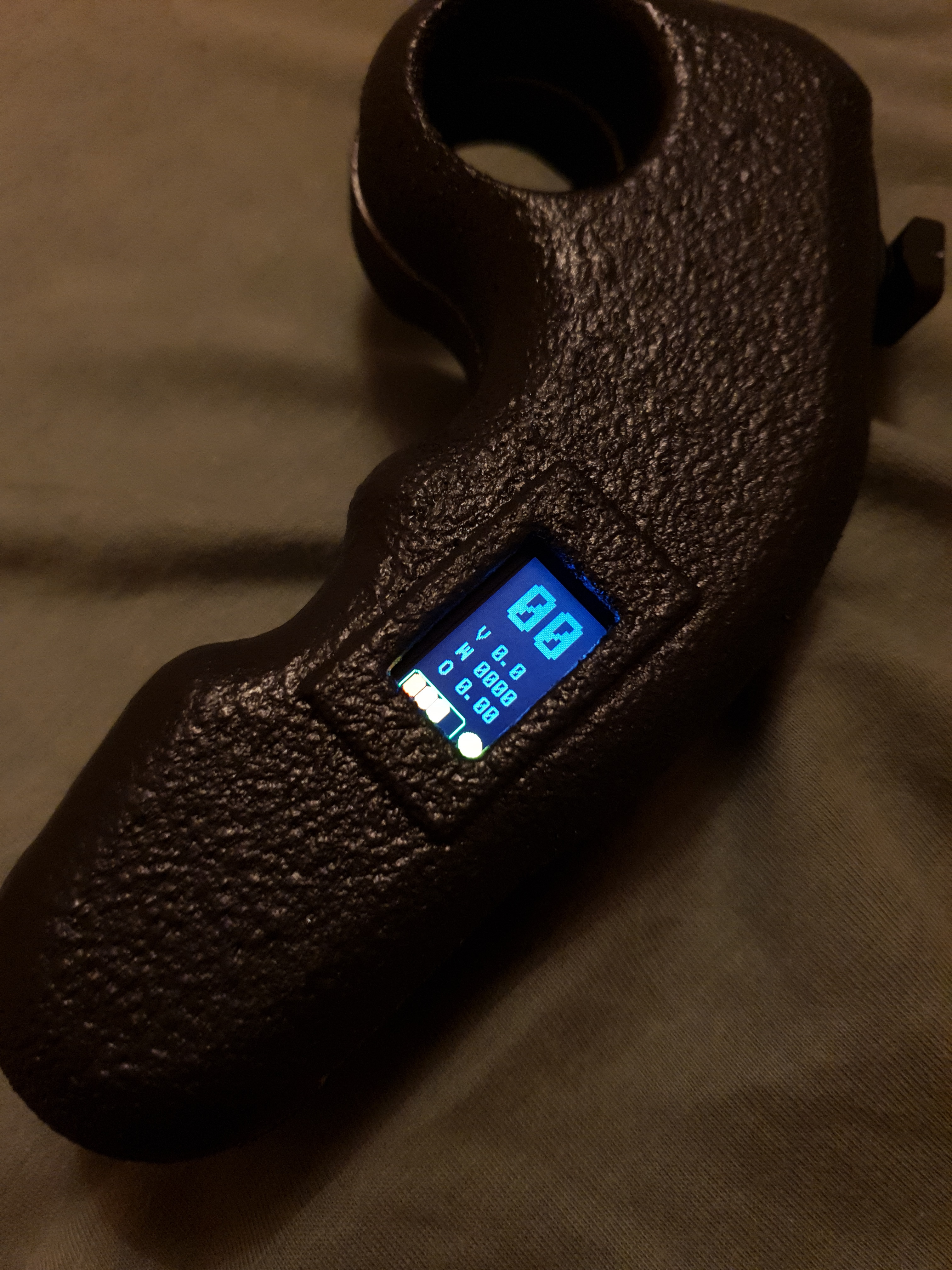

Funny how cameras cannot seem to capture that LCD display the same as it shows in person.
I tried hard with pro mode on my phone but still not quite :upside_down_face:
You captured it quite nicely!

this is because if the polarizer used on the display.
