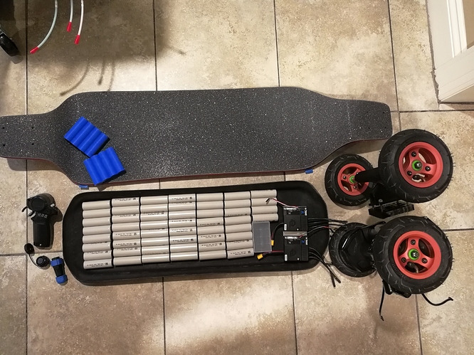

Oh boy this is my first build thread. Preliminary stages for now. Gonna be mostly photos until the build firms up. I’ve got almost everything in hand. Drives are in customs.
The heart of it:
  • Subsonic Century 40 + eboosted enclosure
  • Molicel P42A 13x4
  • nuttyjeff AVIO mk2, haggy trucks, bergs
  • no bms
Undecided:
  • escs
MK1 drives standing in for this photo.
Thanks @avX @haggyboard.timo @eBoosted @Bradley @KfromtheBay
Lots of photos coming!
Parts (sigh gonna take photos of all this shit)
  • board
    • deck + grip
    • enclosure
    • gasket
    • inserts + screws
    • truck mounting hardware
    • velcro, dual lock, VHB tape
    • option: handle
  • battery pack
    • cells
    • cell insulator
    • hot glue
    • fish paper
    • nickel 0.20 25mm
    • corner chomper (on order)
    • welding jig
    • welder
    • series silicone wire 14awg or 12awg
    • 10awg main power leads (maybe 12awg x 2)
    • balance wire 22awg red and black
    • jst xh terminals
    • jst xh 14 pin housing
    • jst crimper
    • kapton tape
    • filament tape
    • heat shrink for p-groups
    • abs sheet for p-groups if have space
    • 120-160A fuse
    • 13 x p-group fuses 3a
    • big ass bullets
  • electronicals
    • SP20 14pin balance points
    • SP13 2pin charge port (on order)
    • 10a charge port fuse
    • escs – options: focbox, escape, unity, neo6
    • NO BMS
    • probably as150 loop key, will decide late
    • cable mgmt
    • remote (probably @dani chubby, waiting on pots and lipos)
  • trucks drives wheels
    • kahua trucks (delivered)
    • option: ~40deg baseplates (deck has +10 -10 wedge)
    • avio mk2 (delivered)
    • bergmeisters
    • spare wheel (delivered)
    • slime (need to order)
    • risers
    • bash guards (to be printed)
    • oh hey I forgot motors, psychotiller maytech 6369 200kv
  • outboard
    • smartbms with display in enclosure for quick portable voltage check
    • smart balancer 2A for maintenance
    • charger

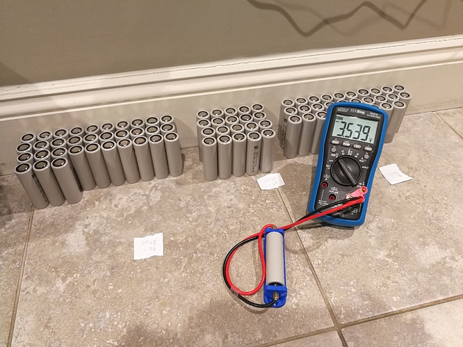

Thanks @janpom. I want it, but it’s a little expensive for me, and not so available. And a bit too new – for BMS I want to get in at version 1.0 or later. :slight_smile: Almost 100% what I’d like though. @DerelictRobot make your version soon!
For convenience, I think initially I’ll check balance before and after rides and charges, but after I understand how it’s behaving, most likely I’ll charge to 90-ish percent, discharge to like 40%, and balance once a month if that. Mostly just ignore that it has no bms. :slight_smile: My main ride has gotten this treatment, so nothing new to me.
