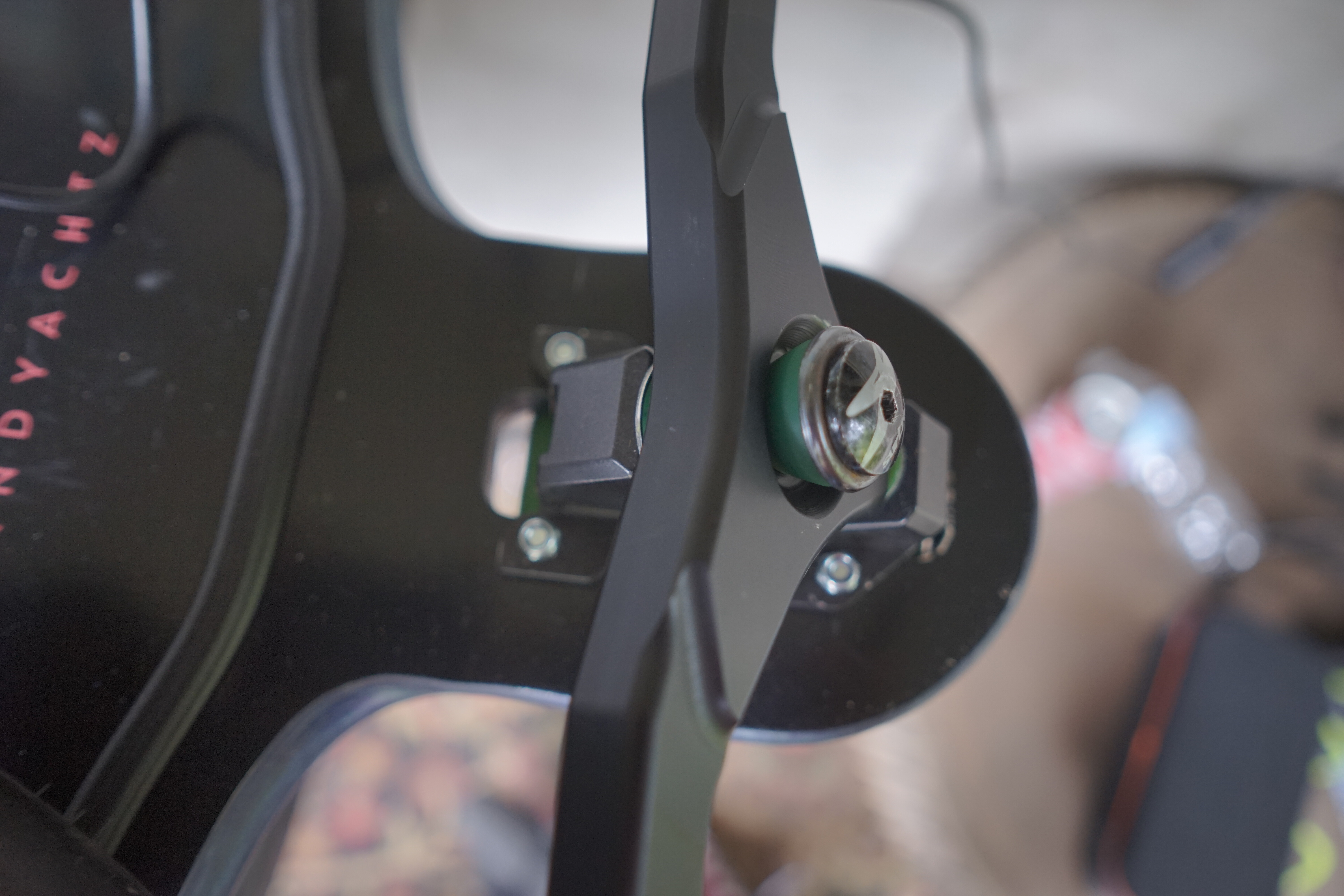

Looks so good. Would love to see a pic of how close the motors sit to the ground.
Or maybe I’ll just wait to see it this weekend :slight_smile:
Bad with wet feet, pretty good with dry feet :slight_smile:
@monsterbuilder will take a picture tomorrow for you. Answer is: too low; they’re getting badly scratched already :confused:

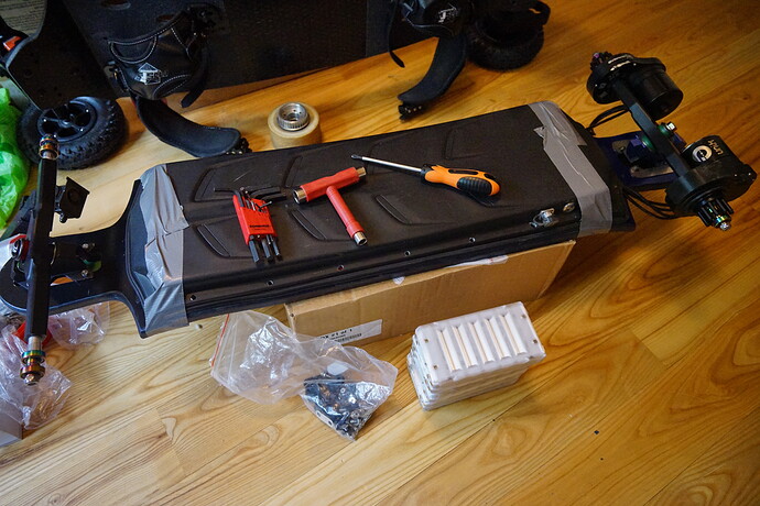

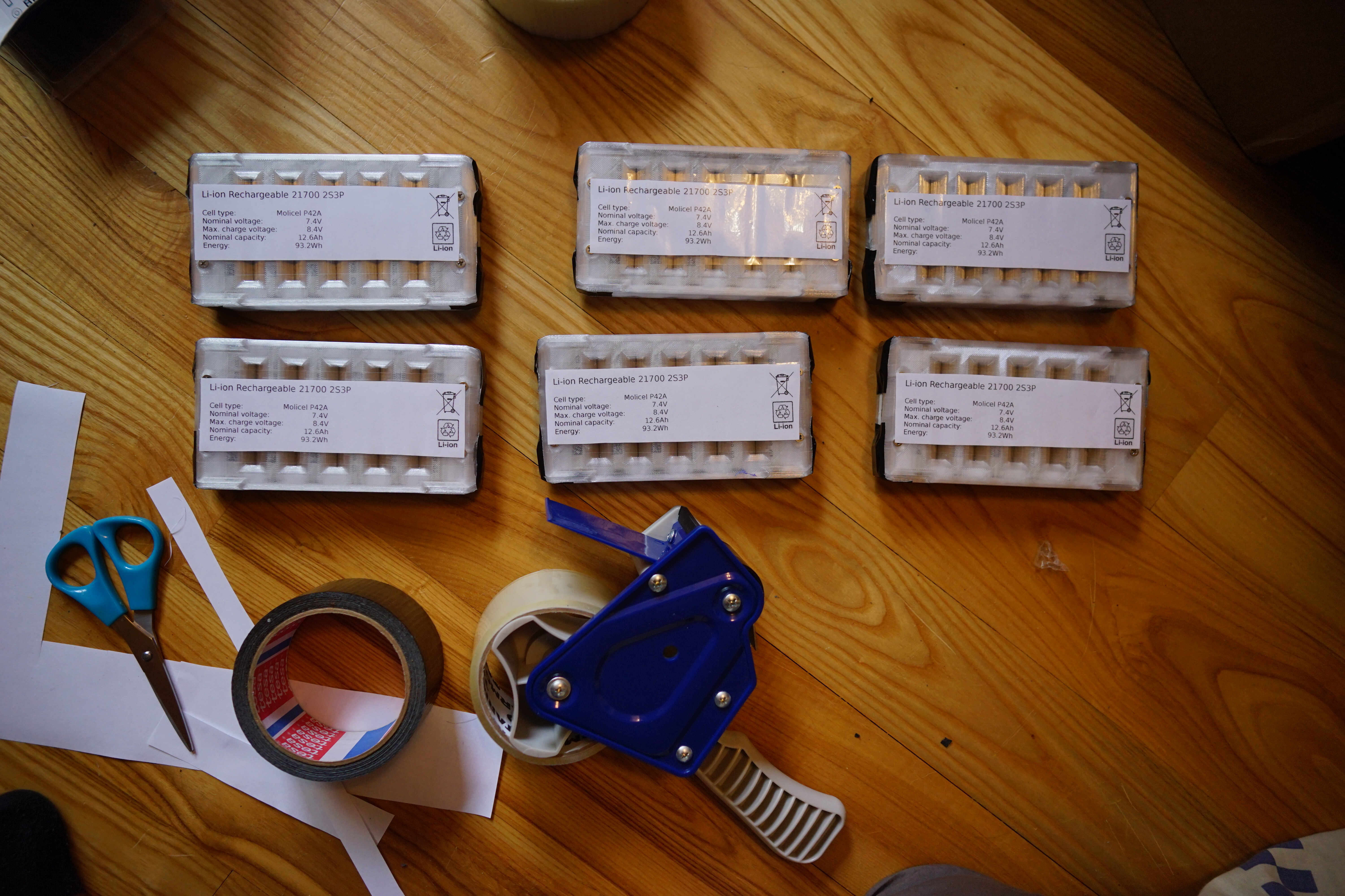

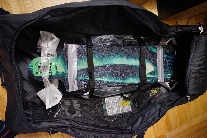

Undid the bolts. Disassembled the NESE modules. I’m bringing with me a skate tool, set of allan keys, and a screwdriver for the NESE bolts. And blue threadlocker. All the bolts are in a zip-loc bag. Threw in some foam, and used duct tape to temporarily keep the enclosure in place.

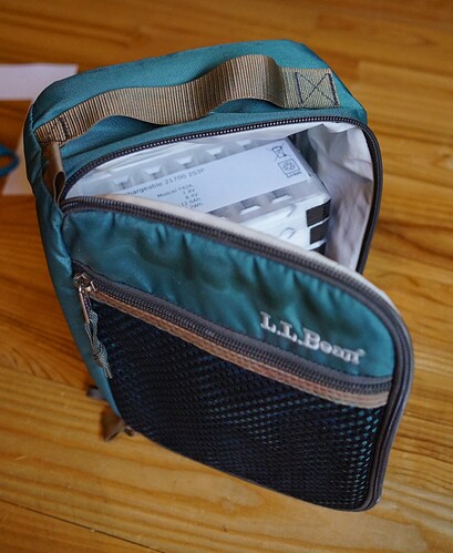

I printed battery labels for my NESE modules, and taped the terminals over with duct-tape.
They will be sitting in this soft lunch box, along with some of my camera gear to blend in :slight_smile:

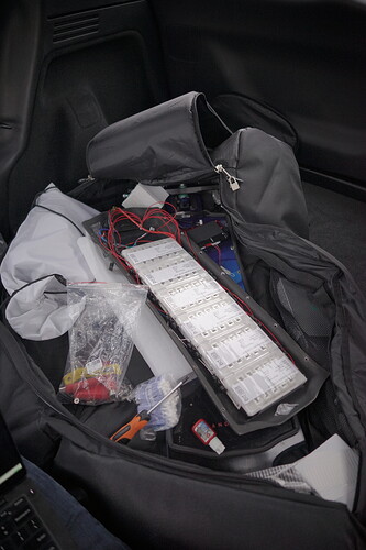

For the board itself I have Trampa’s luxury travel bag for 35 degree mountainboards. All the walls have soft cushioning, and the inside pockets store my charger, tools, gloves. Beneath the board I have my Knox Urbane Pro shirt / jacket, and I’m using some foam blocks to protect the trucks at the moment while the wheels are missing.
Plenty of free space for some clothes, and all the esk8 parts I plan to bring back with me :grinning_face_with_smiling_eyes:
I carry my TSG Pro helmet in its helmet bag, as my one personal carry-on item.
Hopefully my next update will be me assembling the battery again in the US! :us:
At a target parking lot, I assembled my battery with blue threadlocker on all the bolts

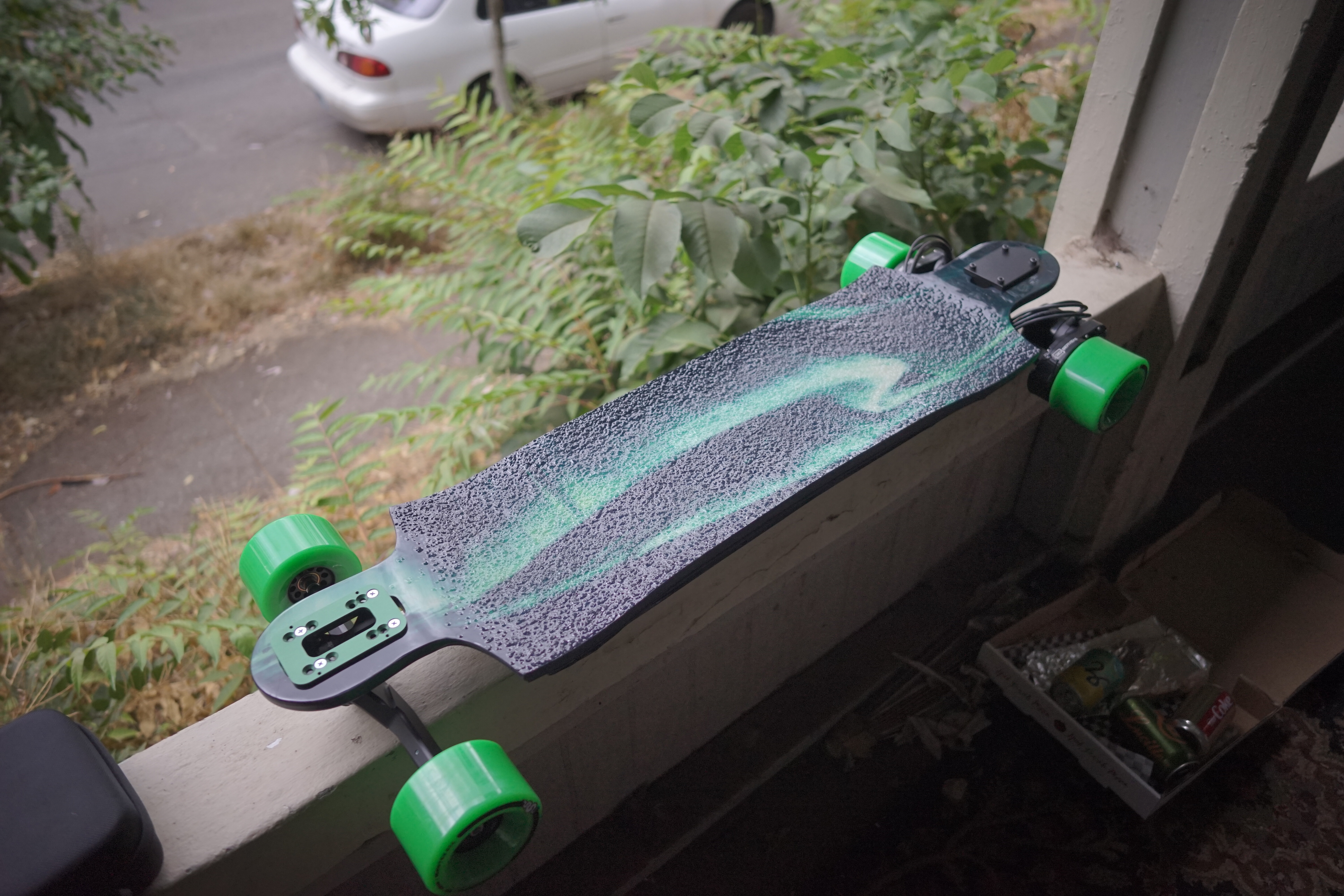

Green wheels didn’t need drilling! :smiley: Although one isn’t on quite enough I think, but very close. Hammered the board against the railing there, lol. The green really pops, and completes the board’s look imo :smiling_face_with_three_hearts:
Also, I should probably be more careful. Already had like 3 close-calls today
