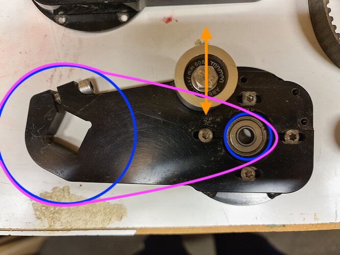

I make my own motor mounts from aluminum with lots of filing drilling and jigsawing.
Can I add a belt tensioner and have it be my only form of tensioning?
Im thinking of having it slide up and down, and placing the motors at a distance where the belts would normally slip on hard braking. This would be a single easily adjustable point to tension and detension belts . Im thinking Nordlock washers and a pitted aluminum slider surface with the M6 tensioner kit trampa offers should work. My 63100 motors slide down despite loctite and very hard tightening after around 150mi and thats almost every other week when I am here in college.
Alternatively I could place a variety of holes at different heights where the tensioner goes in and will never slide, it could only bend if the forces are actually that high. Thats what I am wondering, will a tensioner be under that force or can I try something like this?

Boardnamics idler motor mounts work in the sliding method you’ve described. That should work. (If I read correctly lol)
