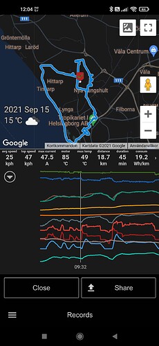

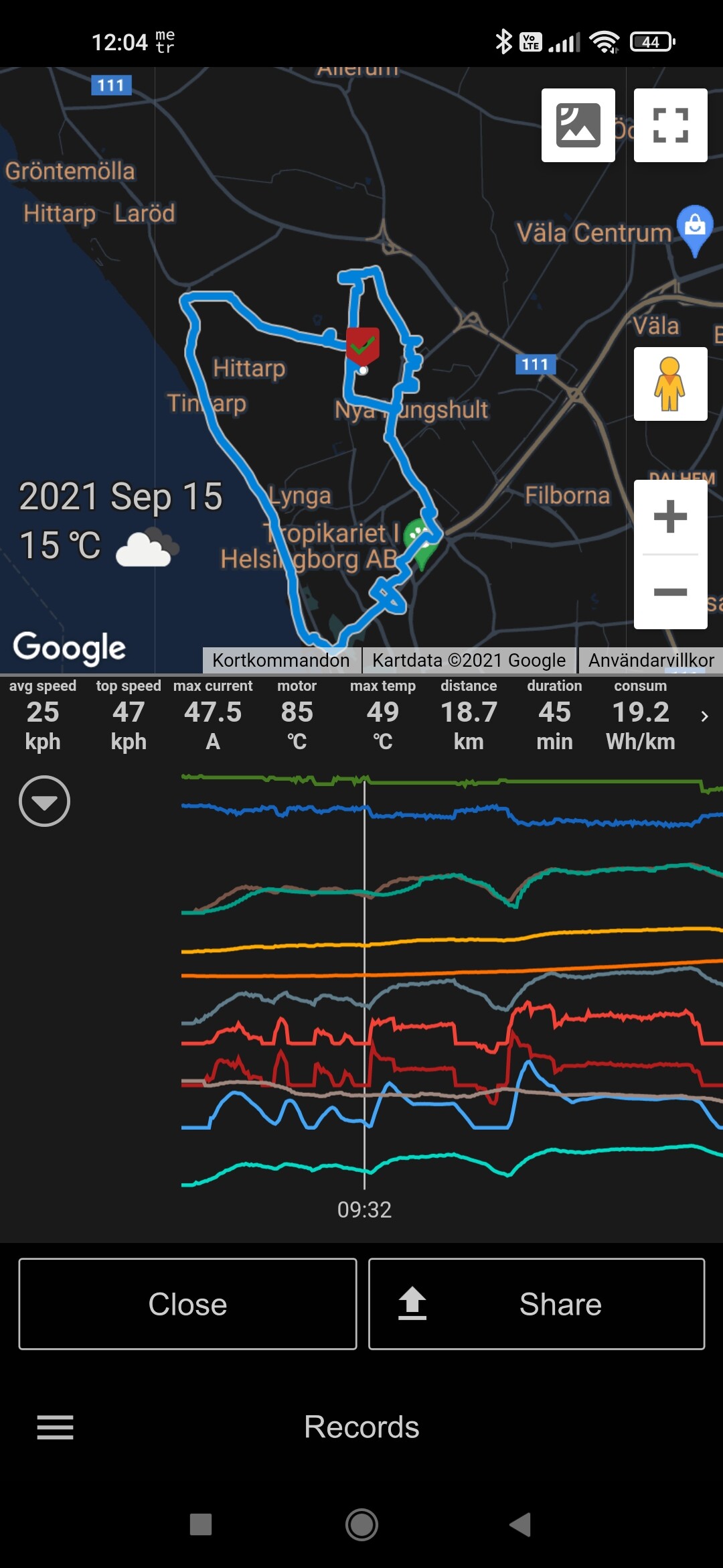

Is it normal with a 19-20Wh/km consumtion?
Is it because I carve to much? :joy:
That’s high for a 'thane board, but normal for pnummies.
Higher speeds, more carving, bigger/softer wheels, all can contribute to higher consumption

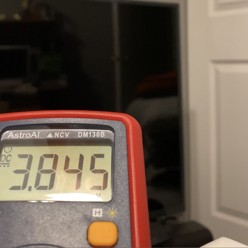

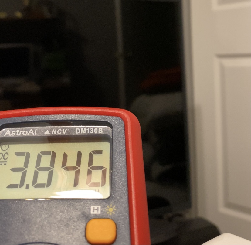

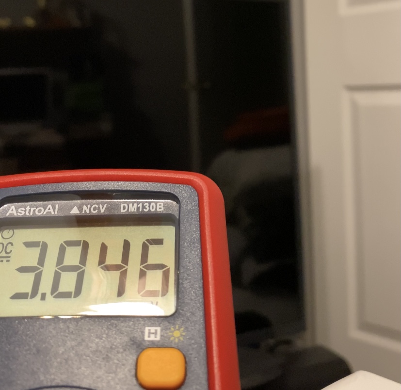

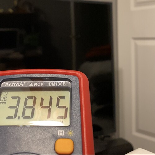

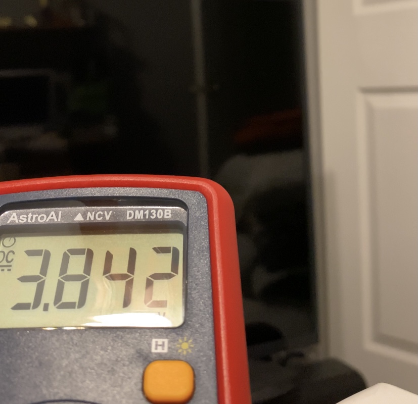

So just got my multimeter and decided to check the lipo that I mistakenly kept the balance extenders in and cut all the wires at once, this was a while ago. But I tested out the cells and they end up in 3.846 or 38.45 range, the last cell (5th cell) ends at 3.842. Is that normal? The cells seem to increase as I just check in general
Also just for kicks tested the second lipo, they either are in the 3.846 or 3.845. 5th cell ending at 3.846
(P.S) The total voltage for both of them end up in 19.2, exactly the same
That’s within 5mv (0.005 volts) difference between the lowest and highest. That’s more than close enough in my opinion.
So your saying that it’s good to go
As long as you are within .05v, you are fine. Once it goes over .05v, start doing something to rectify the drift.
i’m getting between 16-18wh/km on pneumies. If you are on grass, gravel etc that will impact it a lot.
The rest of the cells are within .01 or .02 that’s the only one I was worried about since that incident so glad that it’s good to go
All your cells are within 0.005, which is ten times smaller than 0.05. 5mv vs 50mv
Ah ok, I understand what your saying now. Thanks for the clarification :+1:t3:
