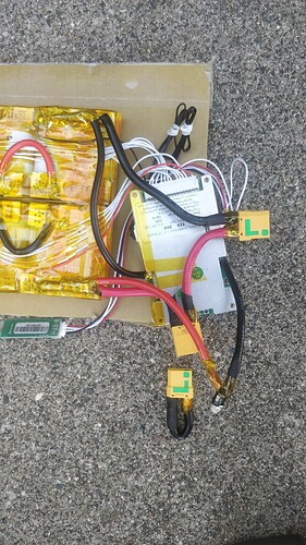

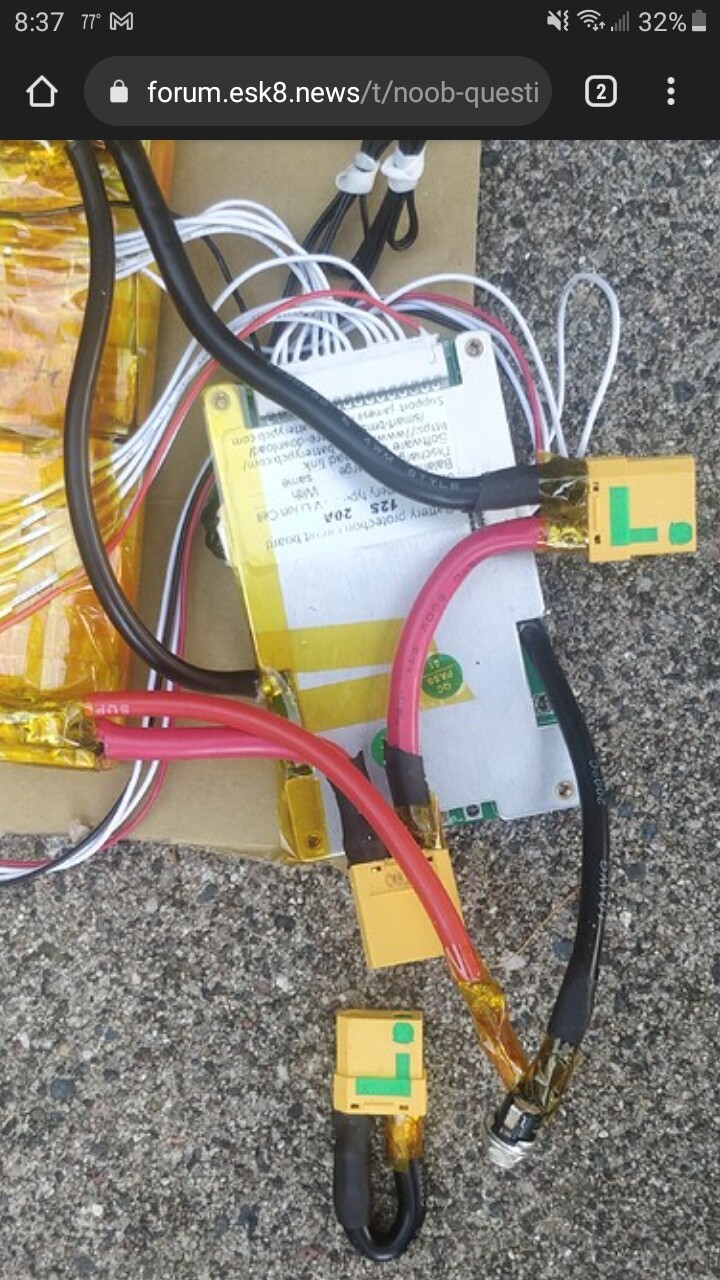

It would seem that today is just not my day. I’ve been trying to get my pack to charge, but it doesn’t want to comply. I believe I’ve wired everything properly, but I’m unsure.
(Forgive the excessive tape and ridiculously oversized charging wire)
Any suggestions? My battery minus is wired to the B- of the BMS, and the negative of the charging port is connected to the C- terminal. The positive of the port is connected to the battery positive. Also, the Bluetooth is working and displaying all cells correctly.
I did not get a reading from the battery positive and the C- terminal. I would imagine that this is the issue, but I don’t know how/if I can fix it.
Check the voltage of the charger output. Check your charge port for continuity.
Oooo! Close up picture of your charge port with out the tape.
It’s hard to tell through all the tape and whatnot, but it looks like you may have the charge port wired backwards - The center pin should be positive, and the outer ring should be negative.
Also, jesus help you, learn to cut heatshrink tubing with a pair of scissors. That way you can have properly insulated connections without covering them in Kapton tape. It’s not designed for that, and it looks like ass.
Figured out the issue, my charge port fuse was defective, or I somehow managed to blow it up without noticing. :man_facepalming: And yeah @MysticalDork it looks horrid right now. I’ll fix up the situation once I’m 100% sure it’s working. Thanks for the advice @J0ker !

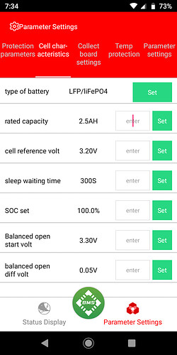

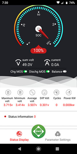

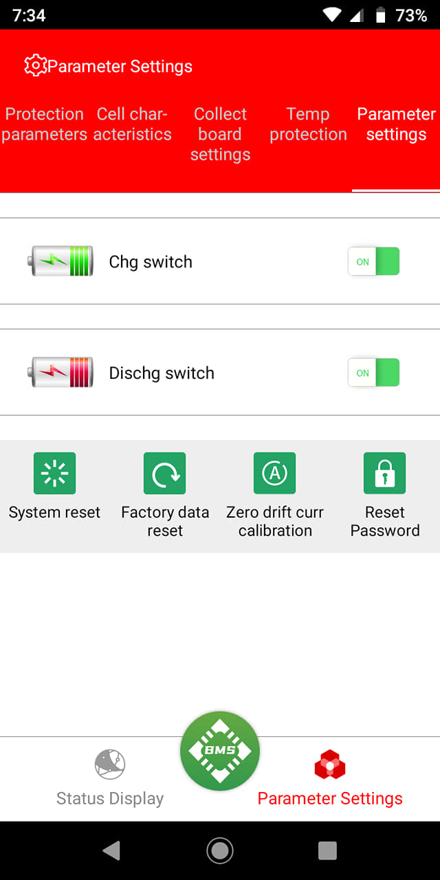

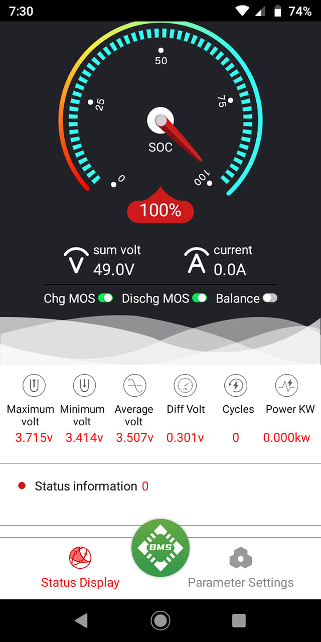

Need Help: My Smart Bms doesn’t seem to be balancing even though I can view the cell status on the app. I have a 14s (51.1v fully charged) lifepo4 pack 3.65v/cell but I i changed the settings in the app to have a max cell of 3.5v/cell because the bms was apparently not working and allowing the 14th cell to go all the way up to 3.8 volts and no sign that the bms was balancing the 14th cell would just stay in the 3.8v range and go up a little bit, go down a little bit. The other 13 cells are lower. Anybody see anything wrong with my settings or idea what could be going on? bms busted? this is my first day using it… just finished assembly of battery yesterday.

Wait. What fuse?
