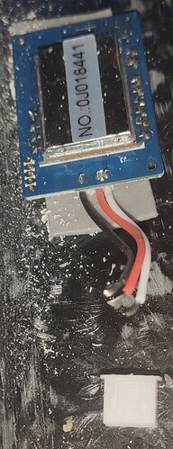

Connector to the hoyt reciever to plug right in to stormcore without adapter. But what connector is this, ad how do i attach a new one?
Impossible to tell from the photo. You need to measure the center-to-center pitch between the pins, then consult this chart: JST connector - Wikipedia
Or you could check the stormcore documentation, it might tell you what connector it is there as well.
Once you know what the connector is, then you can buy a premade pigtail (wires with crimped terminals already installed in the housing), or a pre-crimped kit (wires w/terminals, and a bunch of empty housings you can install them into), or you can buy a crimper and some terminals and housings, and crimp your own.
You will either need a soldering iron and the skills to use it, or a crimping tool and the skill to use that.
Out of curiosity do you have any suggestion for which is the better noob option? My instinct is definitely soldering but that’s probably because I can do that fairly well and have very limited experience crimping
