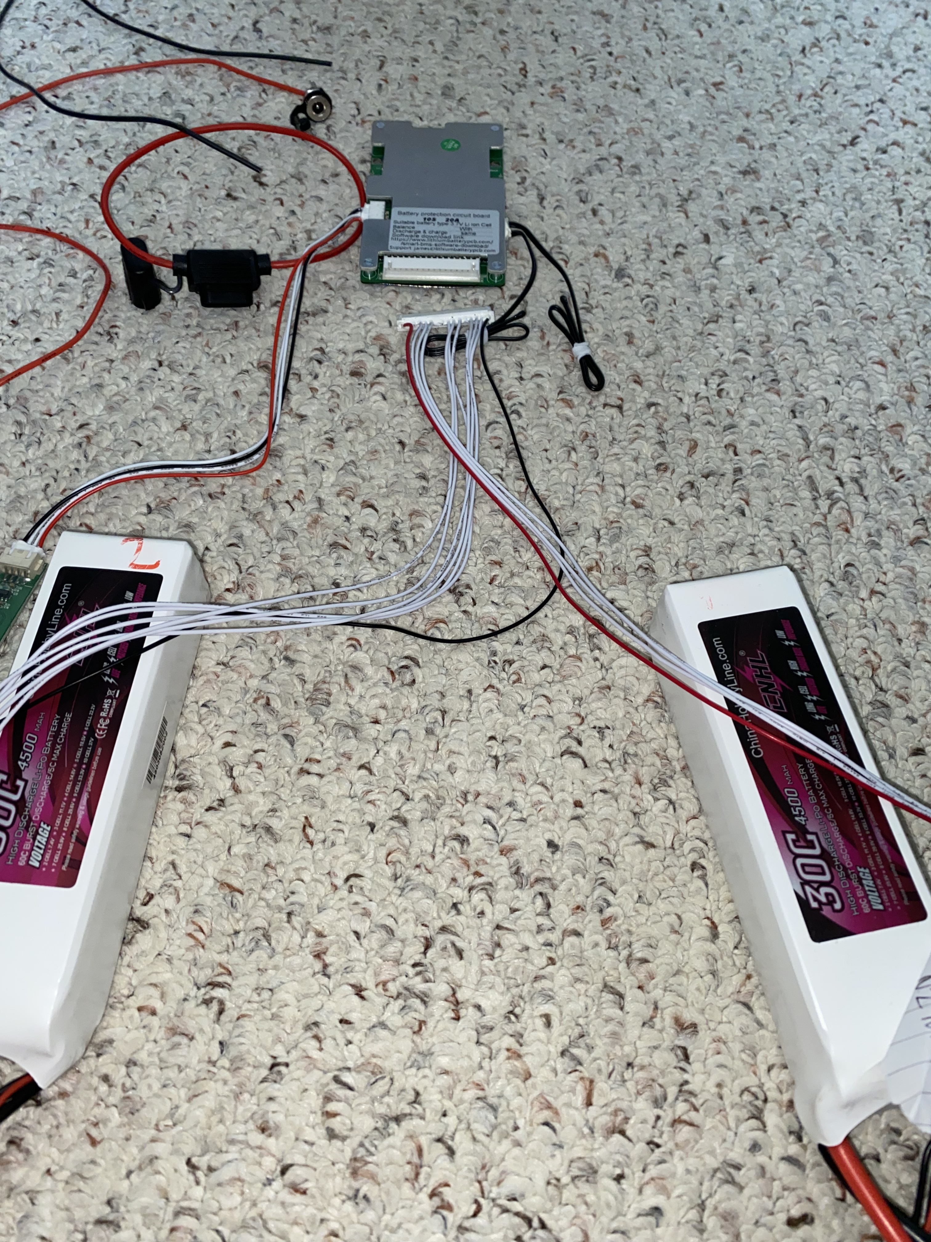

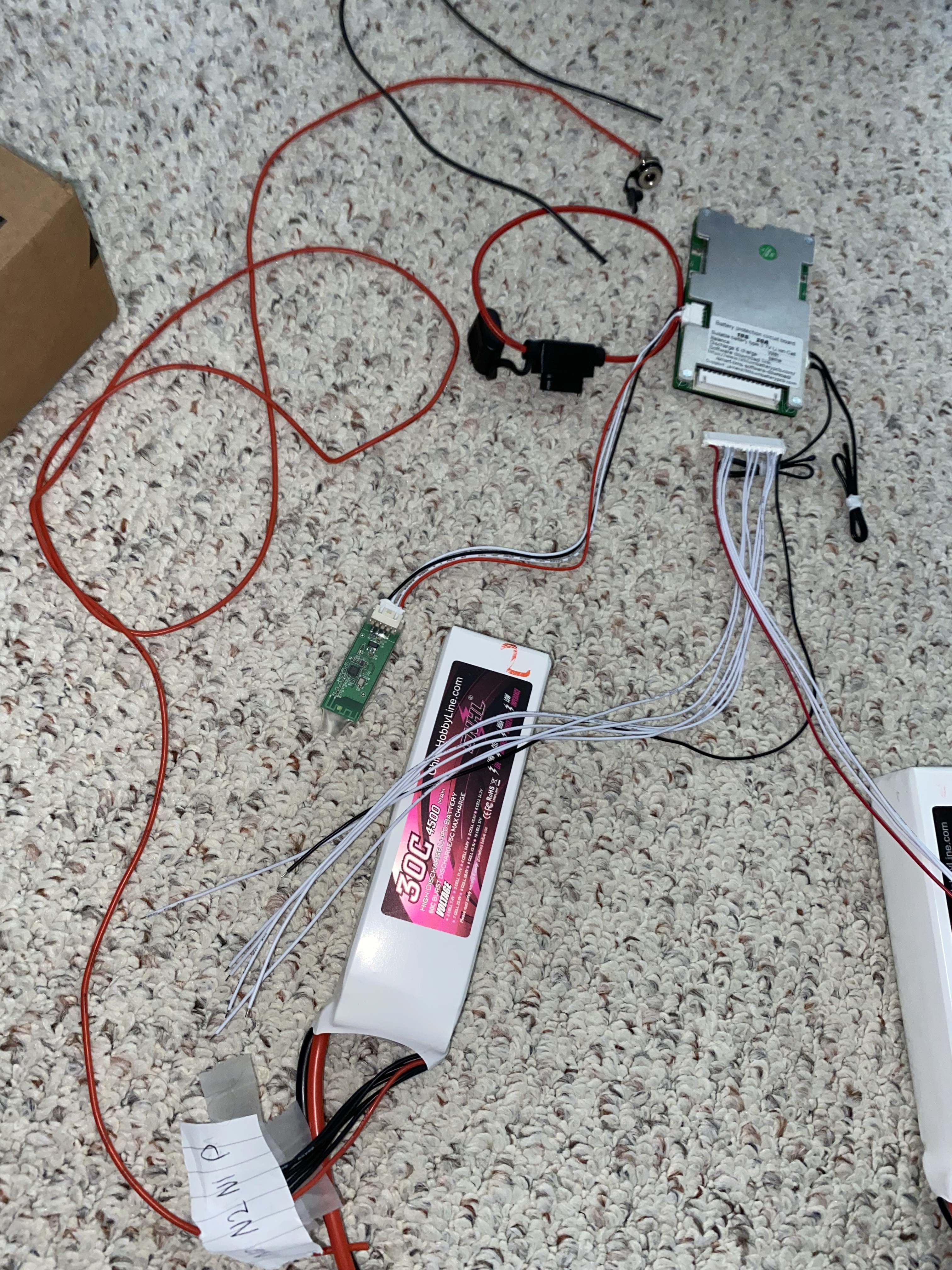

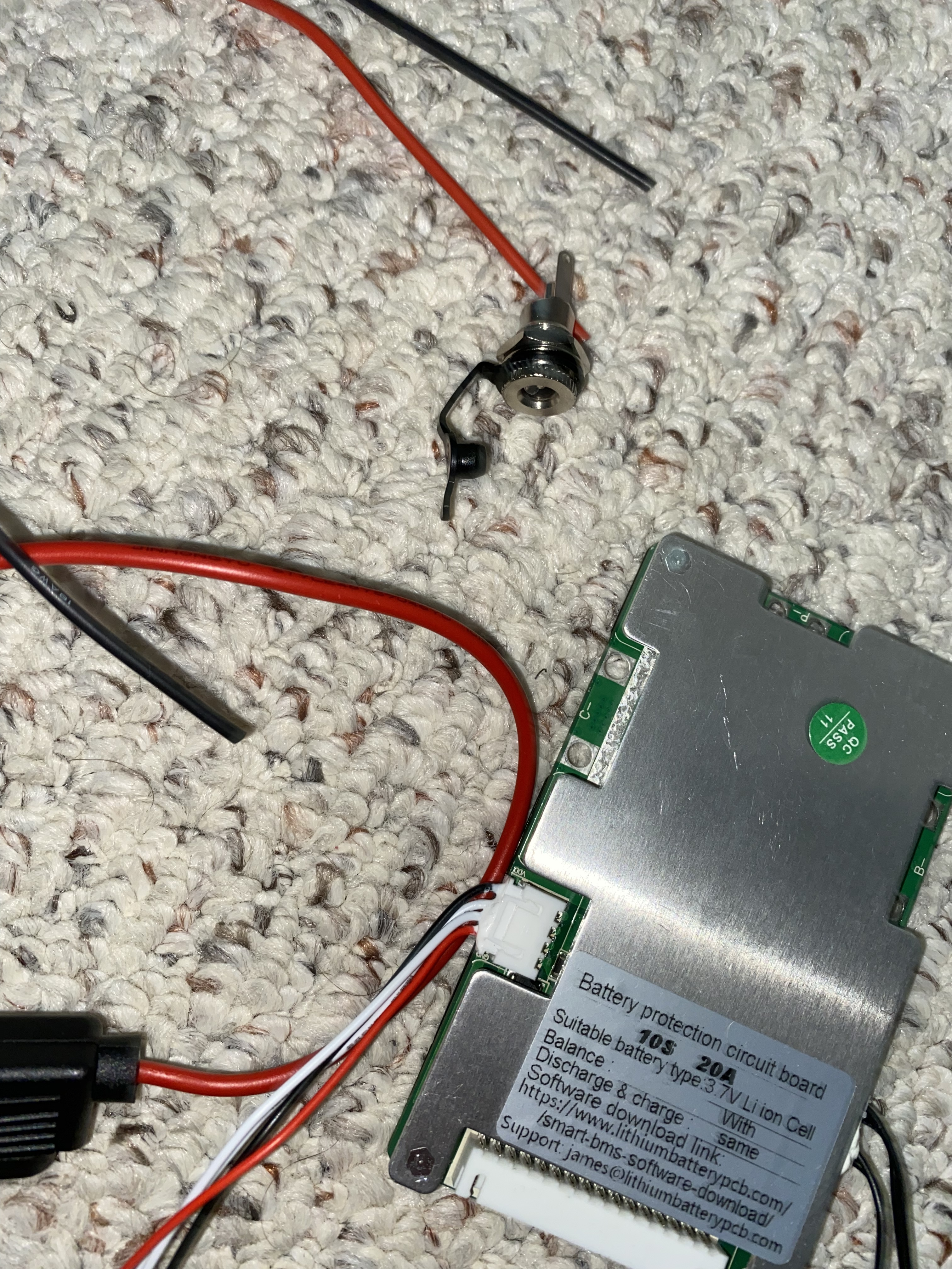

Alright. Today’s the big day where I solder the BMS, I got everything lined up and ready to go. Just making sure everything is in the correct place, does everything look right? Also should I add bullet connectors to where the charge port goes so I can disconnect it or reconnect it whenever? (Got photos having it lined up, don’t have my harness in the house currently)
