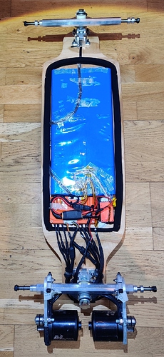

I used neoprene and under long time pressure it loses all the spongy feeling.
My 3mm thick neoprene sealant is now printer paper thin.
Definetly go rubber

Anyone know where to get 10mm speed rings ?

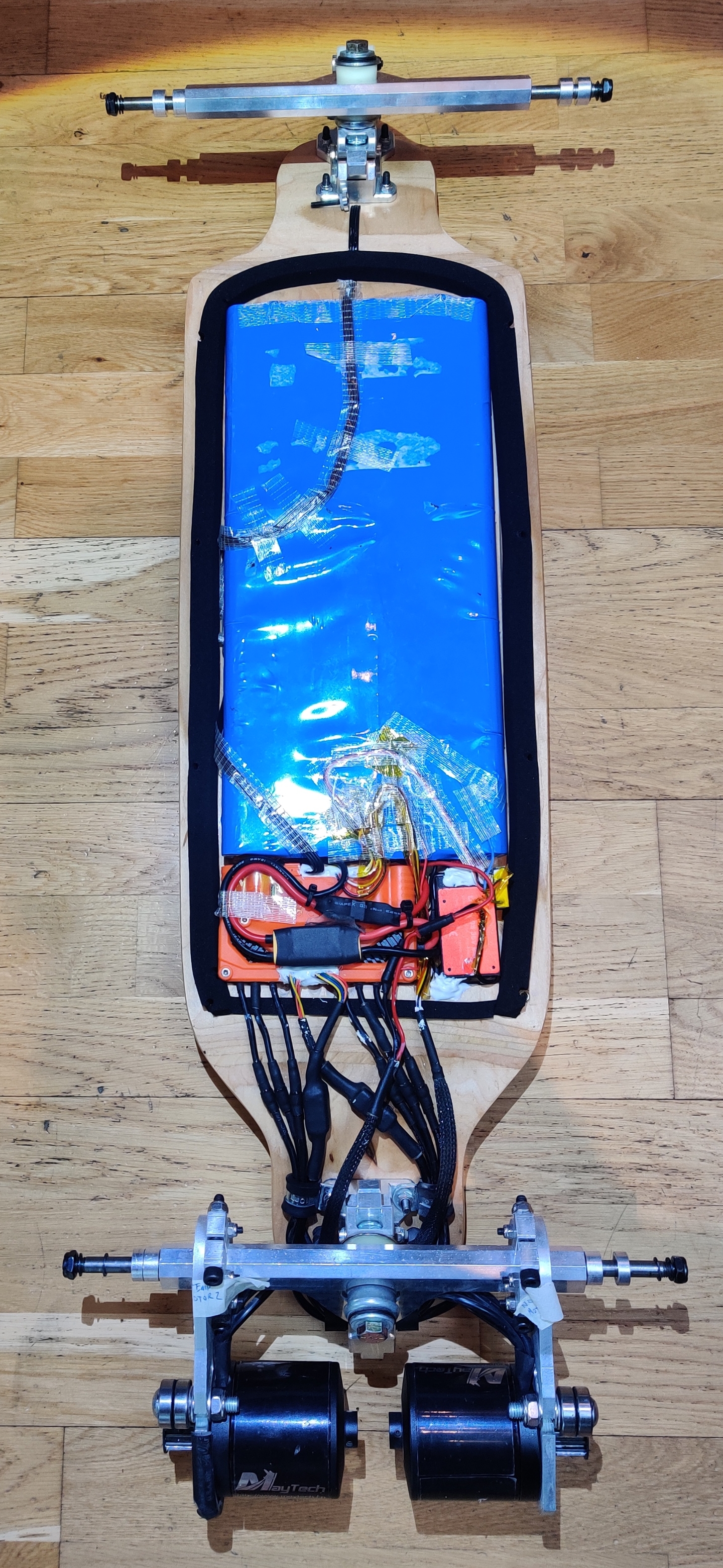

I have ordered both of those from rubberstuff. The first one is heavy, does not bend and does not have adhesive, I would not use it as a gasket. The second variant from rubberstuff seems good as a thick gasket. I ordered 12mm thick and compressed it to about 9 - 10mm.
Thanks for the tip, though perhaps 3M VHB underneath would keep it pretty firmly in place along with the screws squeezing it down? but perhaps you already tried something like that? I’ve not ordered yet, but their delivery costs are so high, like £20 for an £18 product. I may try and call them to see what’s up with that.
That’s true, you could apply the adhesive :+1: I never tried because of the weight. Rubberstuff also sell on Amazon, might be worth comparing shipping costs.
Ah great, I’ll check their amazon site, hopefully that delivery cost is near enough non-existent on Amazon, sometimes it is…
Amazon is usually like, let’s say £10 with prime shipping, and when you go on ebay it’s £5 with £4 shipping lol.
Obviously not those specific rubber gaskets
