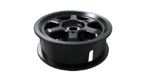

Why are Infinity Hubs so incredibly expensive? $1,000 a set!
Infinity hubs? Like, the 3D servisas finality ones? Or are you talking about something else
I’m pretty sure it’s 250 for four, anshul just did a bad job making that clear on the webpage
Ahhh. Are they actually available? It says pre-order.
nope, i don’t think Anshul’s got them in hand yet from the factory
