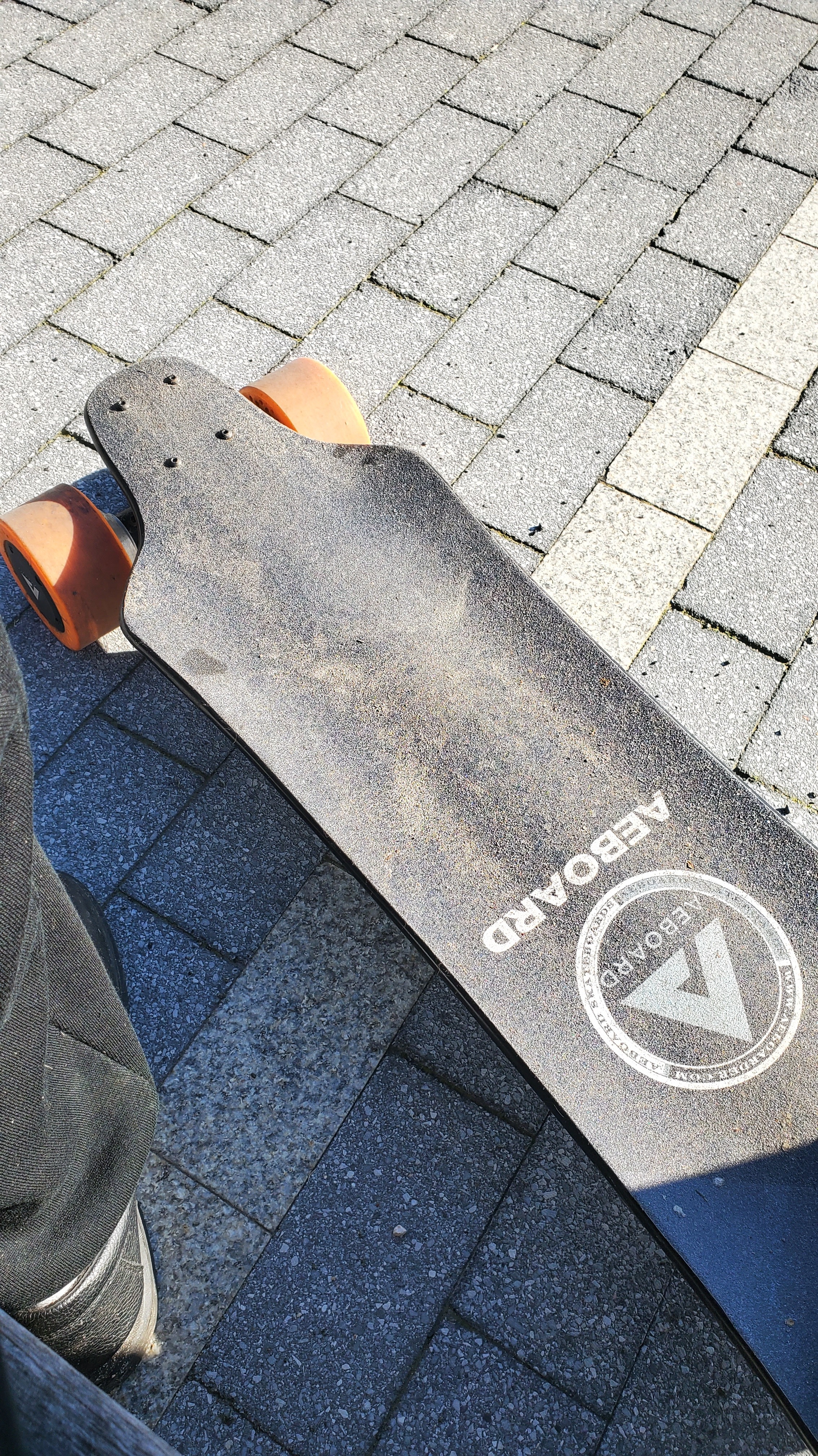

That’s so weird. Have you tried a different remote at all
Issues like these are why we still don’t trust the unity that much haha
checked receiver?
potentiometer remote, vx2 is hall sensor, not sure about vx3
i only have the murderous nano remote (not nano x). The nano is the remote ich broke my arm with, i wouldn’t use it anymore as it took a lot of damage.
Else i only have the mini remote. Might give that a shot.
a while back yes. Connectors are glued so don’t suppose anything wrong with it.
Depending on what Ben sends me as spare parts i can swap the Pot.
An aerosol can of contact cleaner or a squeeze bottle of isopropyl alcohol would help with dislodging crap from a scratchy potentiometers (in audio systems it makes horrible noises and I can’t think of a better way to describe it), or if you can get a toothbrush near the track to clean it off that’s even better
pad up if u do try another remote, if vx1 and receiver were all good, then the unity is a bit sus
but this doesn’t asnwer why it’s getting fixed after a restart of the board.
Also potentially basic troubleshooting you’ve covered already: have you tried just wiping the unity and starting over on 5.x or whatever firmware you’re on? I know you know what you’re doing but there’s an off chance there was a glitched terminal command or something stupid like that that might mess with an acceleration curve
This kind of problems suck ass, you should be looking into buying precise telemetry for your board, it may help you resolve the issue.
I’m with everyone on the issue and feel that it’s probably the remote, but you never know, you can do a bunch of bench testing with your computer
Yeah fair but I’m always extra skeptical of the part of any machine that has to interact with a disgusting fleshy human, and it could possibly be just a coincidence or some other cause that it stops after you stop and get off and mess around with the board for a minute
i had the part recorded on my metr yesterday but deleted the log since it only was a few seconds long before restarting the board. Wish i’d kept it.
I’ll try to provoke the issue next time i ride
agreed. Disgusting humans, eugh.
