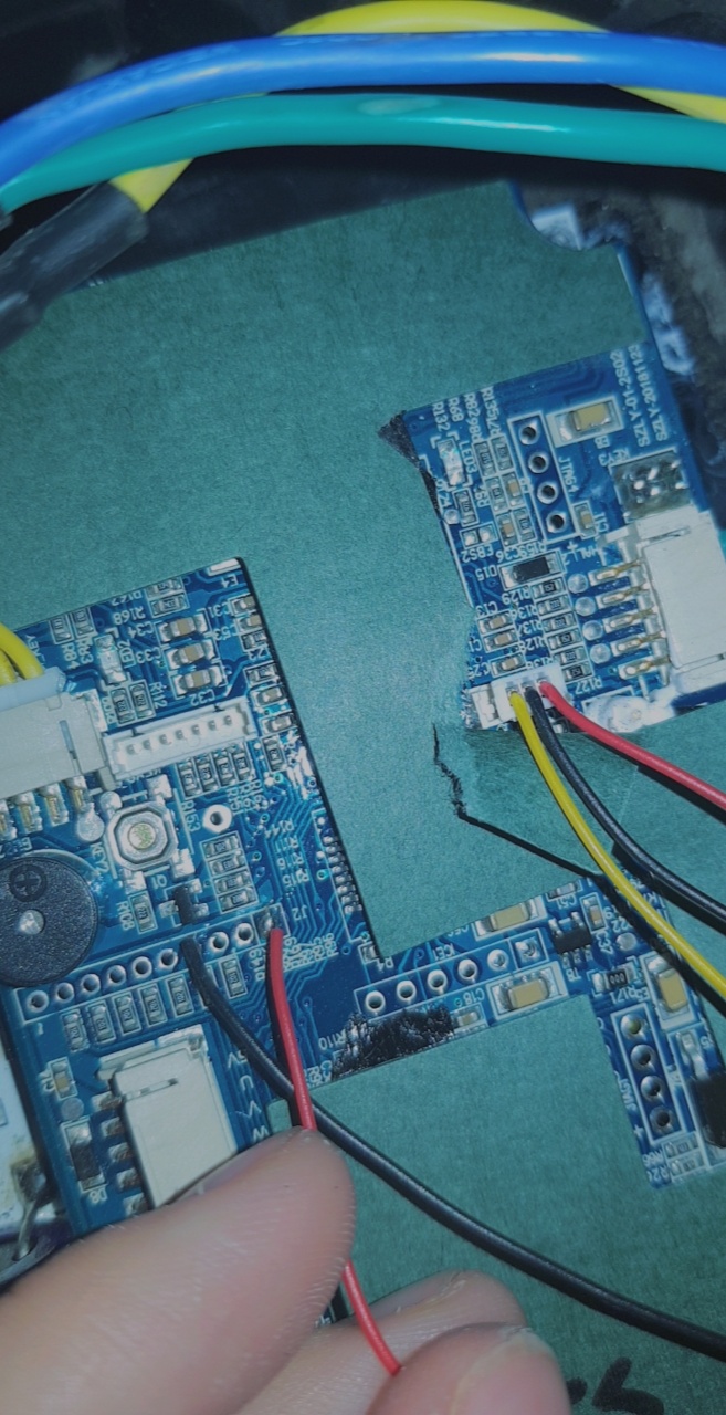

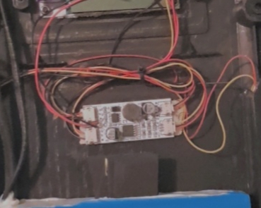

if i wanted to power a light how would i go about connecting it to the battery and then connecting it to a second power button?
previous esc had a black and red wire straight on the esc, is that possible on fsesc?
its already converted for the battery voltage
20210622_020046
How powerful is the light? The simplest safe way is
  1. Work out how much current the lights need
  2. Get two appropriately sized wires (don’t use bigger than 18AWG unless you need it, it’ll just make things worse if there’s a fault)
  3. Add a fuse. Use one of those inline fuse holders and an automotive blade fuse if it can handle your current (it probably can), or solder a fuse directly in the line. Probably put it on the positive line
  4. Add a switch that can definitely handle the current you need (should be easy enough) also on the positive line
  5. Terminate in either an XT30, or JST connector if it’s very small
From here it’s a bit more messy. Is it a 12V light? Does it have a switching converter in built that can run off battery voltage? If it can run from the battery I’d just add an XT30/JST connector in parallel to the ESC input
Most cheap toggle switches can’t handle upwards of 5A, relays for high current/voltage are king here, your switch just has to supply current to the coil (generally under 100mAh) instead of the load (Many amperes).
