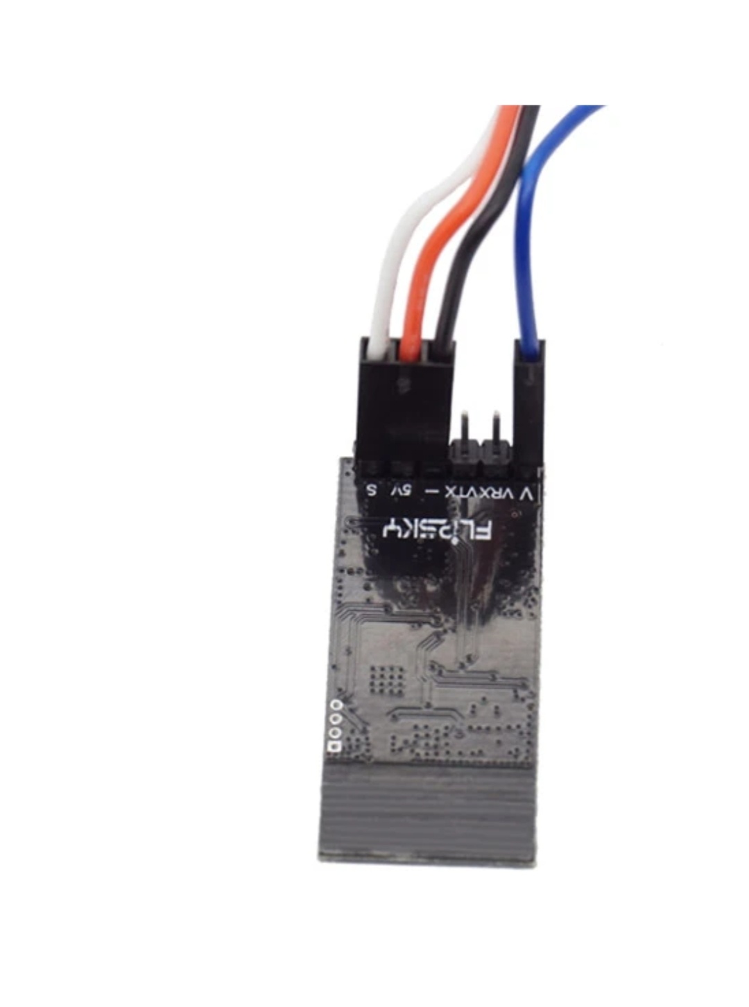

Here’s a noob question. The mini FSESC4.20 (flipsky VESC), has a receiver cable ‘built-in’. I need a remote (obviously) and have been looking at Flipsky’s VX1 and that one comes with a receiver. I looked at the diagram, however, and saw that the receiver cable is not connected by that receiver cable on VESC, but instead by a ‘custom made’ receiver cable. My question is what is the receiver cable on the VESC for and what is the easiest way to pair a remote with that controller? If you have guides for this, you can suggest those :slight_smile:
Thanks

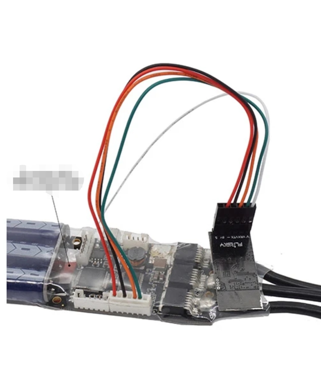

The custom cable you are referring to is probably the UART cable (wide black connector)
You can use either that one (plug it into the UART port and be done) OR use the built in PWM (PPM) cable instead. You just have to use the correct pins.
(pics incoming)
This is with UART
and this with your built in cable. (colors may vary) You can ignore the blue one. That just gives the remote a voltage reading of your battery which you can view on the 4 LEDS.

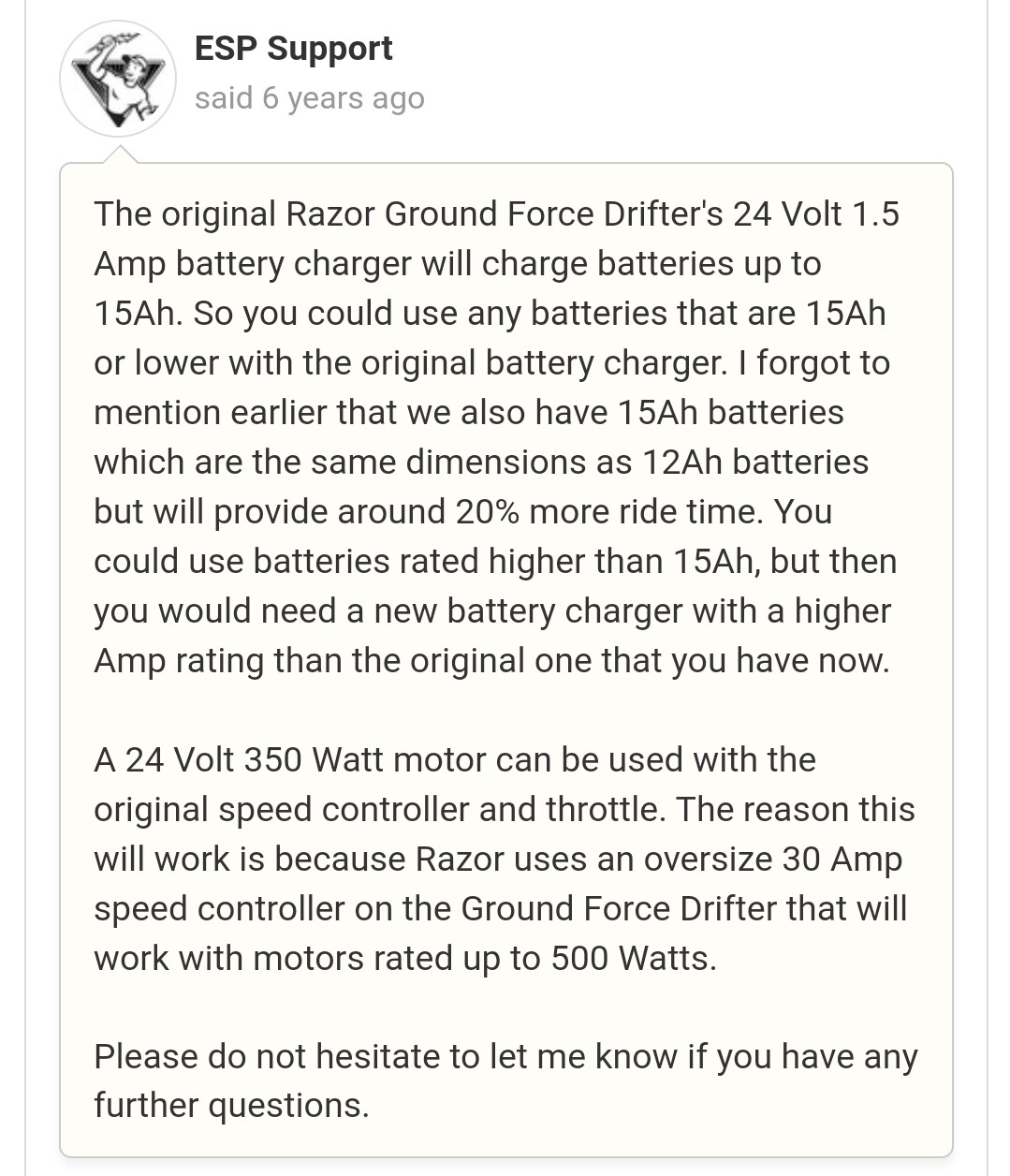

@Battery_Mooch got an SLA battery question for you if you happen to know.
I saw this bit of info posted from a long time ago about maximum battery size with respect to charger amperage:
Is there some 10x charge rate rule I didn’t know about? If so, does that apply to our normal li ion packs or lipos?
I feel like that’s only for customer service reasons and not technical constraints.
For example, to prevent “My battery is taking too long to charge” complaints.
I normally would too but I’ve talked with him a lot and he’s a super helpful and knowledgeable guy which is why I was extra surprised hearing that specific of a claim.
