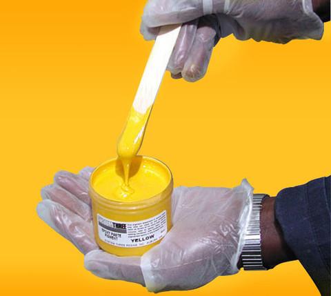

No direct experience, but here’s some info from the big brands:
“Adding pigment to epoxy should, like everything in life, be done in moderation. Without exception, adding pigment to WEST SYSTEM Epoxy will weaken the cured mixture to some degree. Because of this, we suggest you use very small amounts of pigment, about 5% by weight. As a result, thin films of colored epoxy are somewhat transparent. It usually requires several coats to make the film opaque.”
" Our Epoxy Paste Pigments are pure, dry, colored, pigments dispersed in in an epoxy resin blend. They are pourable, easily measured, and contain no solvents, and may be blended with one another to produce additional colors. Since they are dispersed in an epoxy resin blend, they react into the system and do not change its cured properties. The proper way to use these pigments is to add them to the resin (Part A) side and then add the hardener(Part B) at the correct ratio for the epoxy system being used."
I have used System Three’s paste pigment, but it wasn’t structural.
Hmm I guess I can always just use un-pigmented epoxy then add a an additional layer of pigmented epoxy if I really want…unless I get some more paint…
Thanks for the input :slight_smile:
It should be fine as long as you follow manufacturers recommendations. West System suggest 5% max I think. Have done it a bit without any issues.
