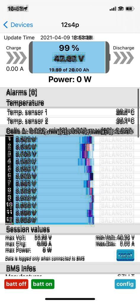

i made an overlay of 27/73 bms readings while accelerating… while it seems group 4 is the worst, isn’t it weird so many other groups sag that hard aswell ?
what could this indicate ?
That’s actually kinda cool, how did you do that? Screen record, take screenshots, and then turn opacity to like 50 or something?
I would think maybe you’ve got a couple bad cell connections maybe, hard to say without seeing the pack itself
almost, i did screenshots on my phone and imported them as layers into gimp, there change the layer mode to “difference”… if you end up with uneven amount of layers the image colors will be inverted tho - which is fixed by inverting or creating a new layer from visible…
the pack is actually made from nese modules, and i made sure all the tabs are screwed in tightly with thread-locker :man_shrugging:
and i have not found any reports of loose compression pads with nese, so im really baffled as what to do - i will tripple check the connections for now i guess
the cells themselves are from fogstar, so i would assume they are of good quality
