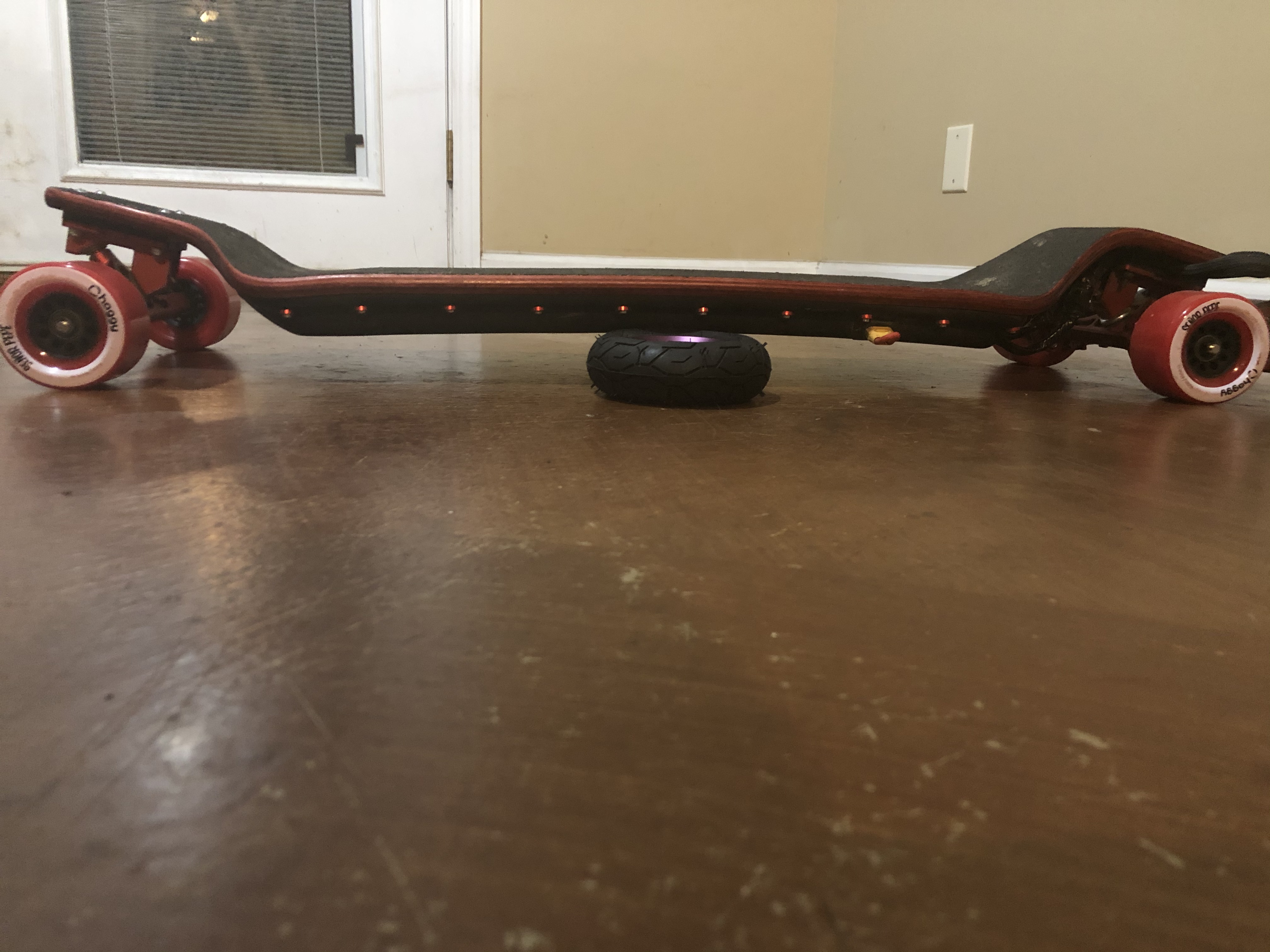

I’ve got a set here I’ve been eyeing. Is the drop too
Much on the century?
Ouuuu das wat I ask of u… did ya try a quik quik Mount n clearance checker??
Cuz… be a shame do da work and board don’t move.
I am curious jus as mucho as you

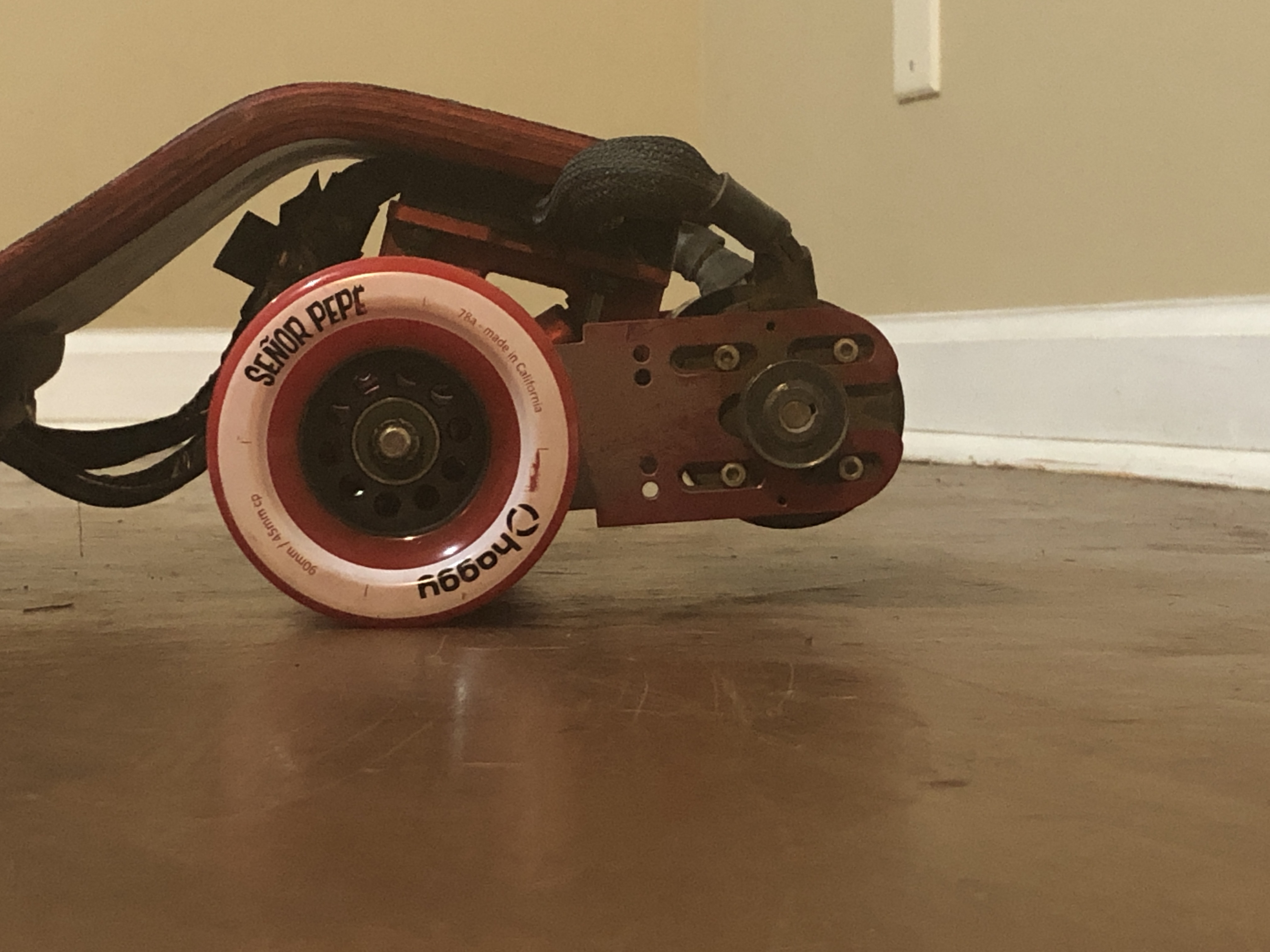

They’re for my other build but been getting bored with the century. Wanting to spice it up some, so figured thane might be exciting at fast speeds. Lol
Edit: fuck it. Give me a minute.
Ouuuuweee trusttameeee… thane + speed = zoOm zooM. I kno…
Thas why I curious 2.
Gonna be close if the road is shit.
Ooooo das not as bad as I picture in the brain…
How be your roads??
Butttt 72A 110s n you gonna go real zoom zoom alll grip in da world…
Just don’t take any gravel roads on the 72A
not that any sane person would consider taking a gravel road on polyurethane longboard wheels
There are some places it would work. I can even stand on this damn thing on concrete. Lol. Going to bust my ass before even putting power to it.

Let me know if you end up cruising these! Would love to see this compared to the 110s for clearance purposes
