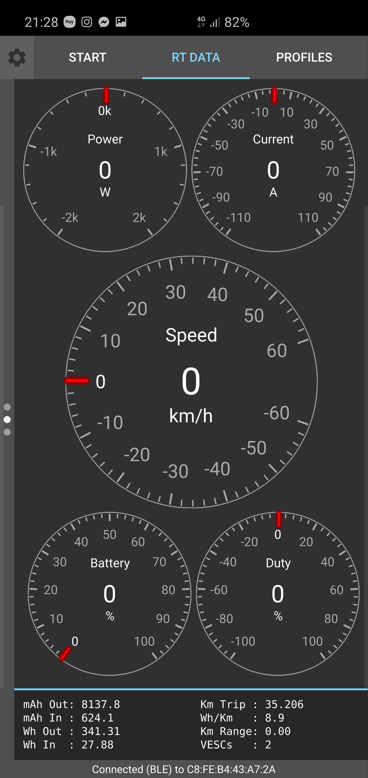

Soo… it seems like dropping battery max from 28 to 25 amps (56 to 50) and lowering cutoff end to 33v got me 700mAh back from my battery capacity.
Got home at 36.00v, as my battery sags quite a lot due to my choice of battery clips
Moral of the story: 30q at over 15A discharge = big losses in capacity
what was your Wh/Km prior to your changes?
Exactly the same. It averages out perfectly on this route i take to the furthest park my battery can reach.
Morning commute was 13wh/km, flat out 40-50km/hr for 7km straight
Note: 8.9wh/km is 14.2wh/mile
13wh/km is 20.8wh/mile

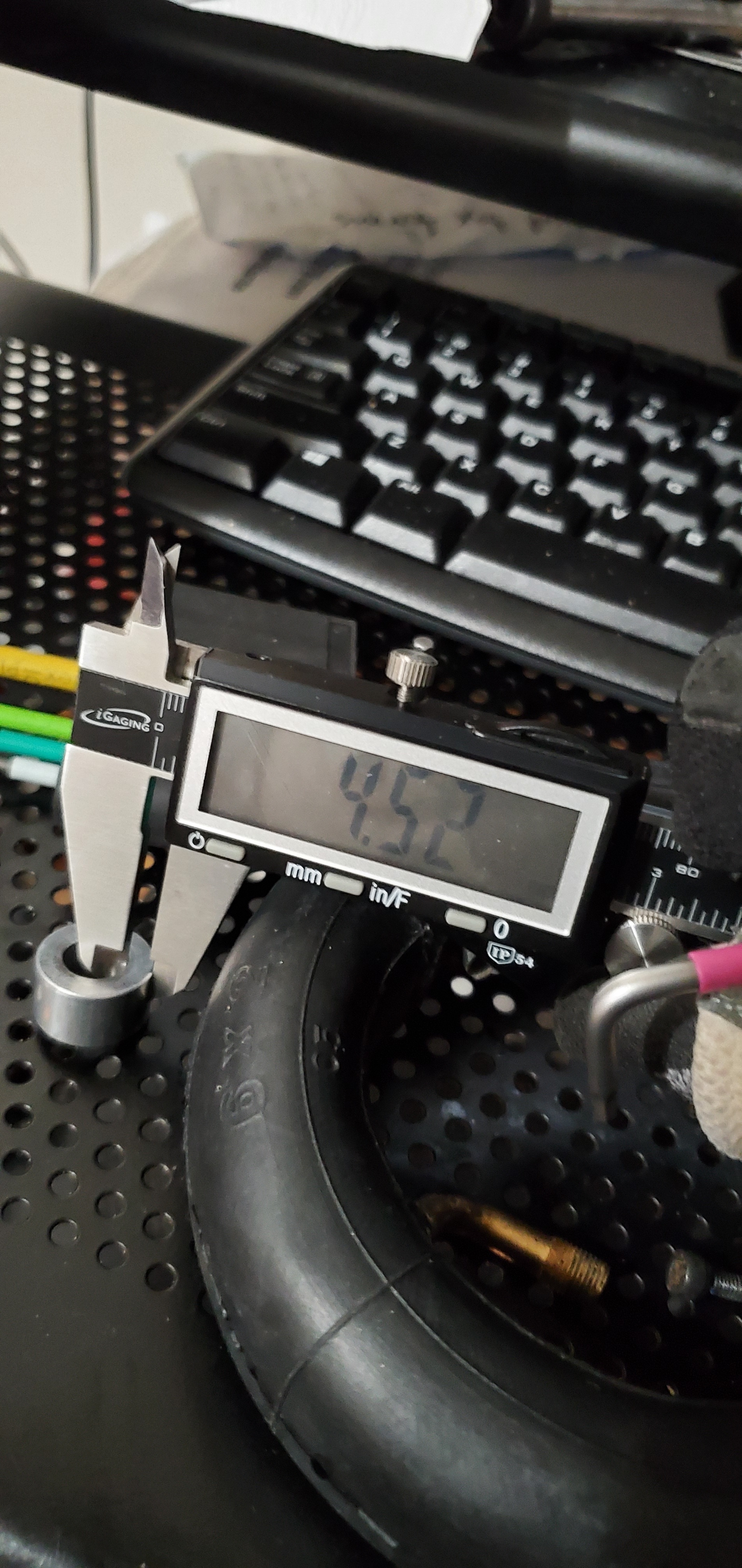

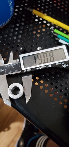

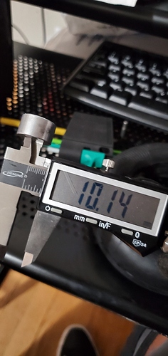

where can I find a spacer like this for sixshooters. I noticed that the wheels that spin with less resistance has spacers like this in them. My other wheels the spacers are different lots if resistance.
maybe here…
So really nobody used @torqueboards 50xx motor mounts and could tell me the length of the belts needed for 36/15T gearing???
Does anyone here run a vesc with sensorless hub motors? If yes hows the startup? I would run HFI but unfortunately the vesc I want to run doesn’t support newer firmware versions. (It’s a @esk8supply vesc)
I still don’t buy that story. Has anyone tried?
The one dimension you need is the one you didn’t picture: the height of the cylinder.
Spacers that are too short allow you to put excessive axial load on the bearings.
Spacers that are too tall leave room for the wheels and bearings to shift relative to each other.
A spacer that is just right will allow a slight preload of the bearings, but not excessive. You’d have to measure the space between the bearing seats of your wheels to know exactly what spacer is ideal.
