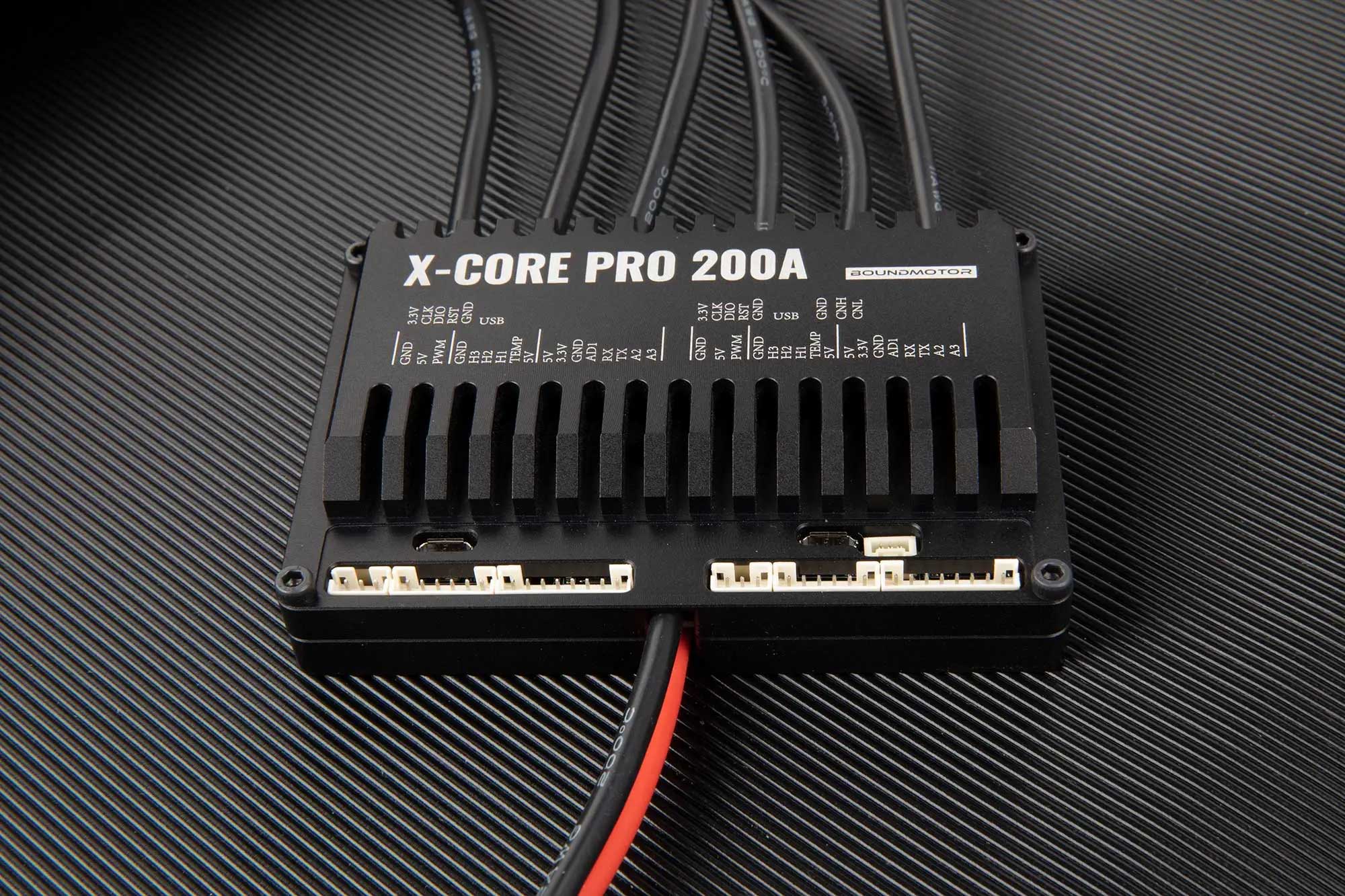

Why? Did they change the firmware to make it work? What is the exact problem?
No it’s standard vesc firmware. v3.65 I believe but all sellers of this esc seem to say reverse and battery indicator function will be lost if you update the firmware. I’m not sure why that is though.
@Esk8supply why is that?

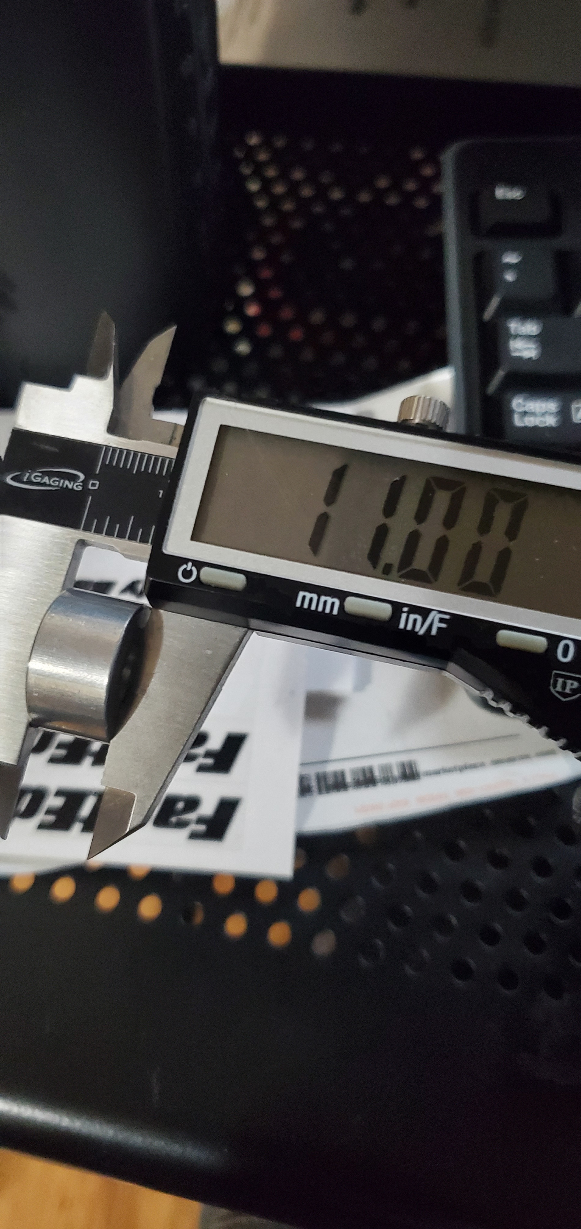

I’d just make a stack of speed washers until it’s 11mm thick :rofl:
I knew those speed rings I ordered would come in handy :grin:
Yeah it’s a pretty old firmware version. I’m just really confused as to how a voltage reading being forwarded to a remote can be affected by the vesc firmware version. I’m hoping @esk8supply can explain.
Just for context I want to run a loaded/ ride unlimited hub motor which doesn’t have sensors.
Actually I think it’s v3.65

Which remote / Esc is this? @Esk8supply seems to have a couple? are there docs for how the remote gets it’s voltage reading?
That’s all the info I have on it.
hmm. some kind of integrated receiver. my guess would be they have a forked version of the firmware to work with it? but also claims to be ppm type.

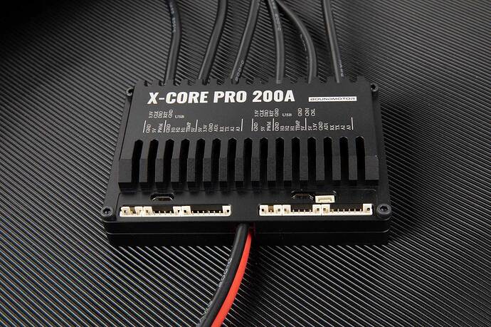

Found this at bound motor:
“Please do not upgrade the firmware, this version compatible with FW 3.65 only(VESC TOOL V1.29), otherwise, some functionality will be lost, such as speed mode switching and front-back direction switching.”
It sounds like they are using modified firmware. If this is the case, it’s an easy fix. Just port their change into the new version.
@Esk8supply Where is the firmware source code that ships on the ESC?
