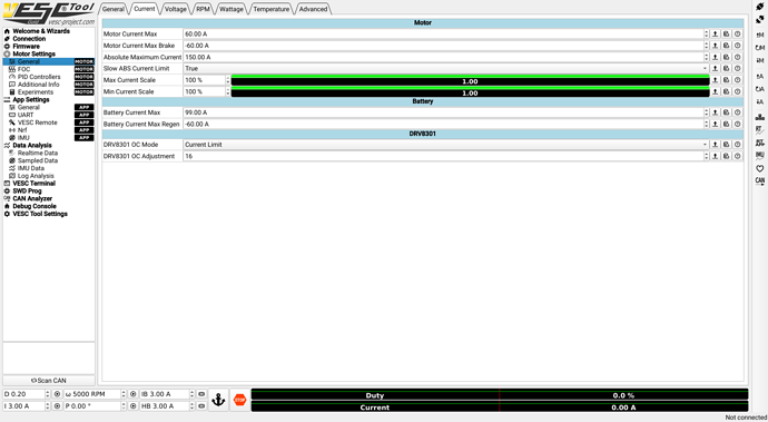

ok I took my bored out again it it throttles at 22a on the mototrs at cut off 105c, so at this point givin how hot the temps are with a lower power I think its safe to say the only thing thats gonna solve my issue is setting my cut off to 140 as its the only reported resolve and honeslly since they inevitably run hot gonna ron em at 27a on both
givin that might someone advise me the instuctions to do so and not a bash on my craptor 2 because i am awear of the situation xD
… oh and ill be back when i need buy a net set of motors so i can cause more teriany on the sk8 community via death of a miillion questions
and i dont wanna go the route of cutting that wire because at least my motor will off be for it compleaty sets on fire
Motor amps or battery amps? These tiny details are mega-important and I can’t fathom how to help you without knowing that.
Show a screenshot of this screen if you want us to be able to help.
motor sorry i just assumed thats what u guys figured
