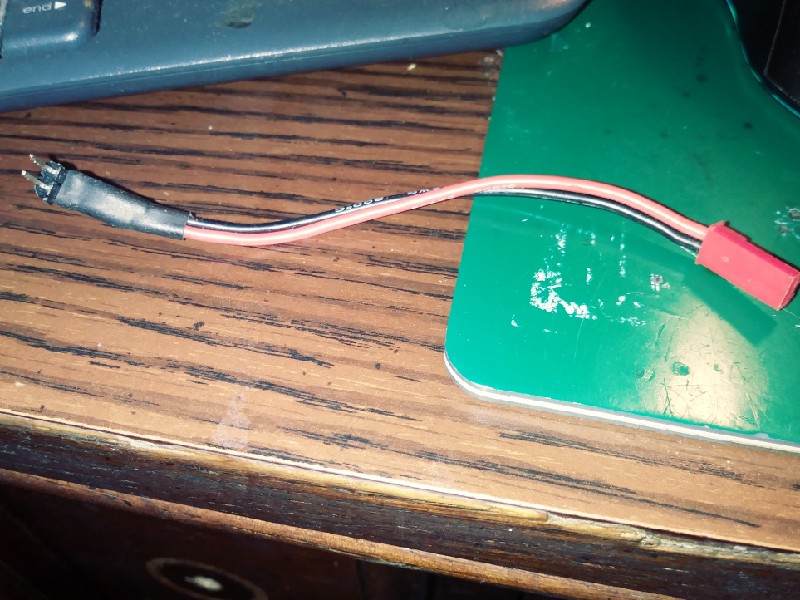

This is the adapter I made out of dupont pins and a 1s plug
EDIT… I see @b264 lurking… YUP I should have fused this at like 2amps…
as @kook said, be extremely careful doing that
Don’t accidentally short the pins out
You could put a resister in series to charge even slower than 1 amp if you want
maybe 10K to charge ultra ultra slow or smaller to charge faster

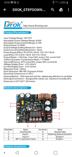

This is the stepdown supply’s product parameters so it looks like I can use it to charge at < 1 amp without the need for a resistor correct?
Yep, correct
